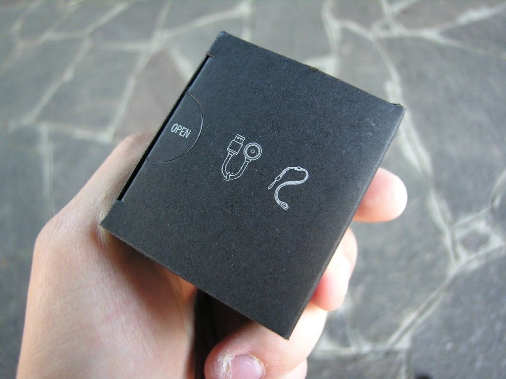

    The S2R comes in this modern looking box
    Like the S1A and S1R, the packaging was also designed by a tetris master.

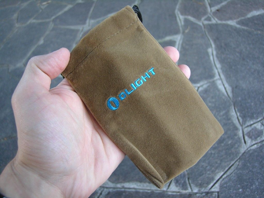

    Inside you have the S2R, the manual, an Olight embroided pouch, USB rechargeable base and lanyard.
