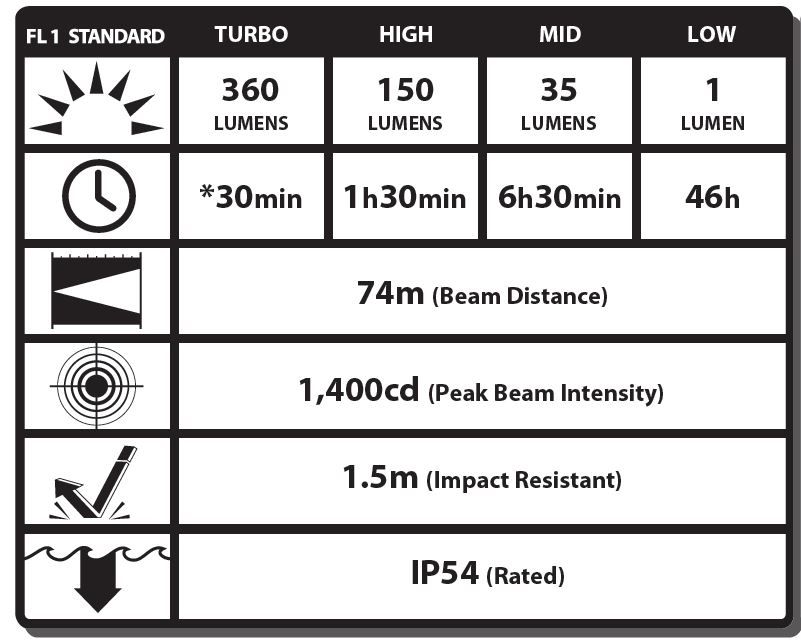

    And the output specs:

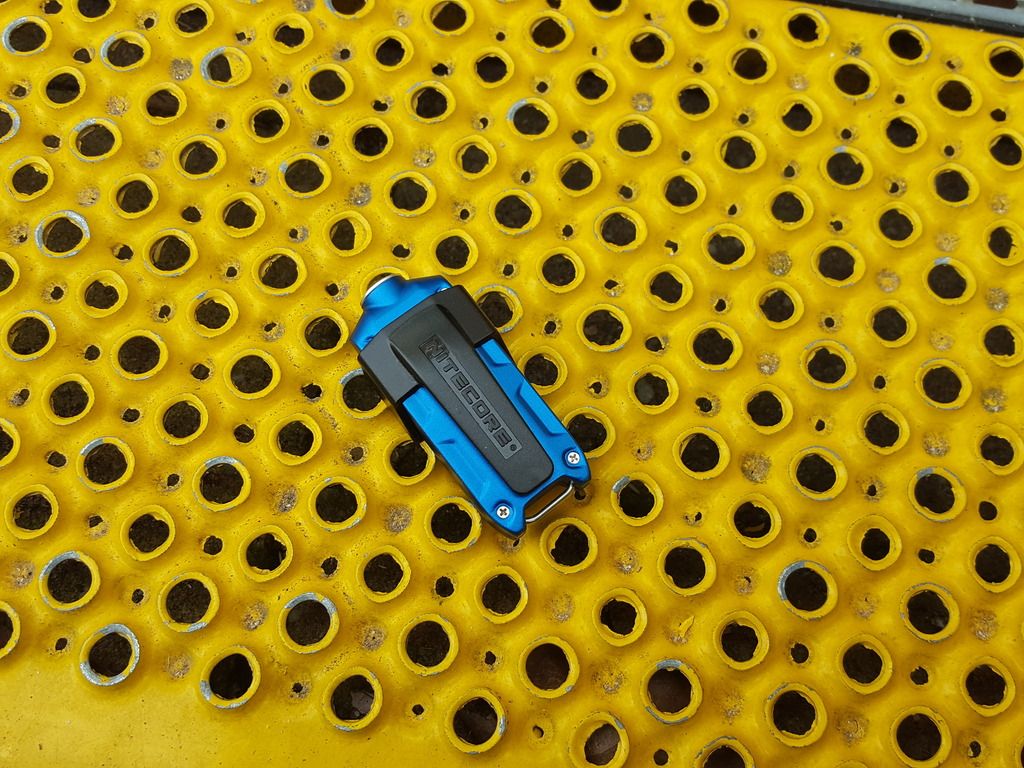

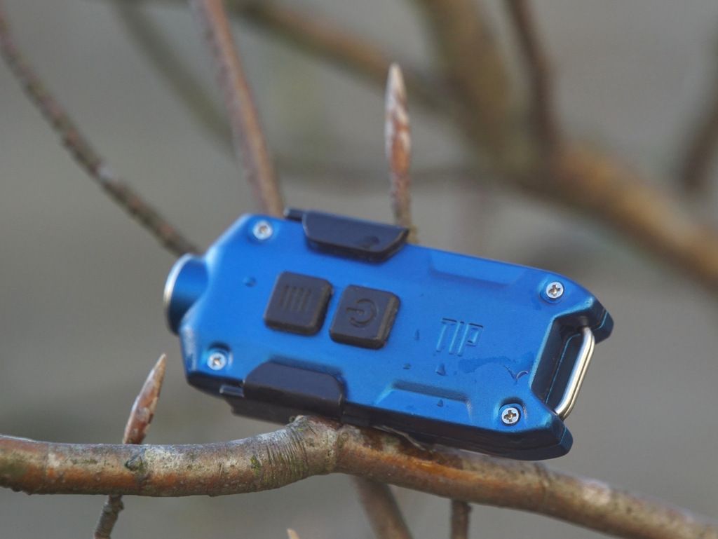

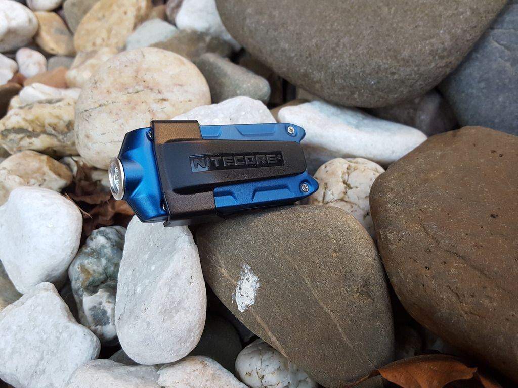

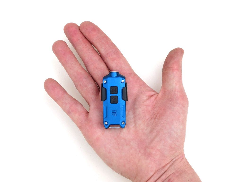

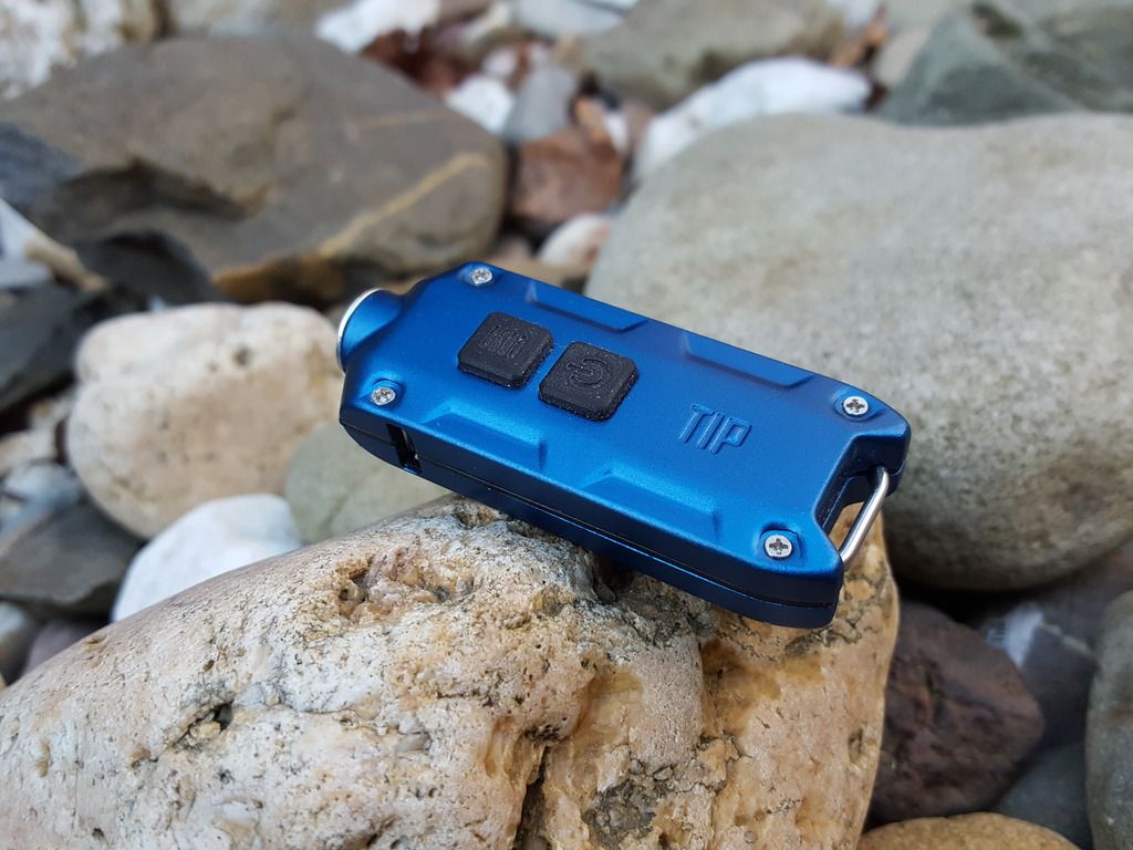

    First impression: tiny and feather-light! It’s unbelievable that a light with this options and output only weighs only 23,5 grams! This aluminum light comes in seven different colors, so you can choose the one that fits best for you. The TIP 2017 has its own looks and shape, but it has an thought-out design. It has some nice accents too, like for example the silver ring around the lens. The used materials are of good quality, but the finishing at my sample could be little better. I detected some imperfections next to the seams, the rear suspension ring had some slack. There no engraving on this light, only a couple of symbols, the brand and the models’ name are “casted” in the aluminum body. Handy feature is that the TIP 2017 stands stable in all positions. On the upside of the TIP we see the two buttons, that have equal shape, only different symbols. The micro-USB port (without rubber cover) is on the side. The unprotected port is one of the main things that Nitecore has fixed at the 2017-version: the new clip covers the port and protects it against damage. Nice fact is that the clip can be added in four ways; adding and removing is an easy job; the clip will fix itself in the notches on the body. The clip is also needed to prevent the TIP 2017 against accidentally turning on. Looking into the lens we see a textured reflector without defects, but the XP-G2 S3 LED was off-center at my sample. Hope this will be better at the stock-version. All-in-all I can say that the overall quality and finishing of the TIP 2017 is okay; I kept in mind here that had my hands to a sample. Scroll down for a couple of pictures that show more impressions and details of the TIP2017!

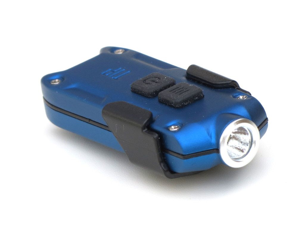

    the “updated” version of the popular Nitecore TIP
    the TIP 2017
    stands stable in any position

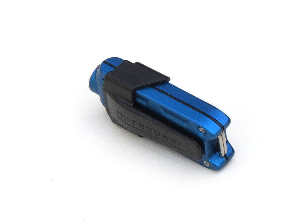

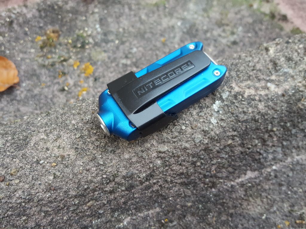

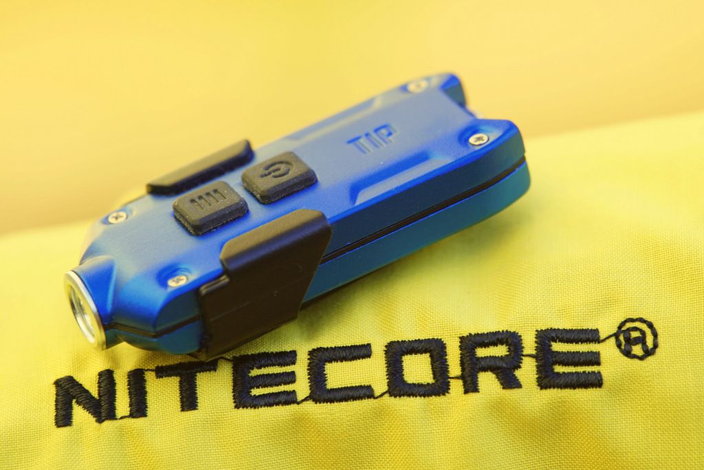

    the new clip is the most striking detail
    feather-light and so tiny!
    at close we see some imperfections around the seams
    the suspension ring can withstand 30 kilograms!

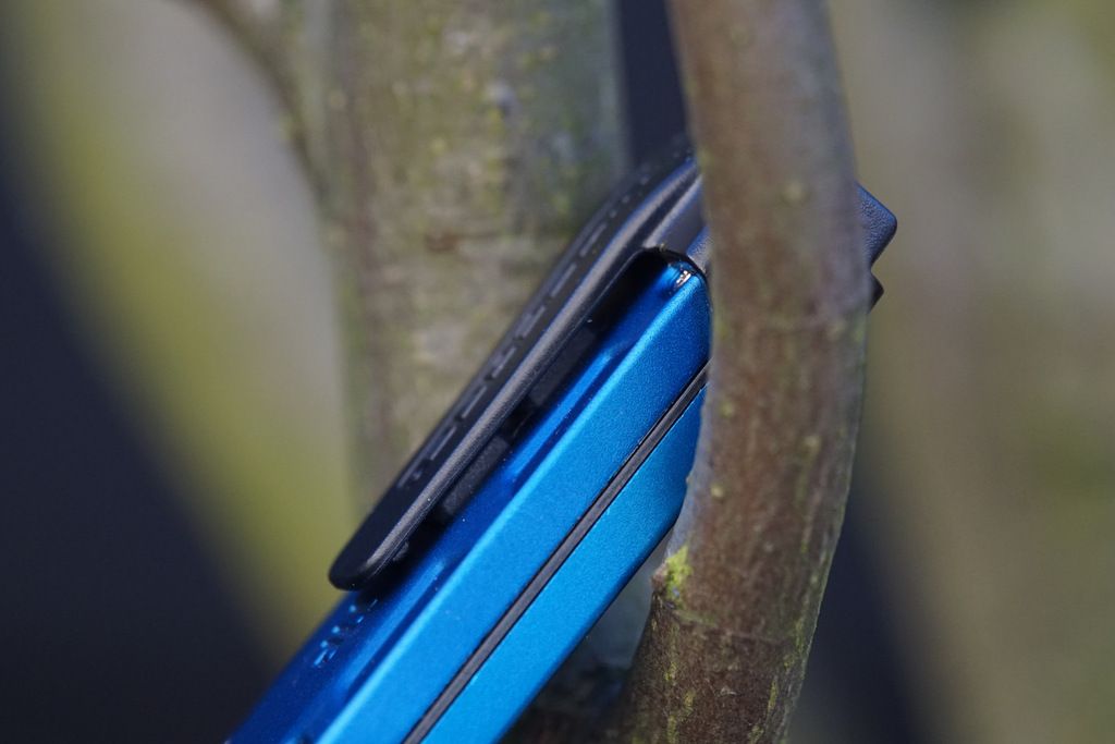

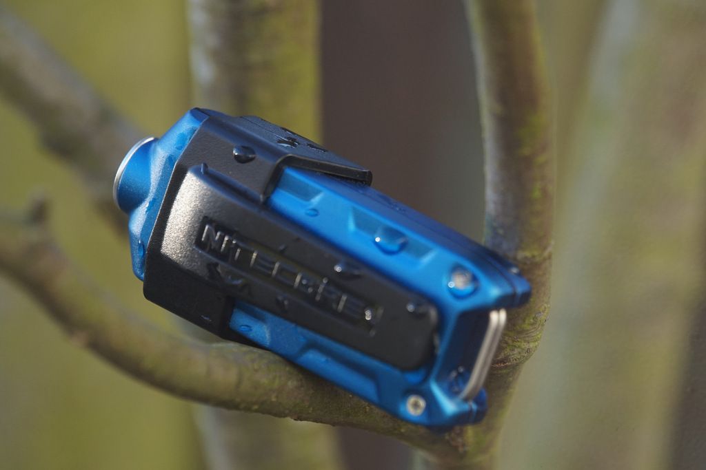

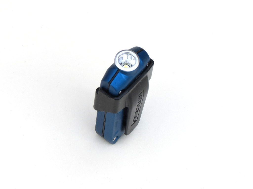

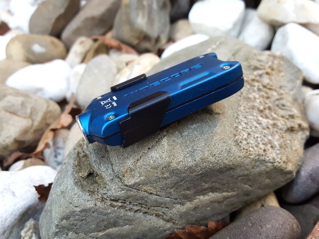

    main task of the clip is to protect the micro-USB port

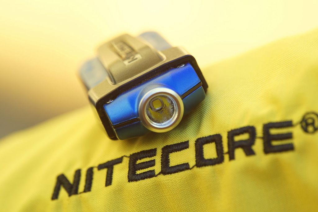

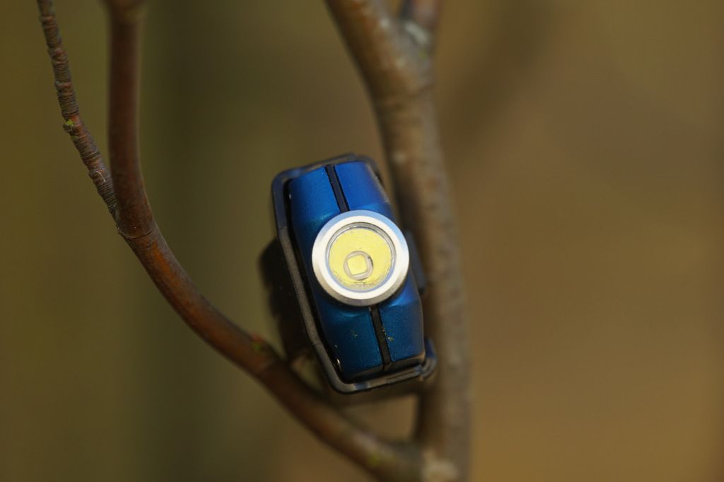

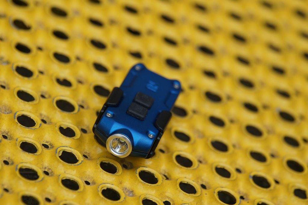

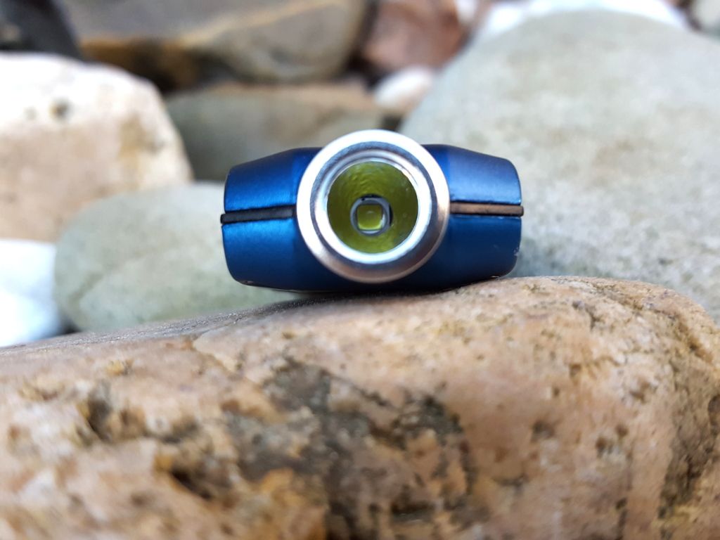

    orange-peel reflector for a smooth beam
    water resistant to IP54 standard

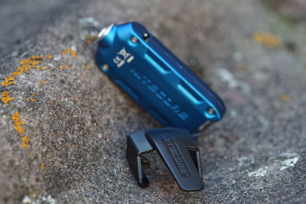

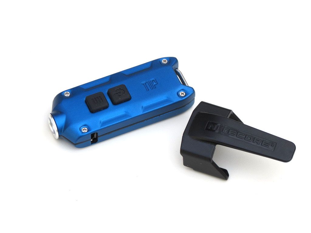

    the clip can be added and removed easily
    and protects against accidentally-on at this way

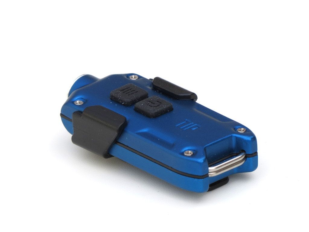

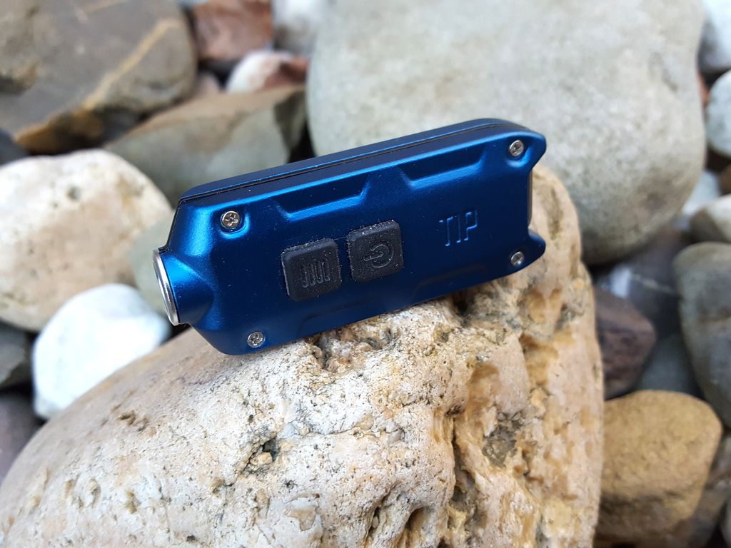

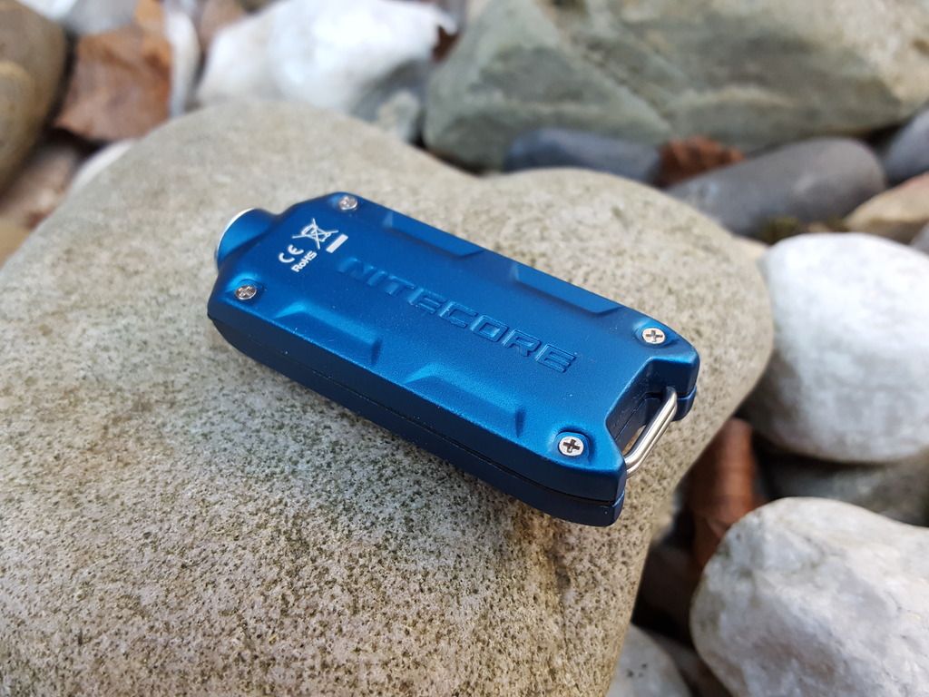

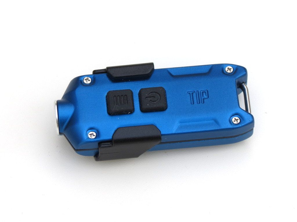

    the big buttons are easy to locate, but less easily distinguishable
    the brands’ name is “casted” in the body
    a close up to the notches that hold the clip
    buttons have the same shape

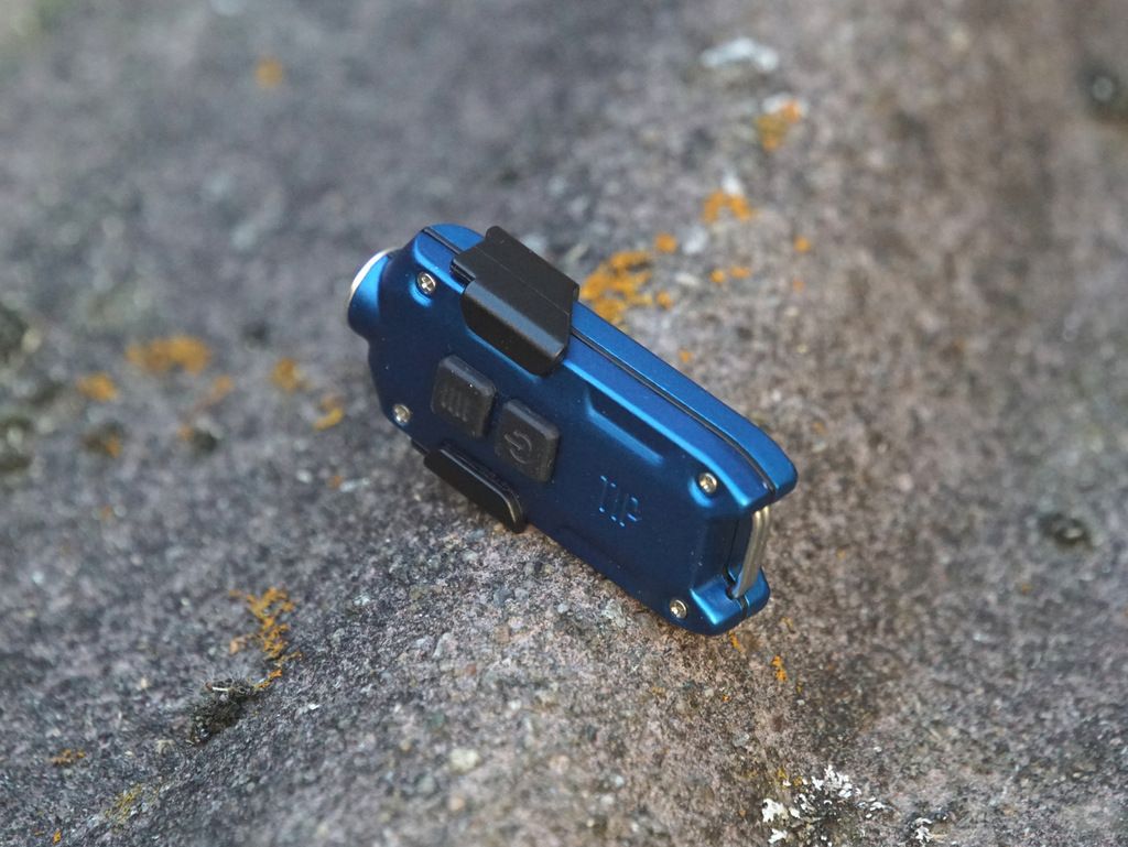

    sturdy and handy clip

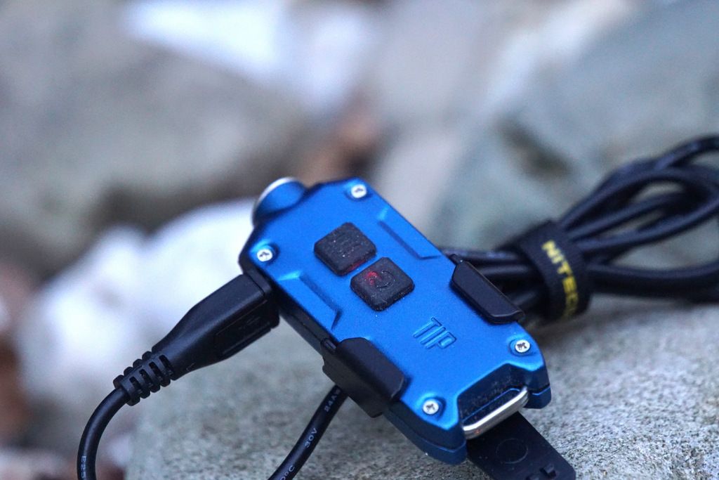

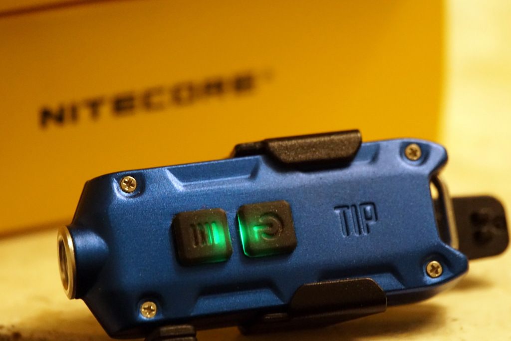

    charging the TIP 2017: easy job, the built-in LED informs about the progress
    green means fully charged, job is quickly done

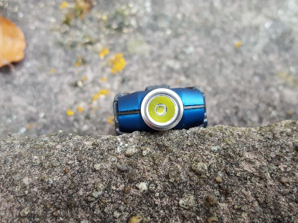

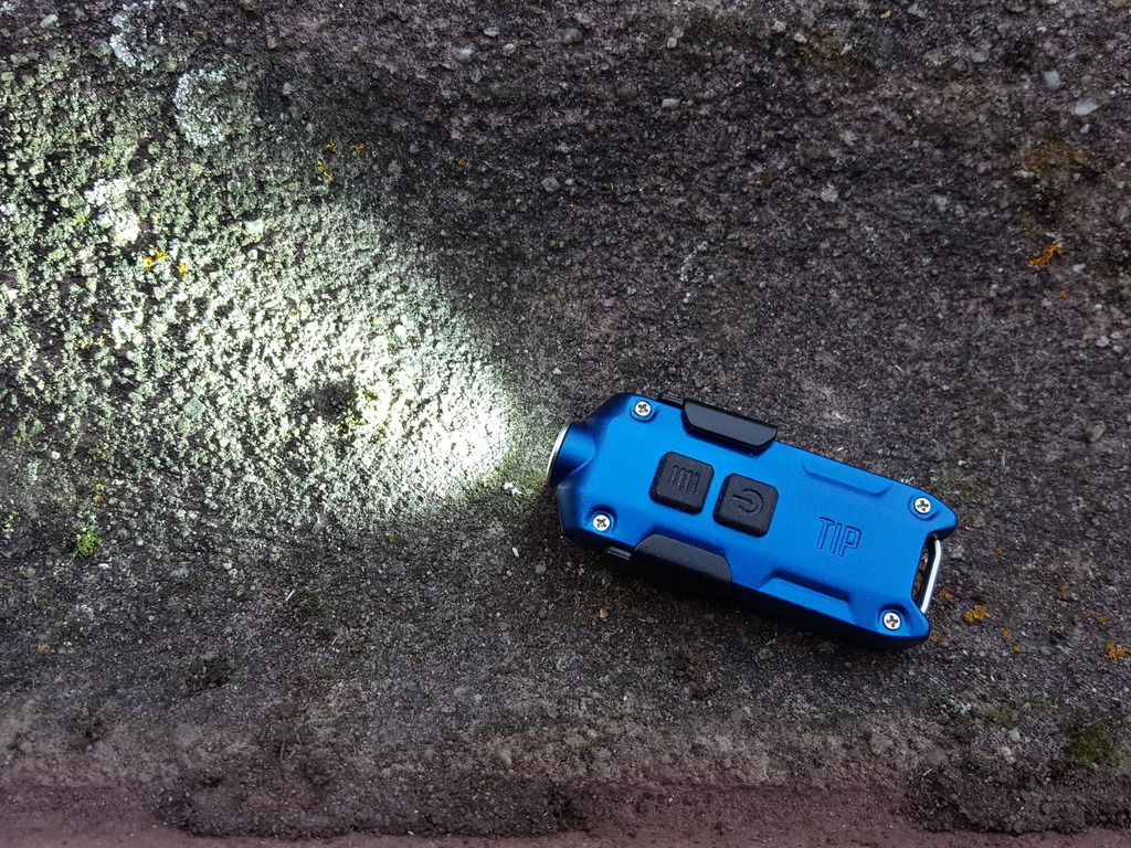

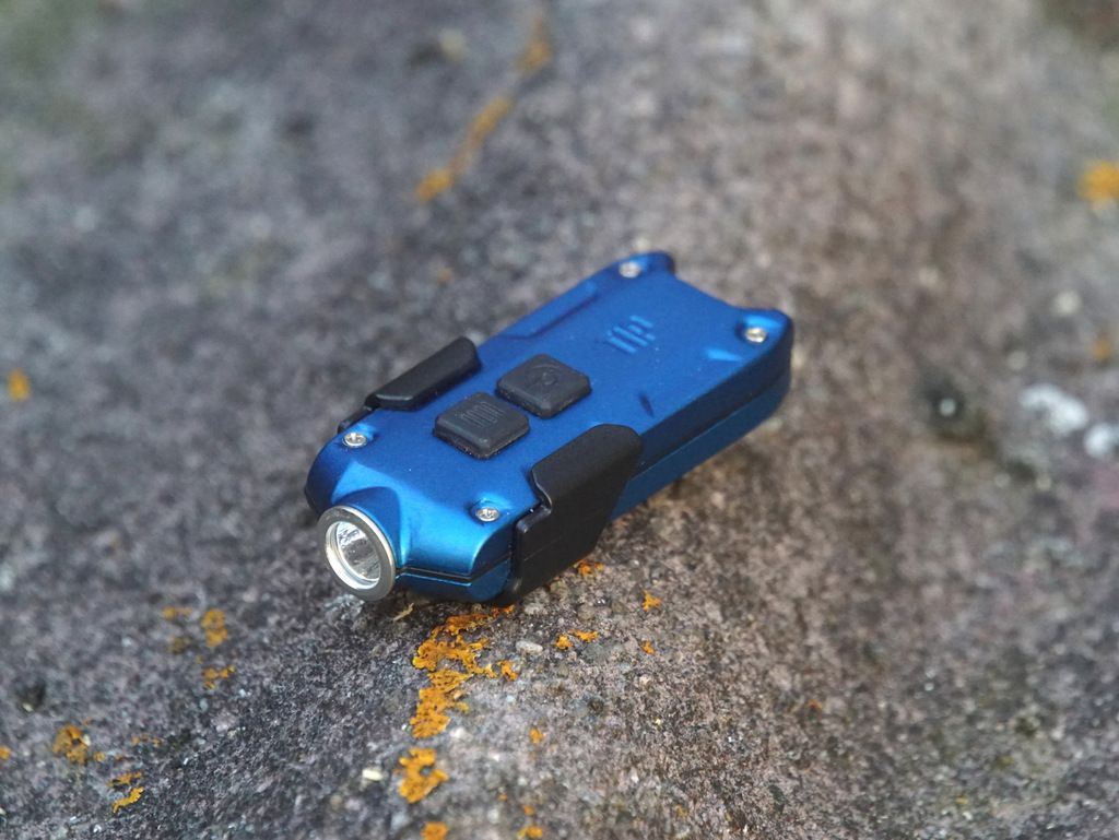

    some outdoor shots: the TIP has nice metallic blue color
    also impressive output to its size

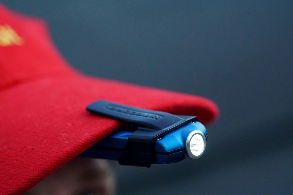

    has a lot of carrying-options
    for example at your cap
    and will help you in a lot of situations
    nice silver accents around the lens
    so tiny, but so many options!
    a great EDC-light

    Charging the TIP 2017 is an easy job, and average it will be fully loaded within an hour. Simple connect a random micro-USB plug to the port; the built-in indicator will inform you about the progress, and light up green when the charging-job is done. The TIP 2017 has also built-in power check: A single click at the mode-button and the led indicator will flash one, two or three times. The more flashes, the better battery status. So, no accurate voltage-reading here, but I’m happy with this feature too. If the battery-voltage is critical, it will flash repeatedly.

    Like we saw earlier, the TIP 2017 has two main-modes: Daily and Constant. The output modes are equal, starting at LOW > MID > HIGH > TURBO. The spacing is very good, and the light has a good low 1 lumen-mode. Two instant modes: direct-LOW and direct-TURBO here. The light has MOMENTARY too, only at LOW and TURBO. No special / flashing modes can be found on the TIP. The light has both VOLTAGE indication as LOW-VOLTAGE warning. No LOCK-OUT, you have lock it out by sliding the clip over the buttons. I’m happy with the modes on the TIP 2017, if fits to most needs; maybe a SOS-mode would make it even better.

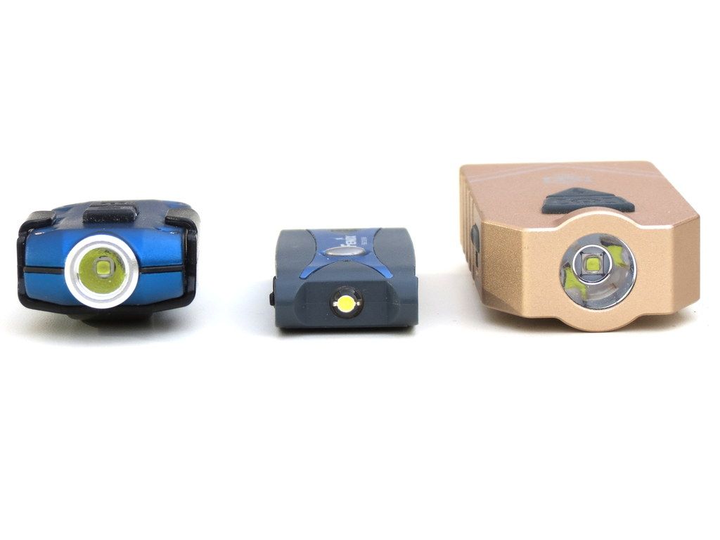

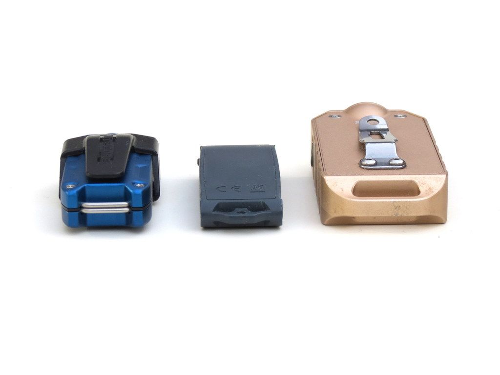

    Size comparison:

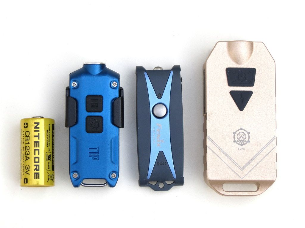

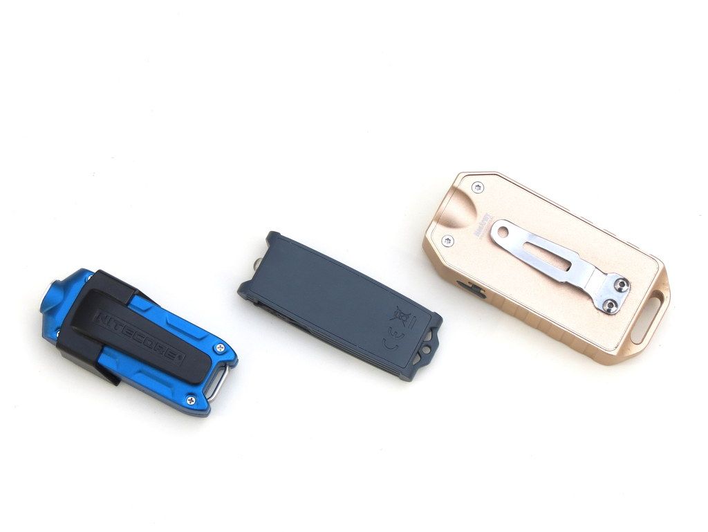

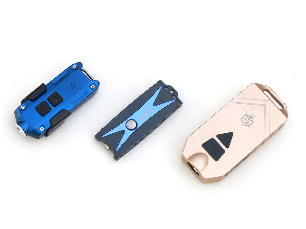

    The TIP 2017 shown here with some other recent keyring lights; all are USB-rechargeables but have different LEDS and output. I’ll use these three later for my beamshots too.
    CR123A, Nitecore TIP2017, Fenix UC01 and MecArmy SGN7
    the fronts: XP-G2 S3, Nichia high performance LED and XP-G2 S4
    the backs:

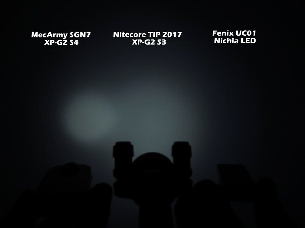

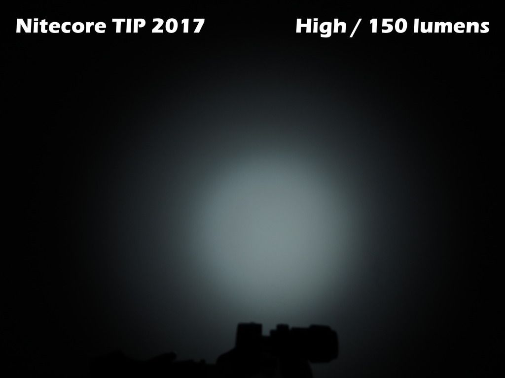

    The little reflector creates a rather big hotspot and corona and not that much spill. So, it’s clear that this light is made to illuminate the closer distance. A usable beam to and EDC-light, not that floody, so a good option to illuminate your trail during a walk or running. No defects in the beam, neither PWM.
    Let’s have a look now at the output. Starting by projecting the TIP 2017 on a white wall. Distance to the wall is about one meter.
    Camera-settings: ISO100, F/2,7, WB daylight, 1/125 sec, 35mm
    GIF-picture:

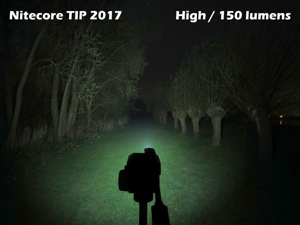

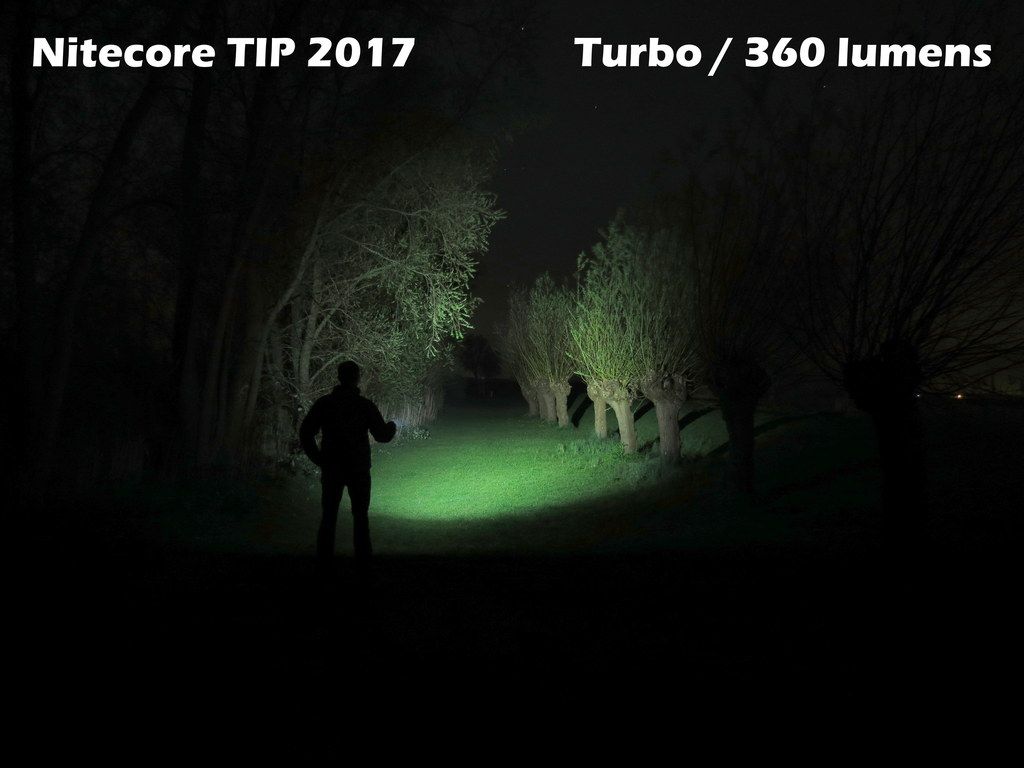

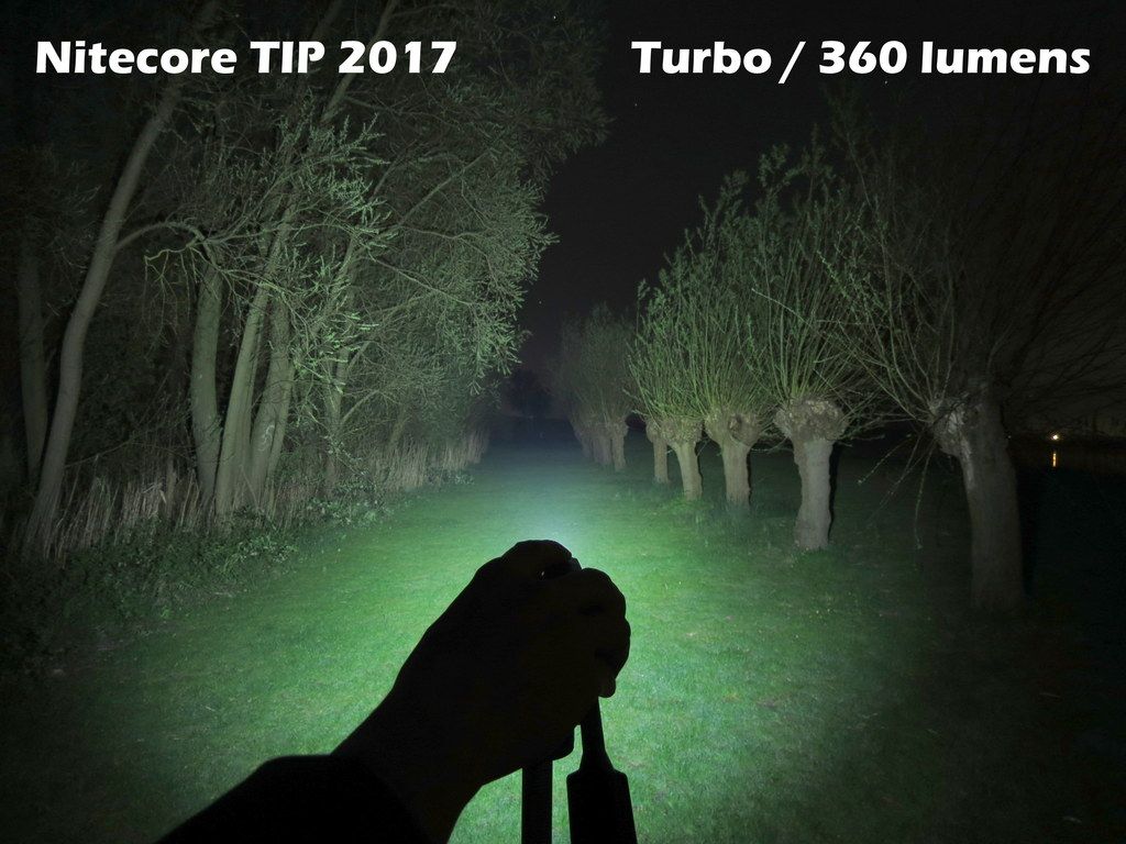

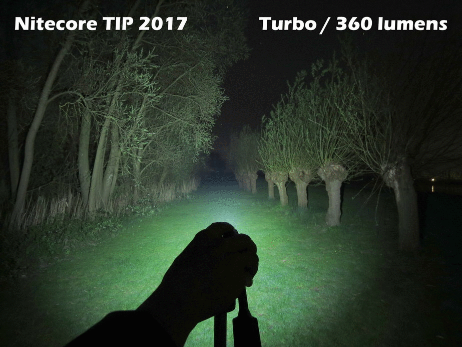

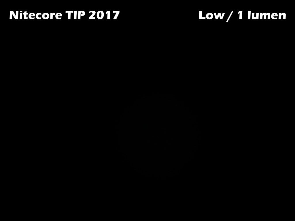

    Going outdoors now! Some beamshots here at closer range; illuminating some lines with little trees. Starting by showing the four output modes of the TIP 2017. I used the burst-option for turbo here; as I told you earlier, the TIP 2017 has constant-turbo too.
    Camera-settings: ISO100, F/2.7, WB daylight, 4 sec, 35mm
    GIF-picture:
    As you can see at the photo below, the TIP 2017 is a very nice option to light up your trail; it has a smooth beam.
    the Nitecore TIP 2017 at highest level

    The next shoot-out is against the MecArmy SGN7. This light has more lumens, and a deeper and smooth reflector, so a different beamprofile.
    the TIP 2017 against the MecArmy SGN7, both at turbo
