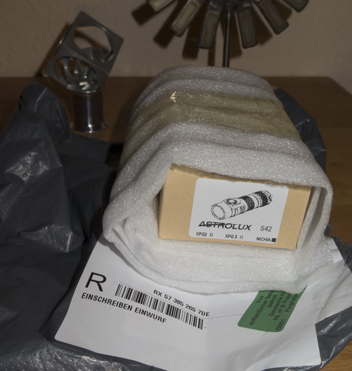

    the parcel arrived after 36 days shipping with to Germany which is acceptable from China.

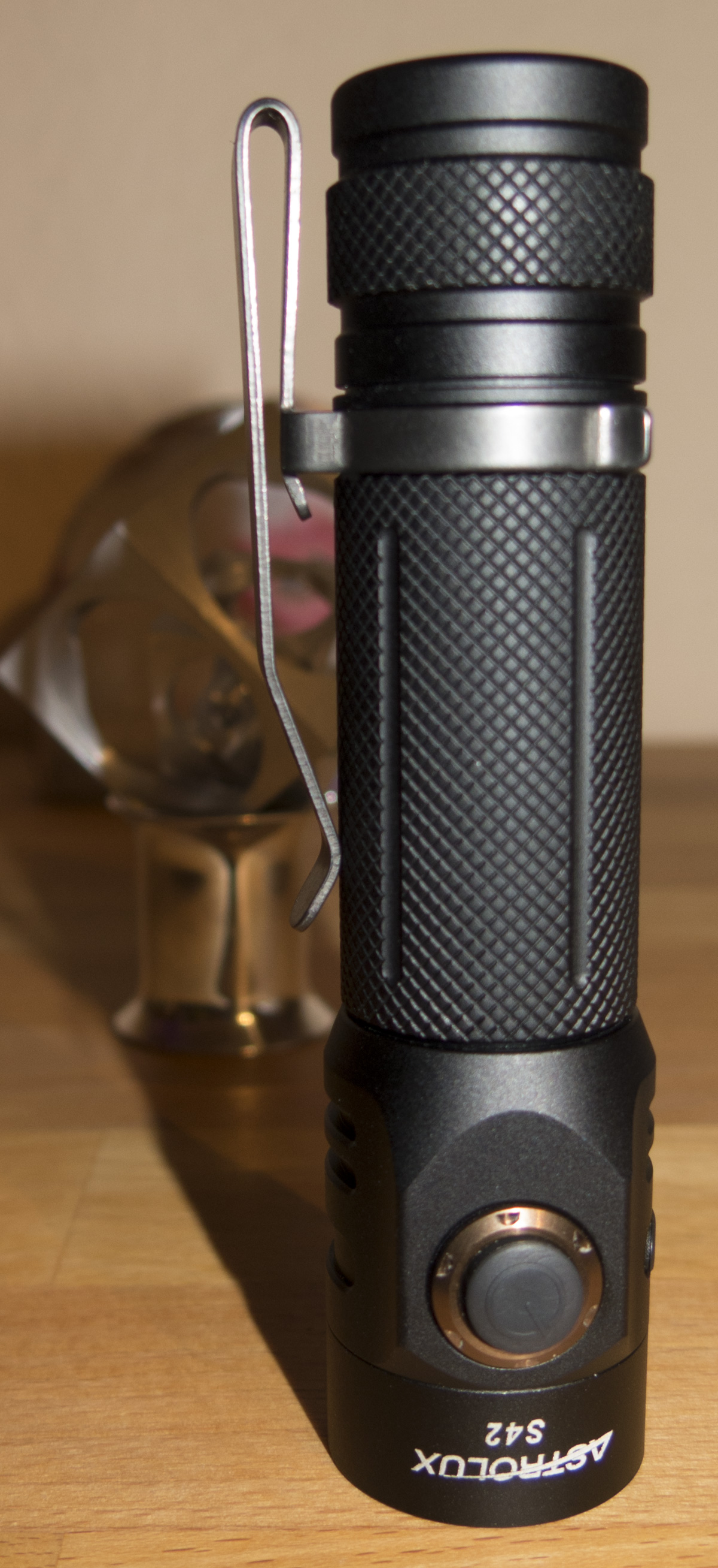

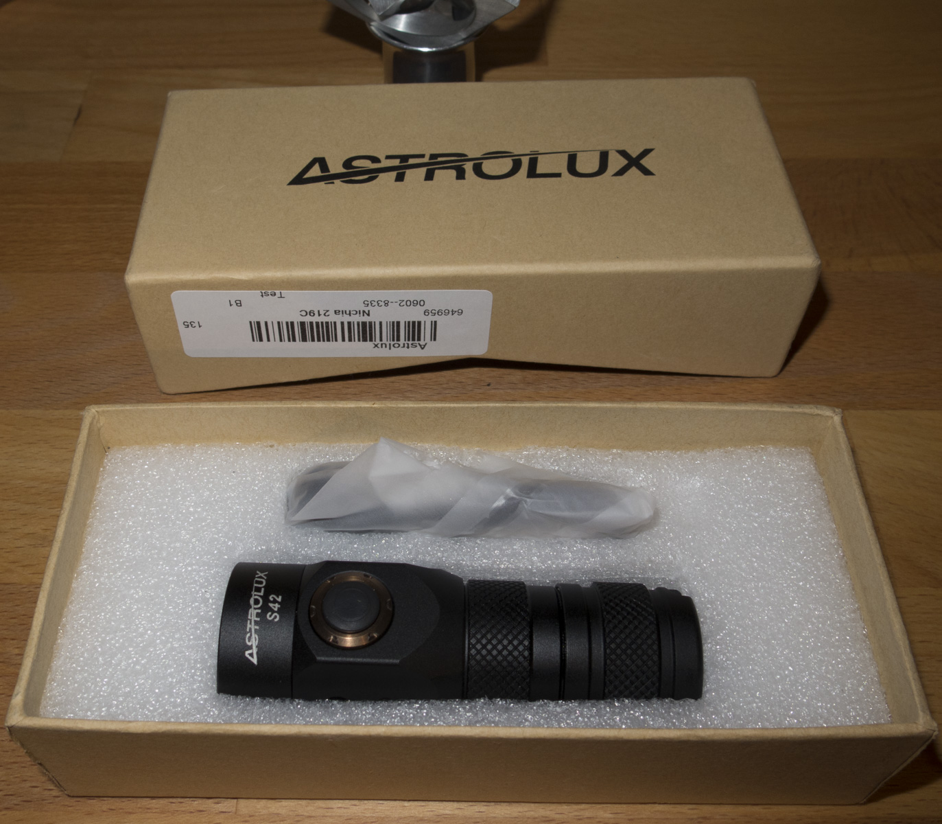

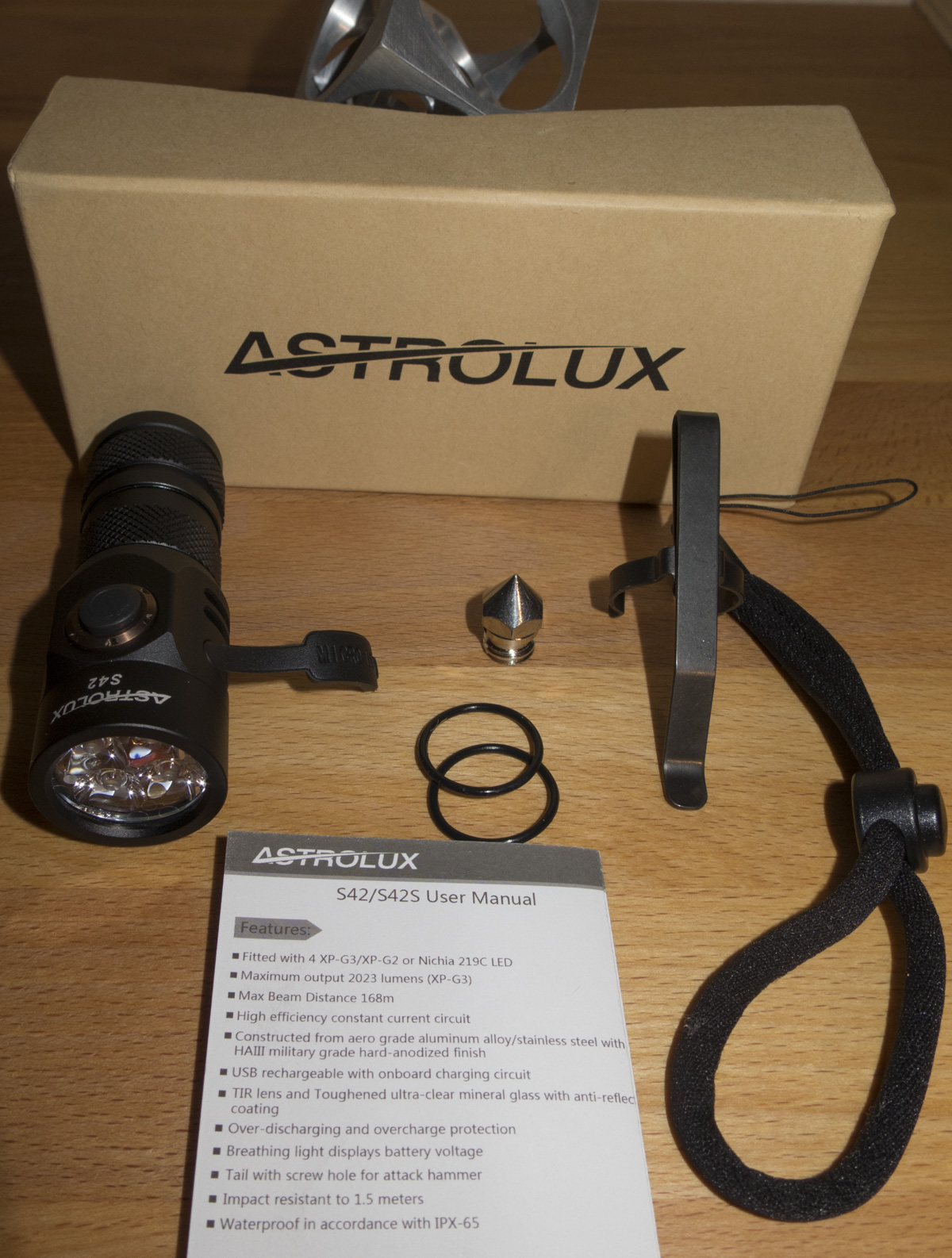

    Package and content:
    The light came packed well with a plenty wrap around and in a plastic bag
    The light comes in a card box which is typical for Astrolux
    The box has a compartment for the light and a battery, but the battery compartment has 14500 size while it is a 18350/18650 light
    It comes with 2 spare o-rings, clip, lanyard, spike, thread adapter and manual
    Here you can see the optional 18650 tube with clip attached, compared to an Utorch UT01, which looks quite familiar as this light

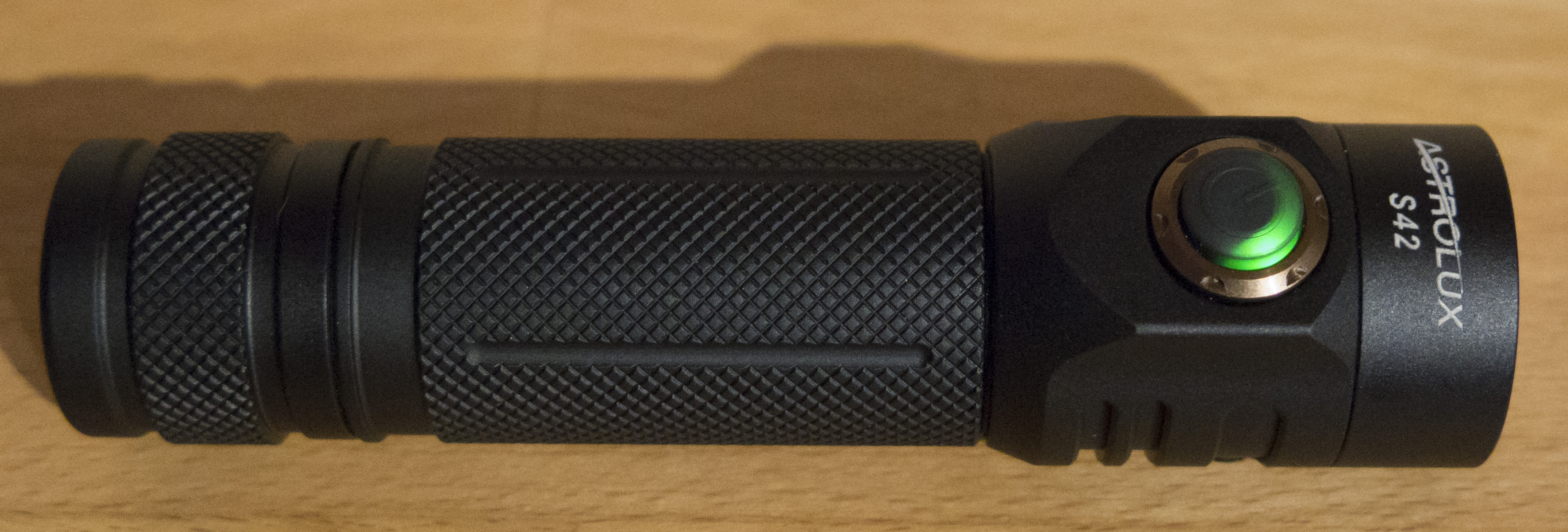

    Photos of the light

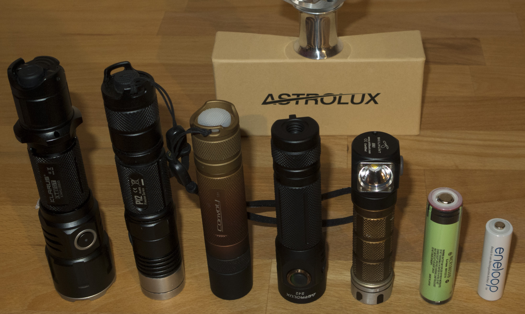

    Comparism and teardown:

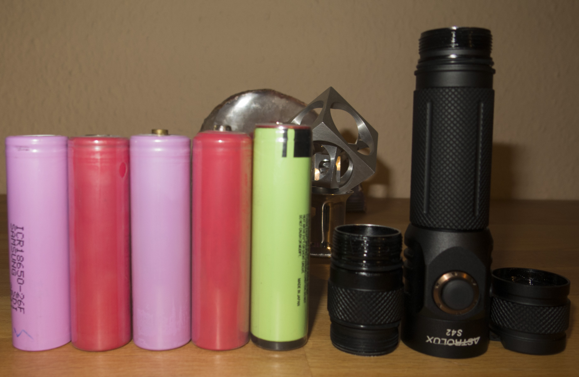

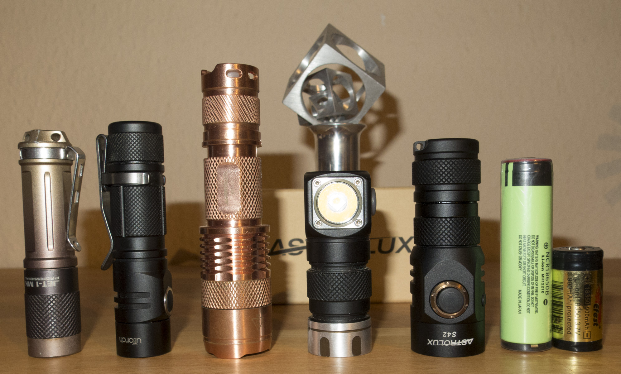

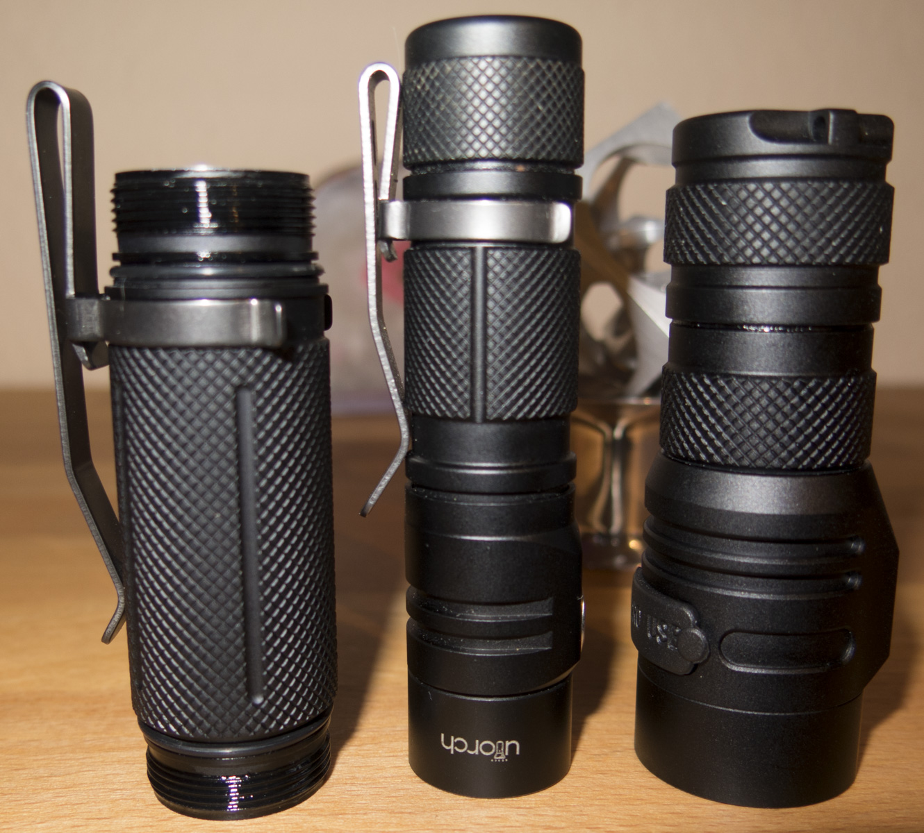

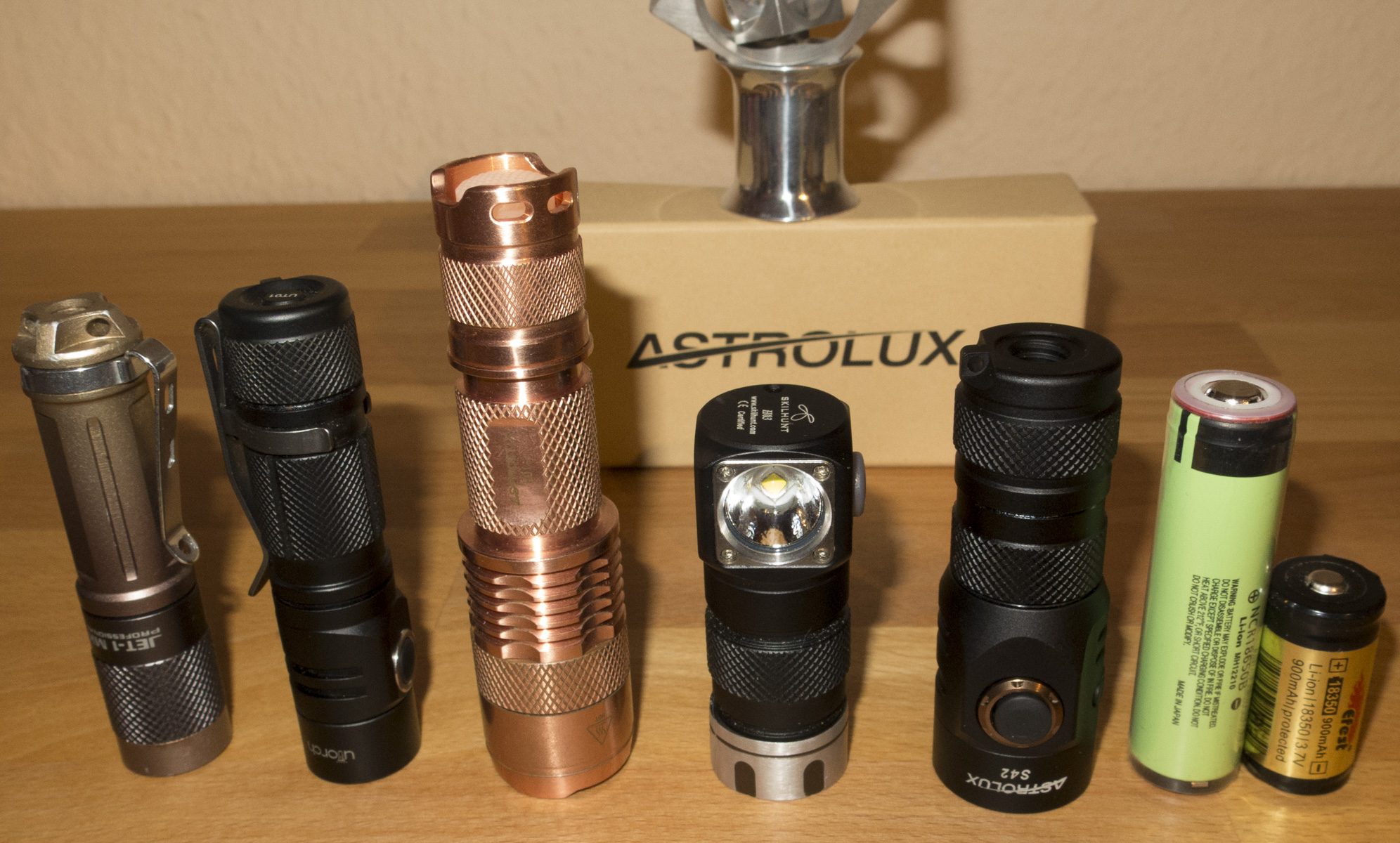

    Size compared to other 18350 and 14500 lights
    I would have dropped the thread for the spike in the tail cap to get the light shorter
    compared to 18650 lights
    there is a 18650 aluminum tube available, but it is as well too short for button top or protected batteries, probably a longer 18650 will be released soon for the S42

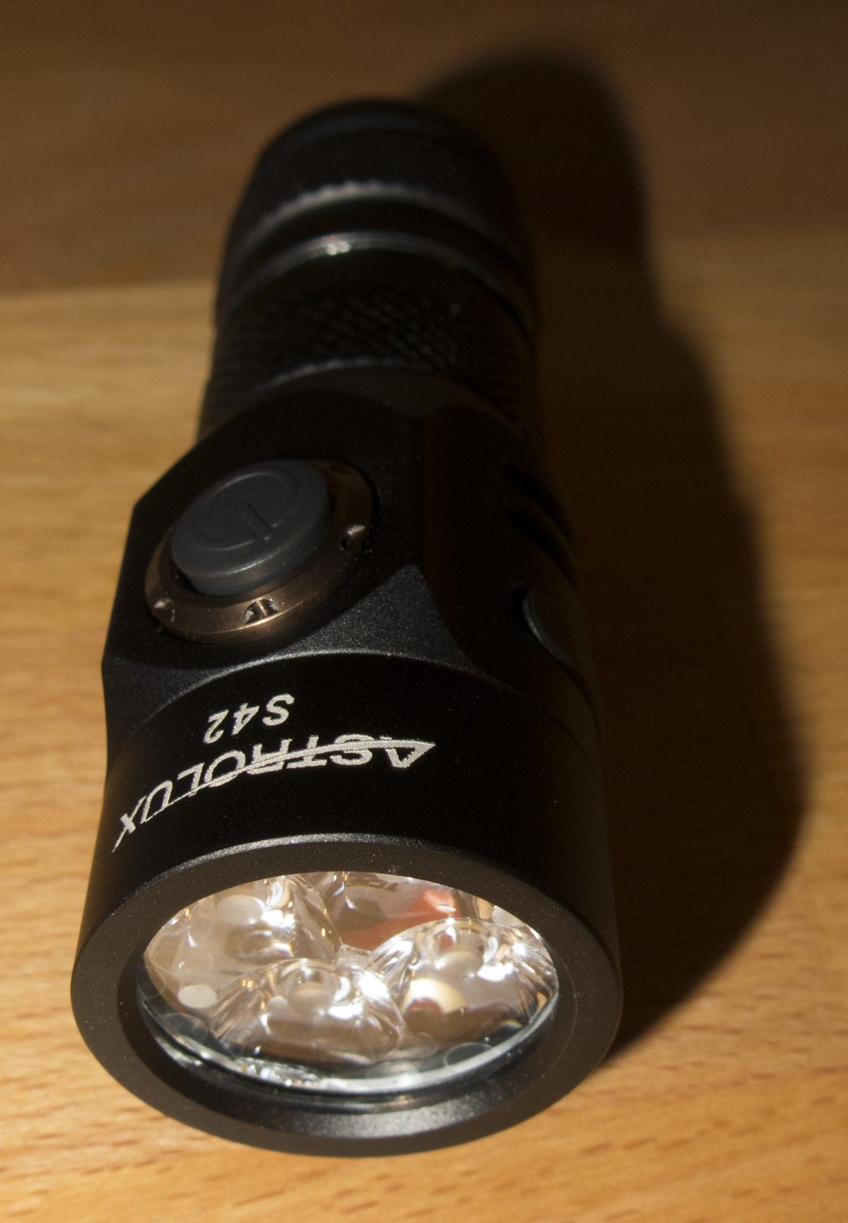

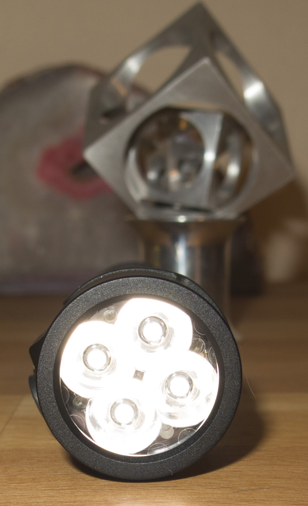

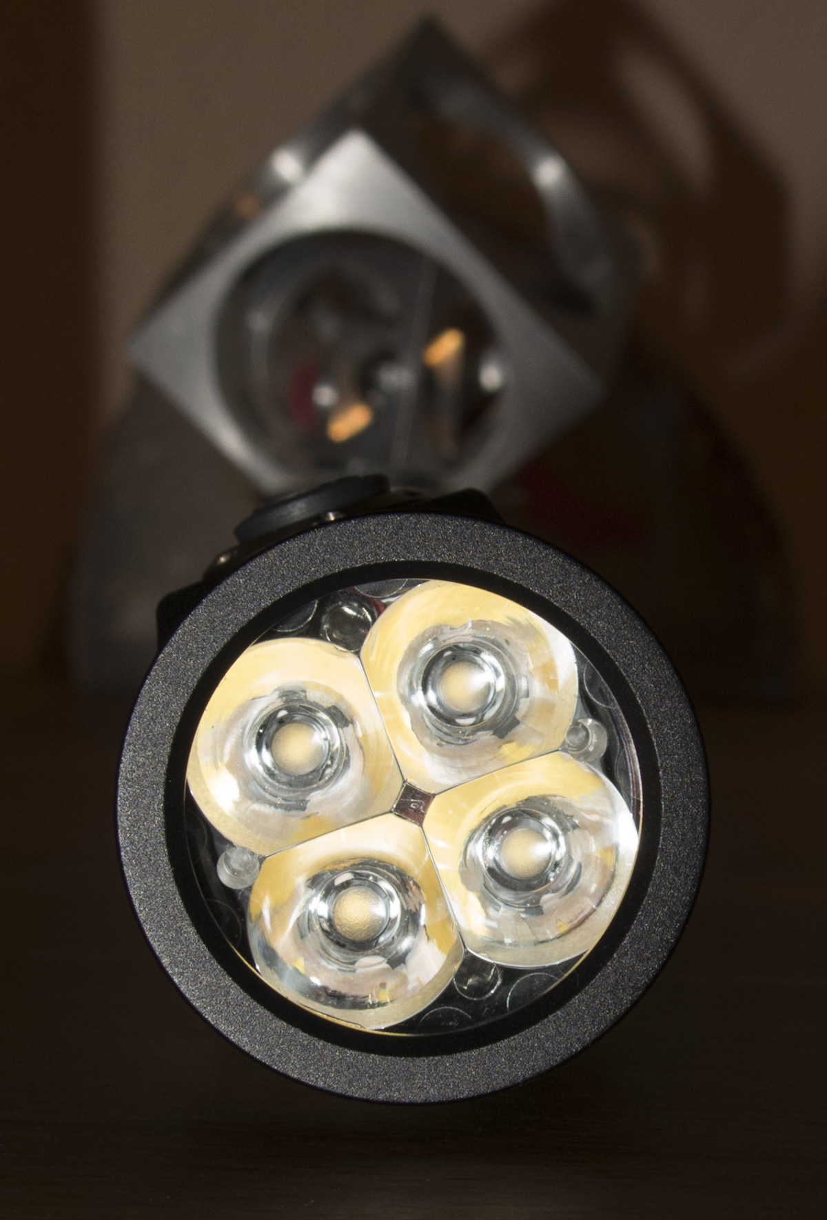

    Beam color is neutral around 5000K for the Nichia 219C model, the Nichia has a nice uniform beam and color rendering is great

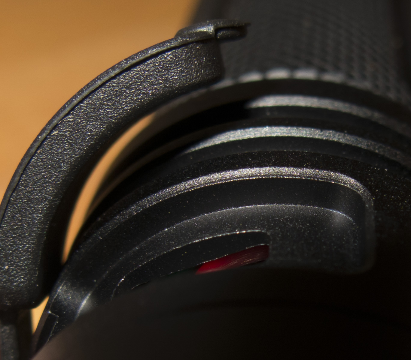

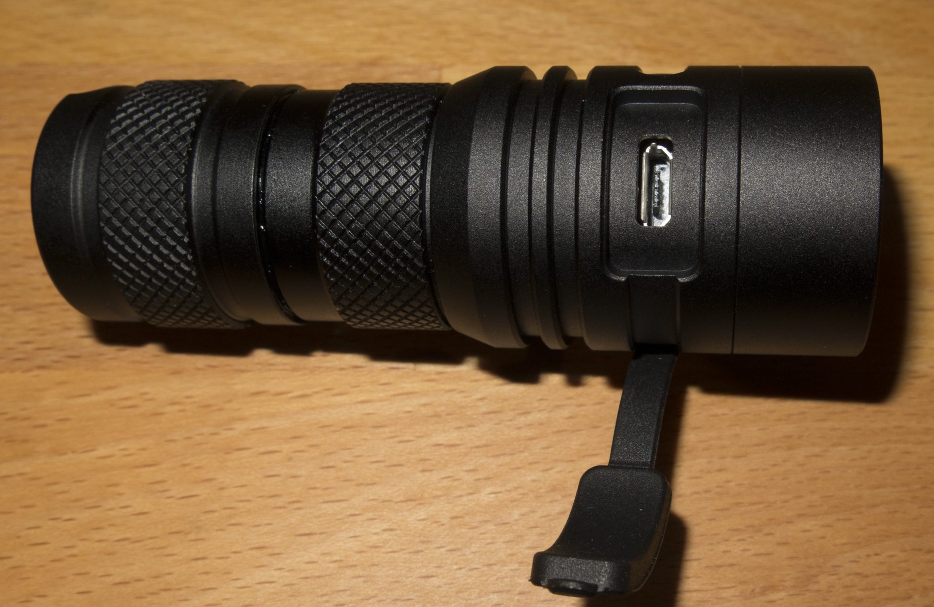

    The LEDs are perfectly reflowed and the MCPCB sits perfect, but the charging port cover slips too easily

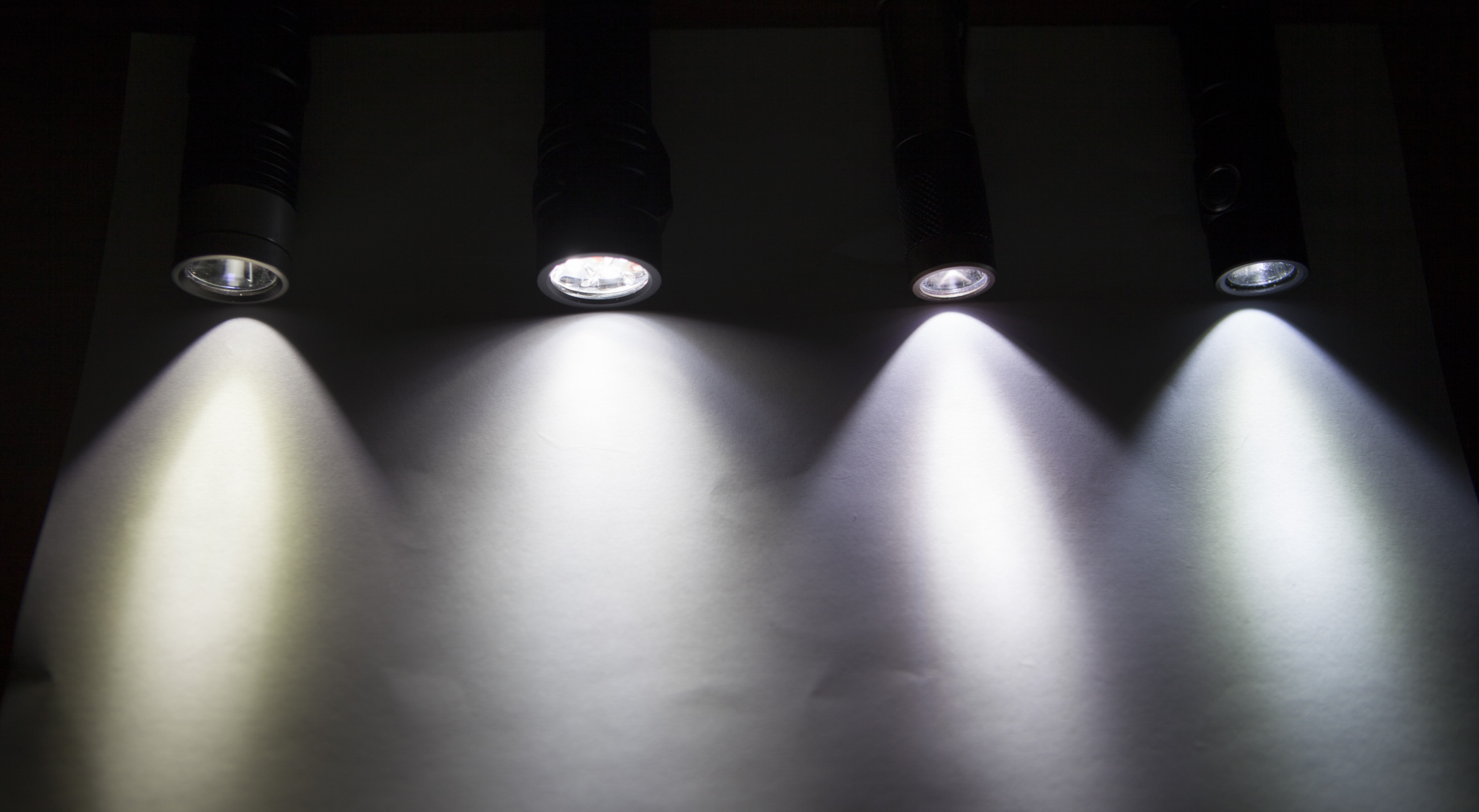

    from left to right the lights get warmer, picture taken @5000K camera setting
    left XML2 U3-3D 5000K, Astrolux S42 Nichia 219C 5000K, Nichia 5700K, XPL HD 1A 6500K
    The LEDs in this light are available in XP-G2, XP-G3 and Nichia 219C

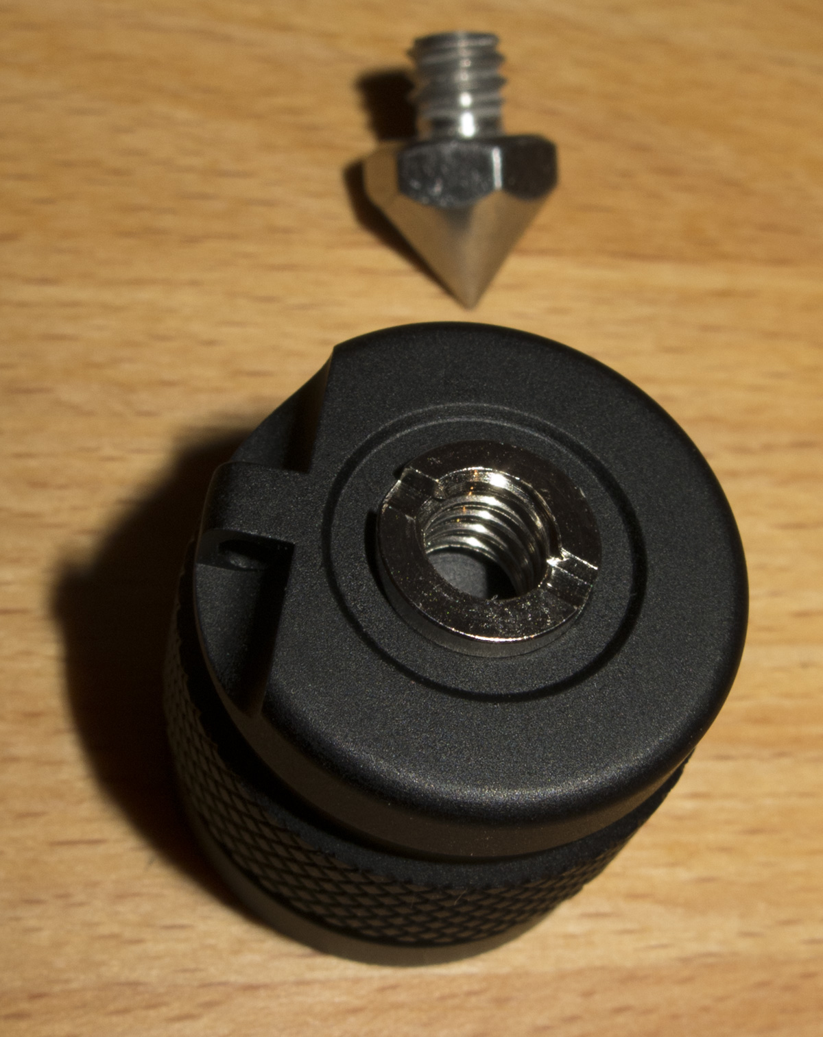

    The light has the tail cap with a thread for the spike or an tripod

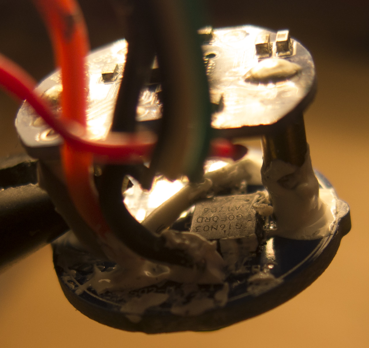

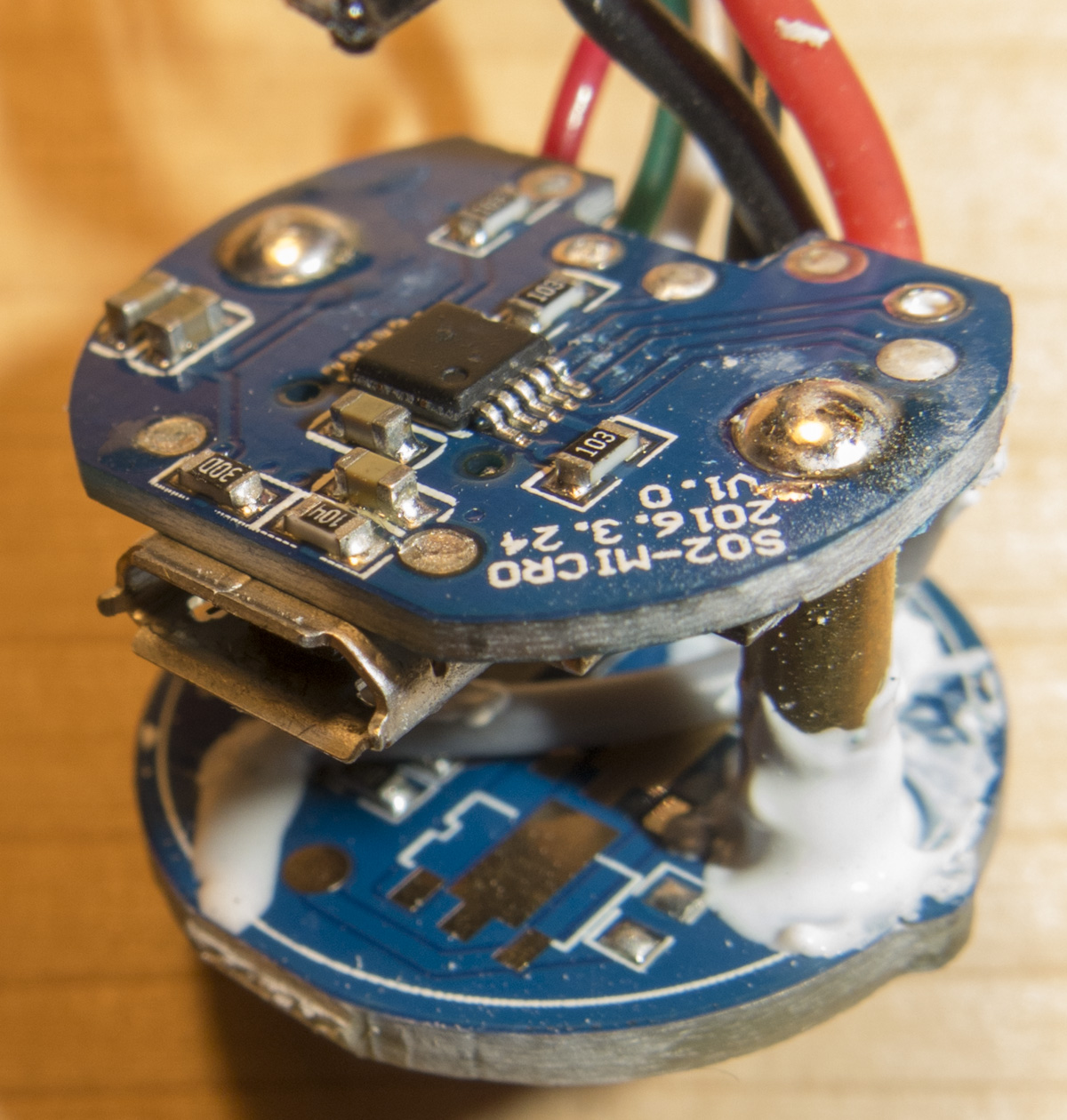

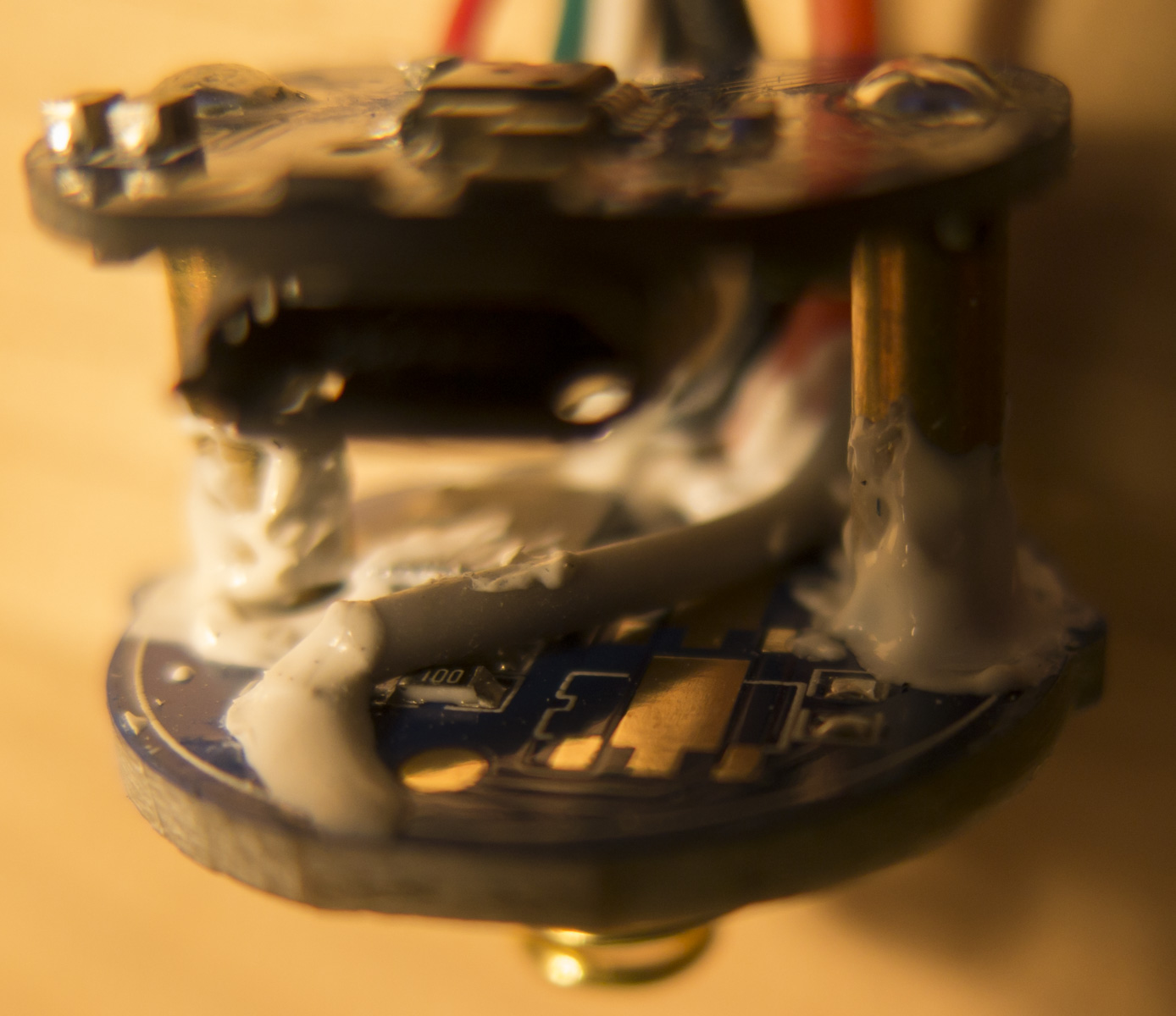

    The driver can’t be pulled out easily, the LED leads have to be unsoldered
    I highly recommend unsoldering the side switch board as well
    then push the driver out through the LED wire hole
    The driver board has 2 pads for AMC7135 chips which are not populated
    So a single FET is controlling all modes
    the leads are all reinforced with some glue

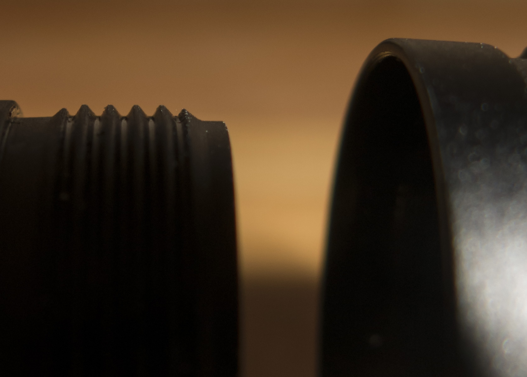

    The threads are triangular cut, good quality but square cut would be nicer
    The light can be physical locked out by twisting the tail cap or head

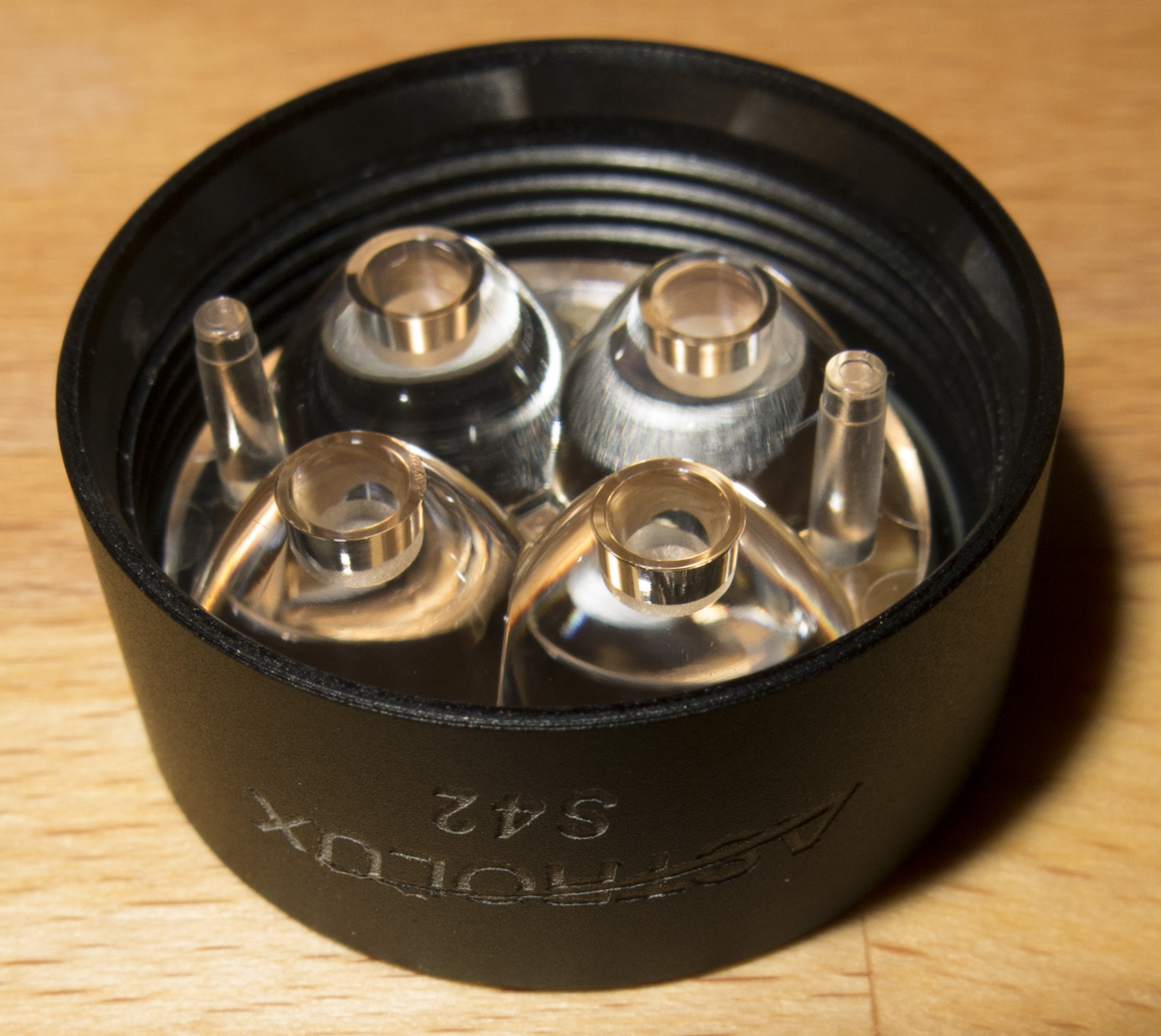

    The Head

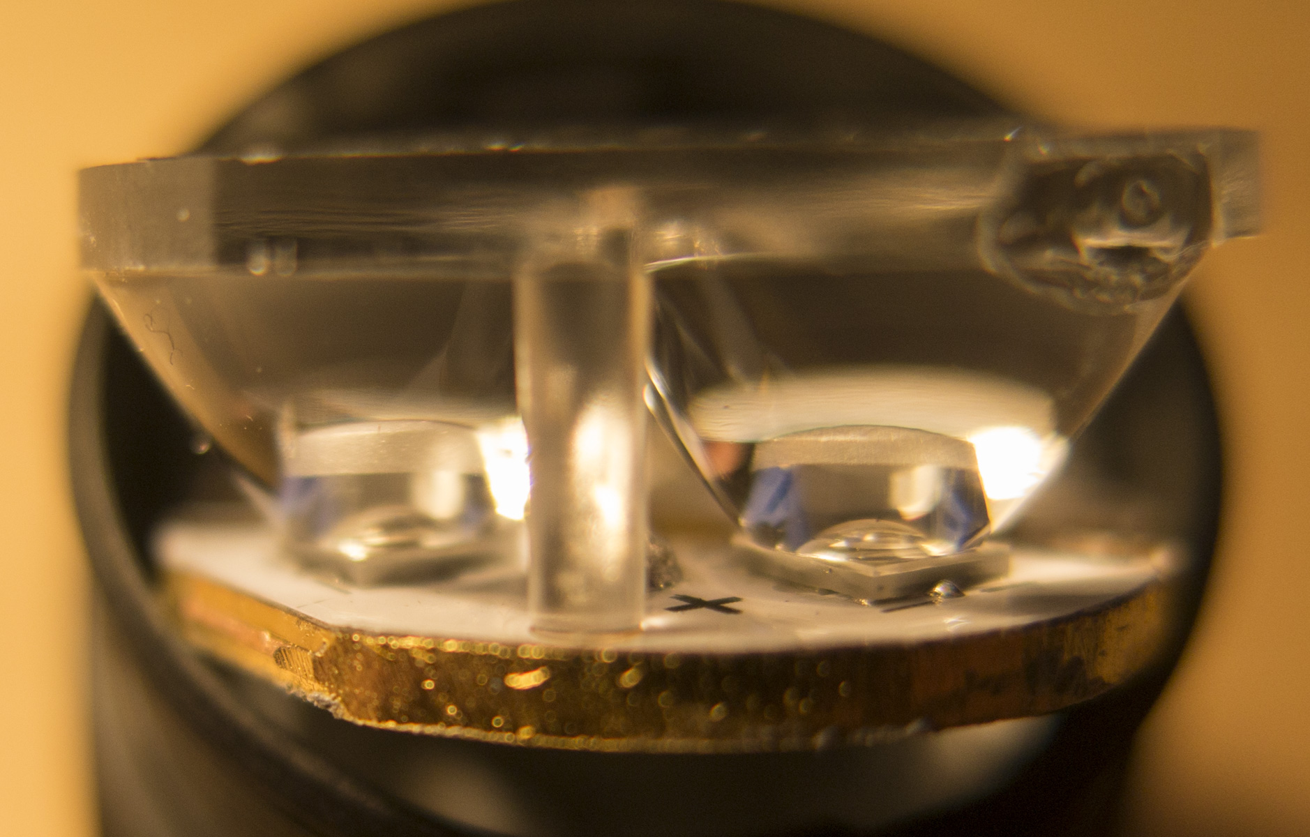

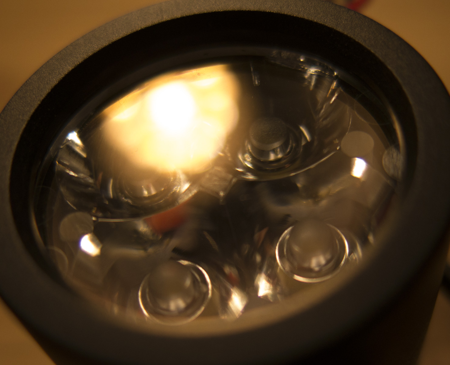

    the TIR is a medium flood, gives a nice uniform beam with some spill
    the Nichia LEDs fit in nicely

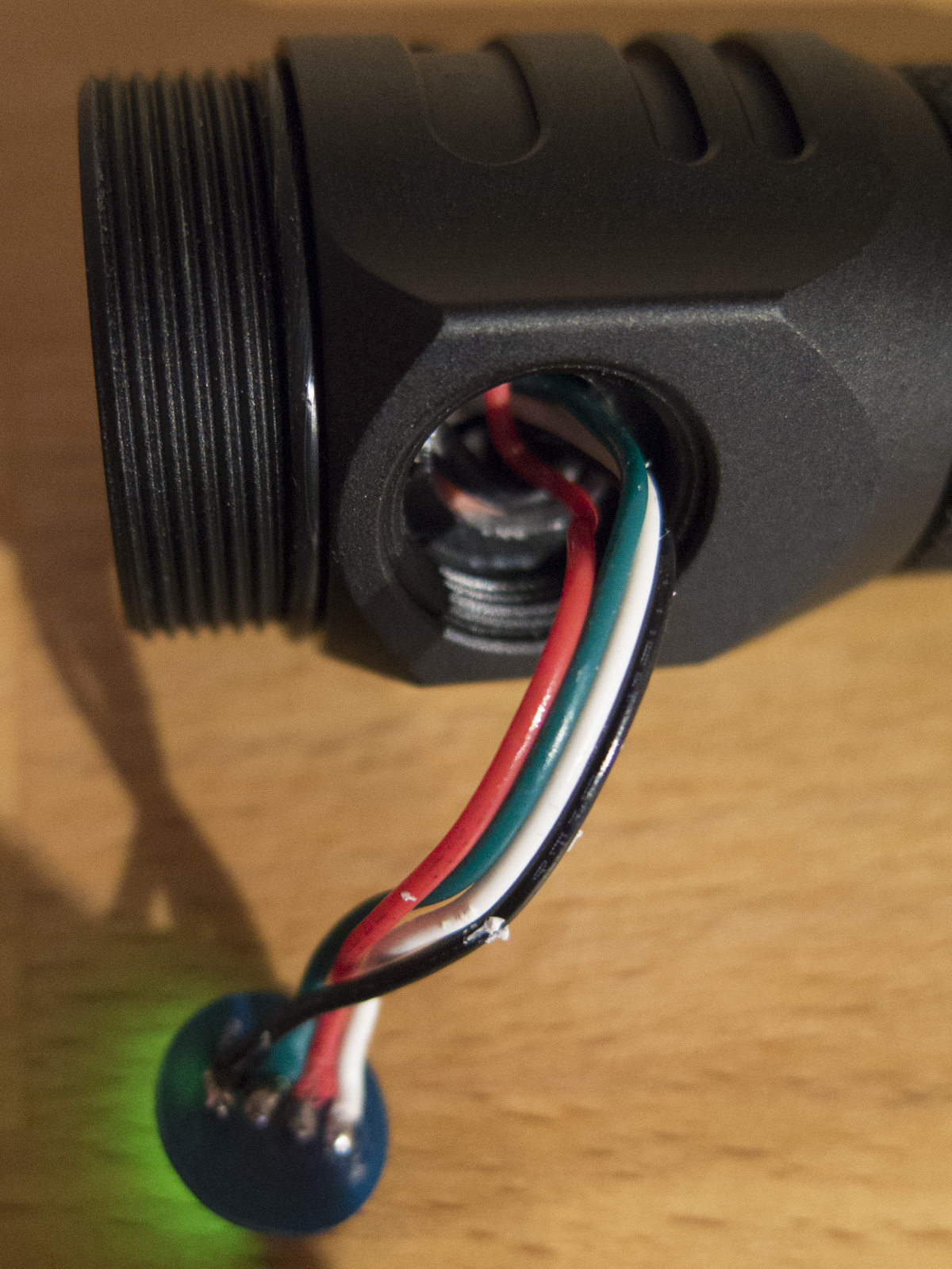

    The slave board for the switch has also a green and red LED
    The shelf is about 1mm thick, it could be more, but the thick copper MCPCB does a good job spreading the heat, on Turbo the head gets hot really quick, so the thermal path is well

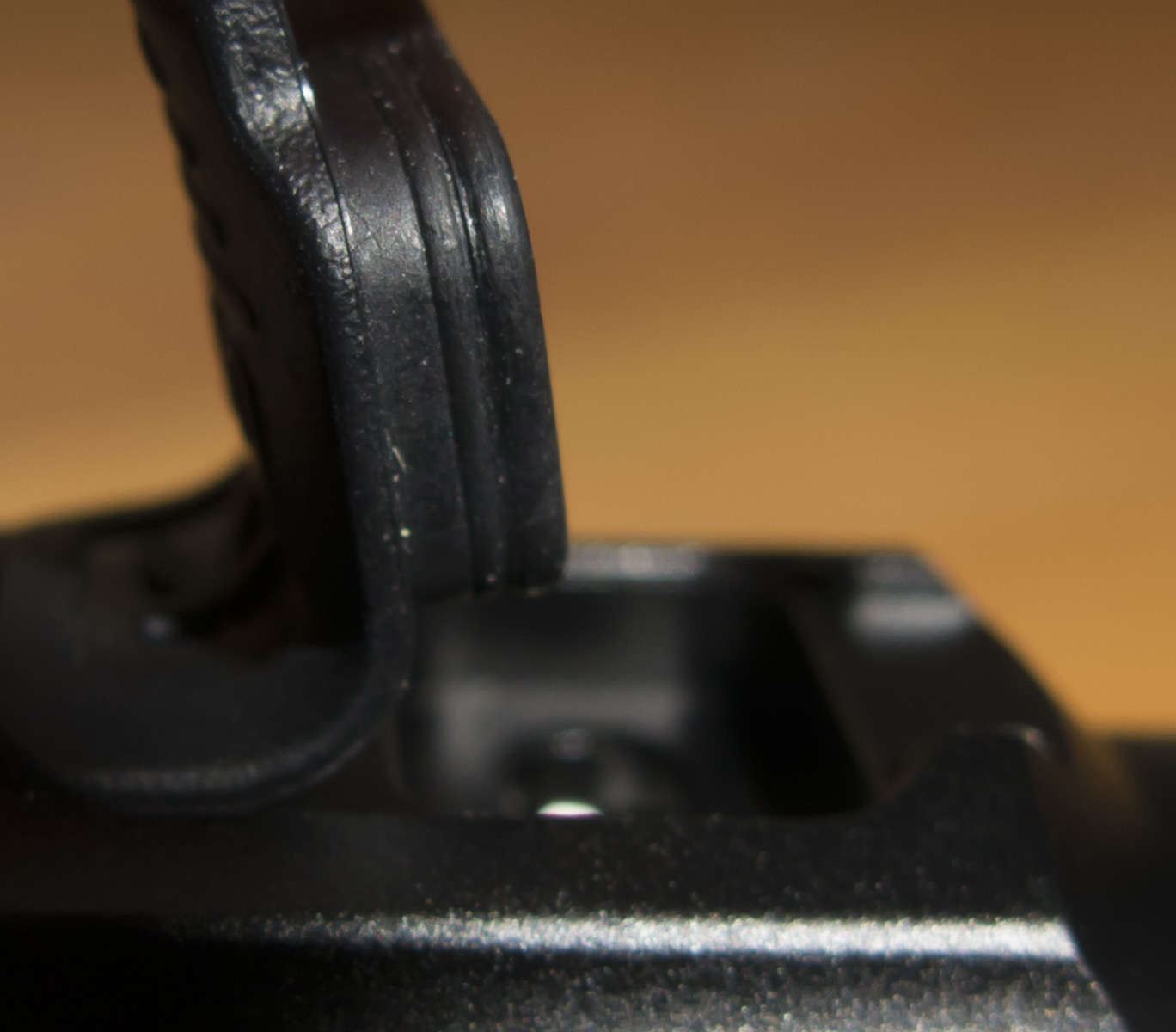

    Waterproofness might be an issue as the USB cover gets very easy loose, they should have made the cut out 1mm deeper like the Klarus lights and have the rubber cover with o-ring like shape
    Banggood does provide a new designed USB cover

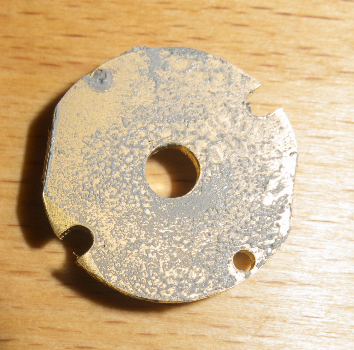

    The thermal paste was applied in a moderate quantity and seems to be some silver compound, when I removed the MCPCB I saw a really nice pattern which means it was on the full surface and in a thin layer
    The MCPCB is s true copper DTP one about 1.5mm thick, very nice, the back of it is gold plated
    The MCPCBs back is perfectly flat
    The lens is AR coated glass
    I would like to see the TIR attached to the lens with optical glue to get more OTF lumens

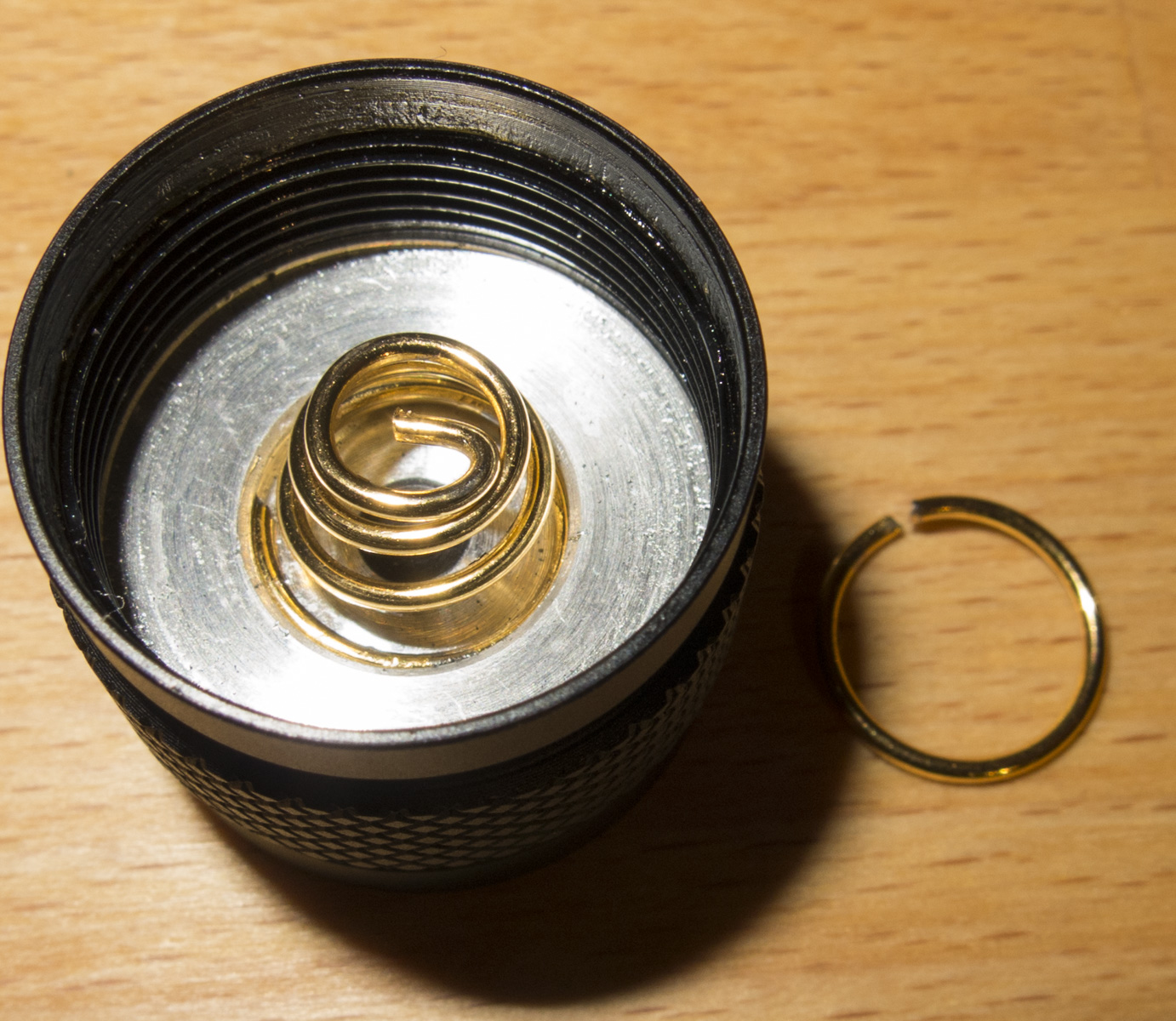

    Tube and Tail

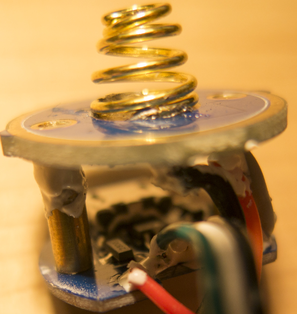

    Tail cap spring is thick and seems to be some alloy which is barely magnetic possible stainless steel, also the driver one is barely magnetic
    I cut the tail spring a bit shorter as my unprotected brass button cell get dented in the tail, when fully screwing the tail down, even with raised top cells like Sanyo 18650GA it’s a tight fit

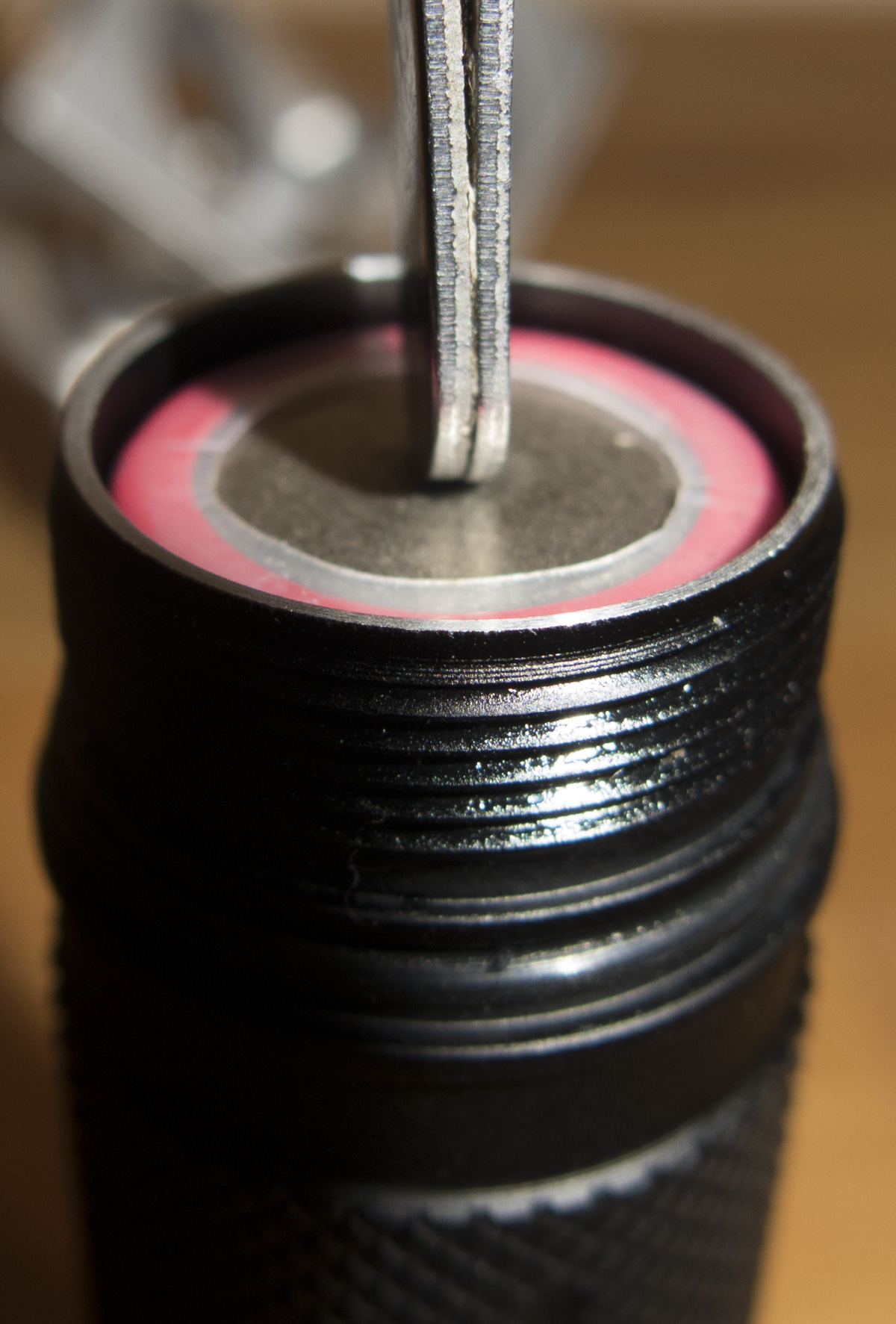

    The light is build for unprotected batteries, protected or button top unprotected won’t fit
    from those batteries only the 2 left fit without a problem, with the S41 tube
    the tube inner diameter is 19mm, the springs get fully compressed with an unprotected flat top cell, so their resistance is very low, the tail spring sticks a bit over 1mm inside the tube
    The tube threads are triangular cut on both sides, the tube has 2 o-rings and the tail side is lubed for water tightness

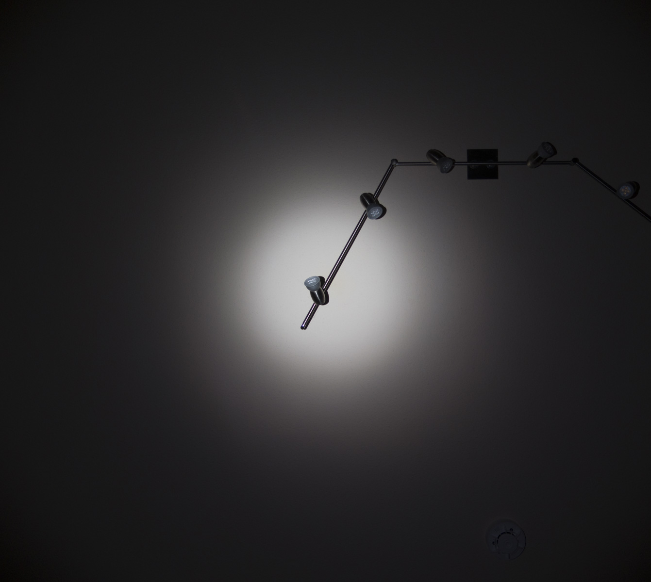

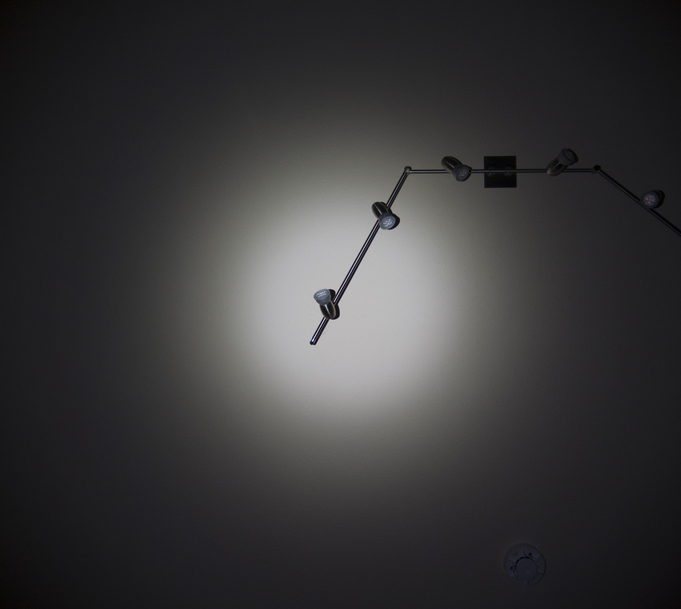

    Beam shots
    about 2m from Light to ceiling
    Astrolux K01 XPL-HD 3D
    Jetbeam Jet-1 MK modded with Nichia 219C from a BLF348-2016
    Utorch UT01 6500K
    Nitecore P12 XML U3-3D NW

    - waterproofness might be an issue as the USB cover gets very easy loose, they should have made the cut out 1mm deeper like the Klarus Lights and have the rubber cover with o-ring like shape, this is going to be changed

    driver replacing without keeping the chargin circuit is easy, a 21mm driver fits with minor sanding
    with AWG18 and SIR800 FET pulling 18.9A on cold start
    instead the 9.95A with fresh Samsung 18650-30Q cell
    I did come out with a solution I like keeping the old drivers slave board electronics
    I did wire the old electronics with the LED+ wire on the star, so if I want deactivate the USB charger and breathing lighted sideswitch to get rid of the parasitic drain,
    I can unsolder the thin wire on the star
    The drivers contact board and TA 21mm LDO driver
    trimed the board to fit easily
    used my Dremel to get rid of unsoldering the leads to the switch board
    trimmed the old driver contact board to fit inside the head, cut the bolts connecting both boards by 4mm and sanded it
    Driver assembly before gluing the old board on top of the TA driver to fix the position USB slave board
    I had to cut the USB opening a bit as I trimmed not enough leng of the bolts
    The lead connecting the old slave board with the battery, can be easily disconnected
