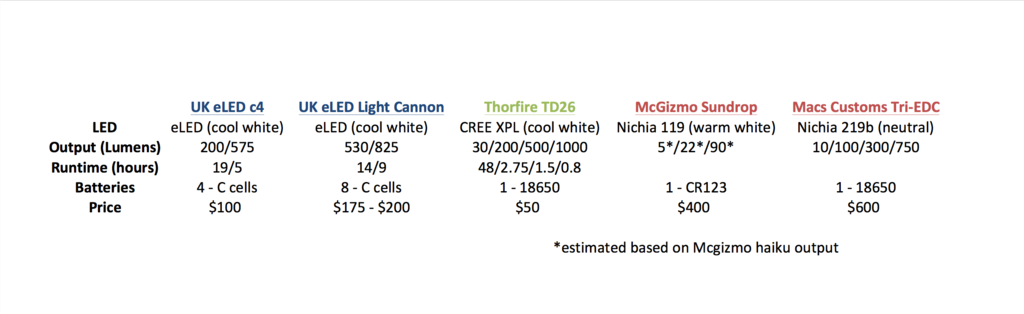

    The spreadsheet below breaks down all technical specifications between the dive lights, EDC lights and the Throrefire TD 26.

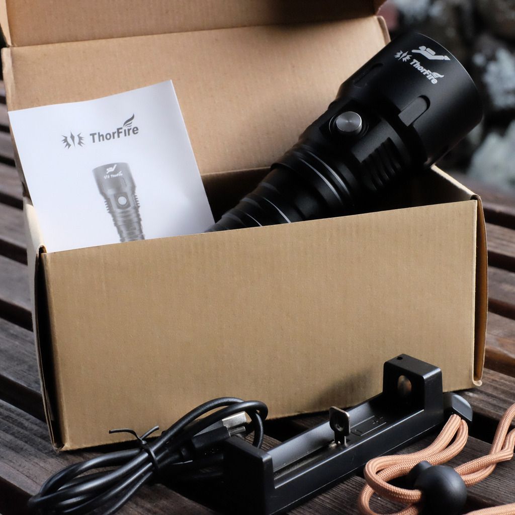

    I love the appearance, quality, LED choice and simple UI of the Throfire TD26, especially at a $50 price point. The flashlight is very nicely machined out of aluminum with a HAIII coating and is entirely waterproof. The raw aluminum button has a very smooth and tactile-less transition between settings and has a very simple and user-friendly UI (low, med, high, turbo, low, med,Ö.). The light utilizes a CREE XPL (neutral tint) LED, this is an excellent LED choice which has a nice neutral tint and provides 100,000 hours of life. In the box, it also comes with a rechargeable lithium-ion battery, charger, lanyard, and extra O rings.

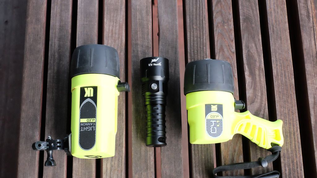

    As a dive light, I feel that the light is excellent in terms of the LED choice, variations in settings (L, M, H, T) and the strong hot spot which is very helpful in spotting fish at a distance. The XPL Led is neutral in terms of tint and will not distort color much. LEDs are great for diving as they utilize low amounts of energy, have a life of approximately 100,000 hours and theres no filament to break, making it much tougher. The settings are also nicely spaced as you can keep it on high/turbo to spot fish, and turn it on low when approaching without the light going off in between turbo and high. Two minor critiques that I have are the color and the shape. Having reflective tape, or bright colors are important in my opinion as it is very helpful if/when you drop your light or it dies at night. This has happened numerous times to me and if youʻre not wearing the lanyard (Iím guilty here at times!) it can be troublesome to find. My other critique is the shape, UK utilizes a pistol or lantern style grip and both are very ergonomic. If youʻre diving for 2-3 hours, your hand will fatigue with this style light.

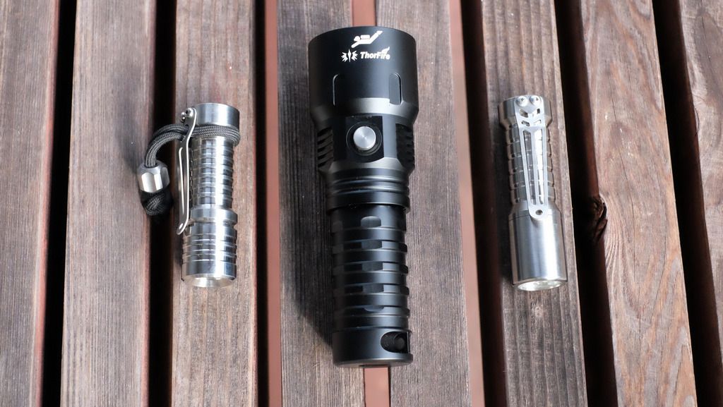

    As an EDC style light, I think this light is excellent for the aforementioned reasons (in the dive light section), but the sizing, weight, and ability to recharge this light is excellent! I actually keep this light in my work bag as a backup for my primary EDC light. My only complaint as an EDC style light is the size. When compared to my Macs and Mcgizmo, its significantly larger, however as a light for a backpack or car light it shines.
