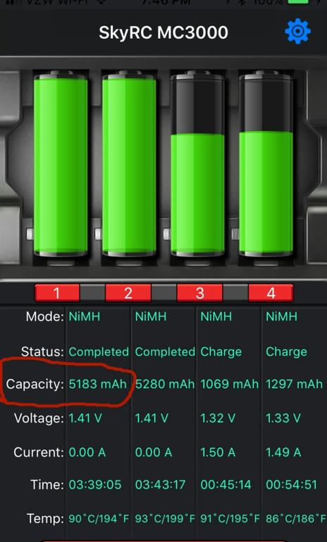

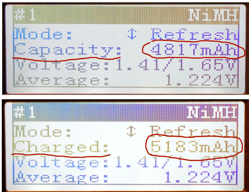

    I've had the SkrRC for a week now (latest version), and for the 1st time did a refresh (capacity) test. There seems to be a conflict on how the main unit, app, and PC link are reporting "capacity". The example below is for a 5,000mah Powerex C Cell.
    When the refresh test is completed, the main unit shows both the:
    "capacity": 4817mah
    and
    "charged": 5183mah
    OK, I understand the difference between charged/discharged capacity, nothing unusual there.

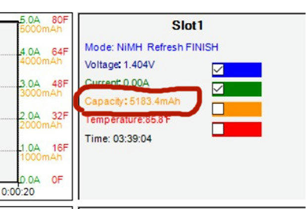

    However, both the PC link and app show "capacity" as the higher value - what the main unit is calling "charged".
    Would this not be confusing? It appears the main unit is defining "capacity" as the discharged capacity, and the app/PC Link are defining it as the charged capacity.
    Shouldn't there be consistency between main unit, app, PC Link?

    After more observation, I now see that the app and PC Link are showing the results of the last phase of the 3-part test (C/D/C), in other words the charge portion. I think it would have been better if the app and PC Link labeled it "charge capacity" or "C capacity" for clarity.
