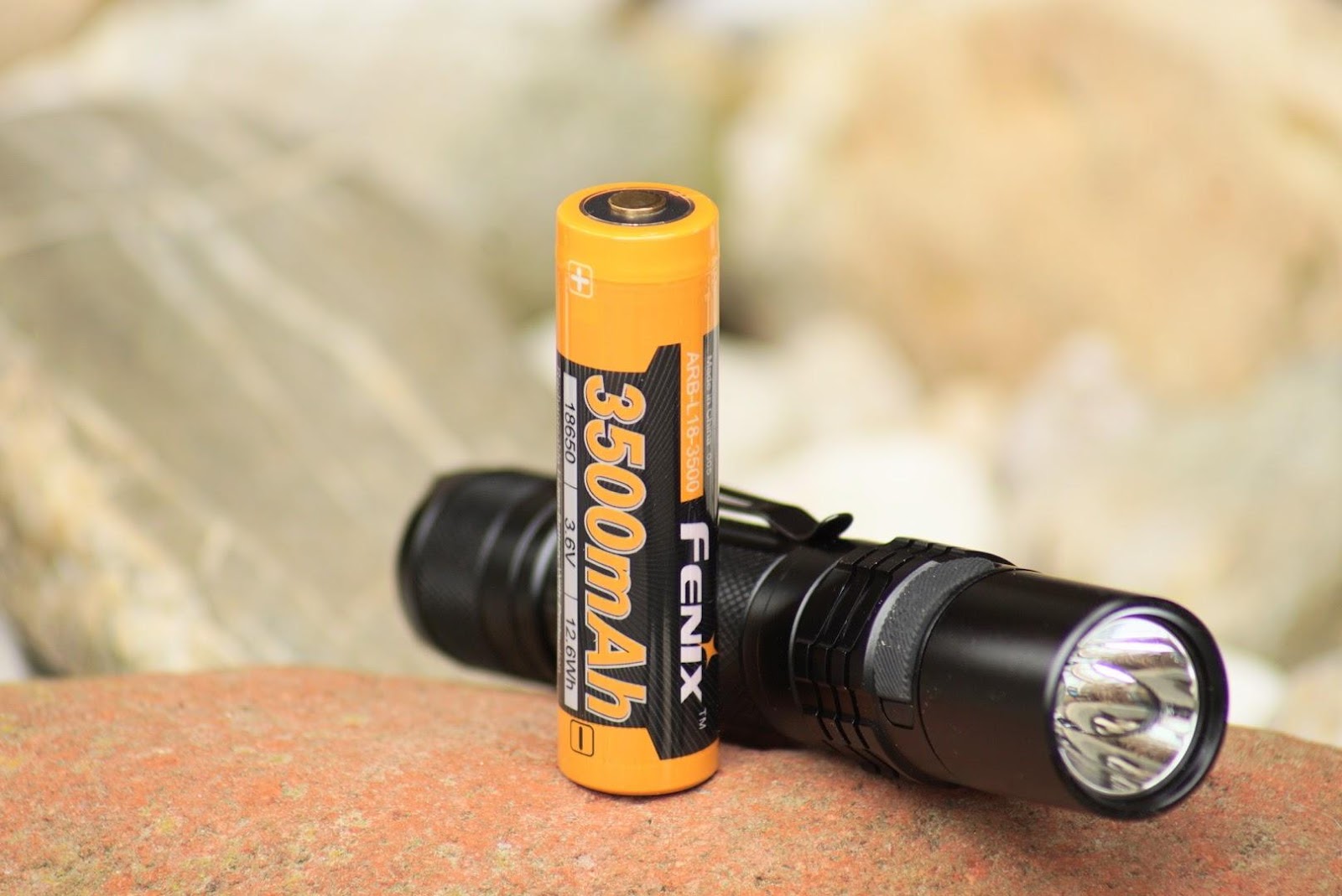

    pocket-sized tactical flashlight
    a long-lasting 18650-cell is included

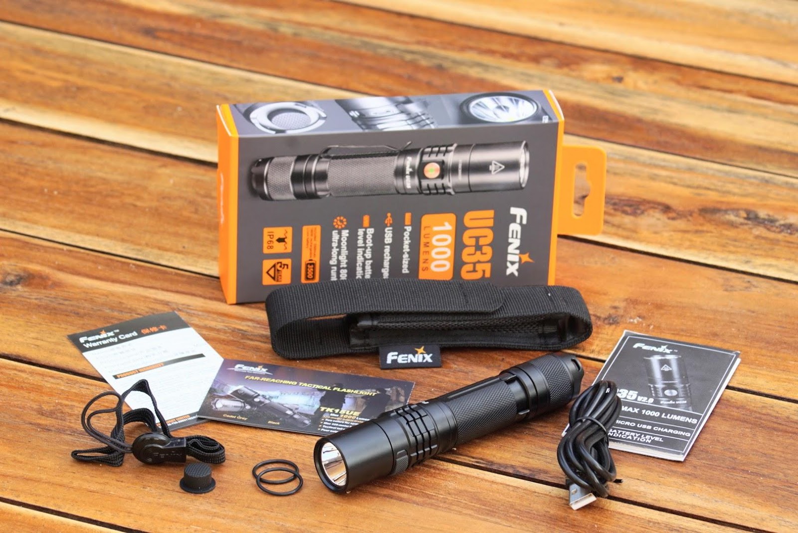

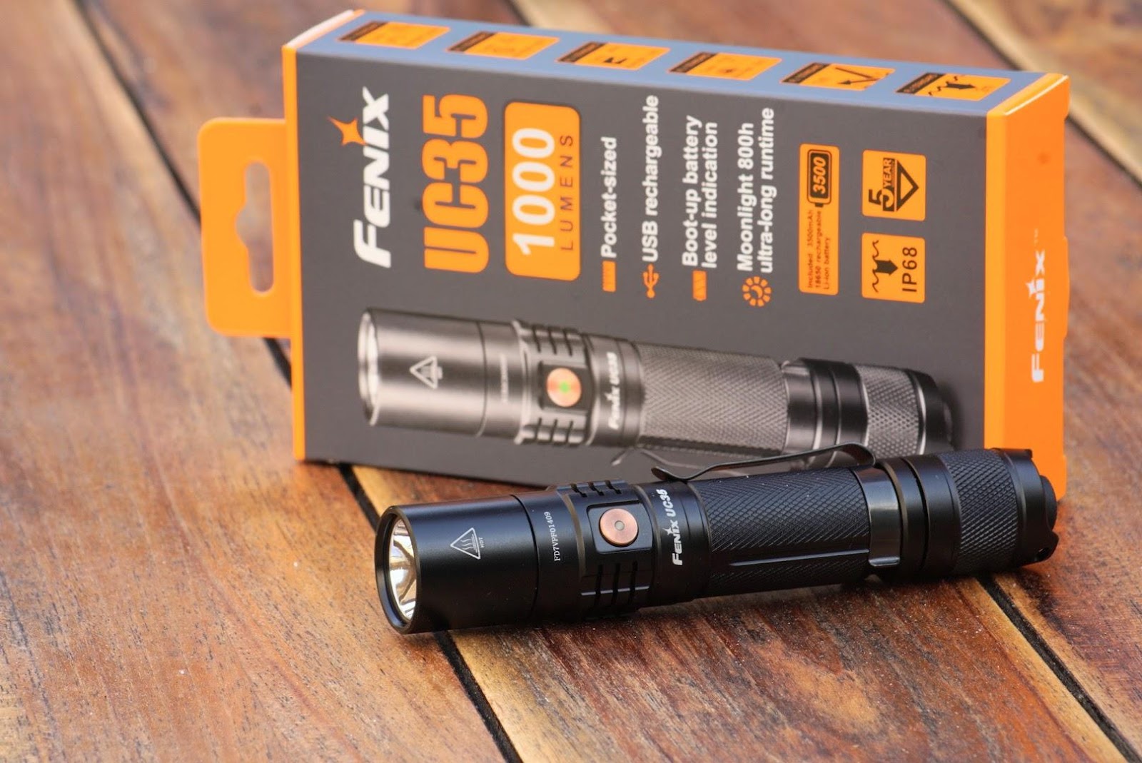

    The box of the UC35V2.0 is not surprise, it has the same style and looks of the actual Fenix-releases. A print and some main features on the front, application on the sides and the full features and charts on the back of the box. Beware that you don’t tear the flaps; I mostly picked a tool to open the box because I don’t like a torn out carton. Inside, a plastic container that keeps the UC35 in place, and most parts we need to use and charge the light. Because the battery and a charging cable is included in all Fenix UC-series, the only thing we miss here is a power source. So, a complete box; you don’t need an external charger; the UC35 V2.0 is almost ready-to-use! I captured some shots of the box and what’s in, please scroll down to watch!

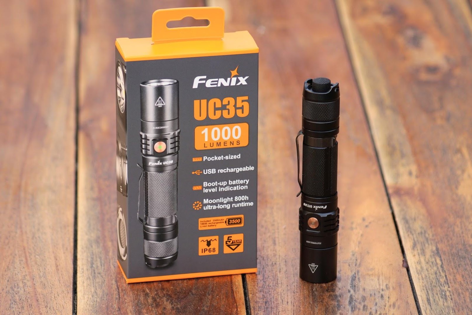

    another carton in “Fenix house-style”
    main features and a print on the front
    applications on the sides and full features on the back
    a plastic container keeps all parts in place
    unboxed: except a power source all we need is there!

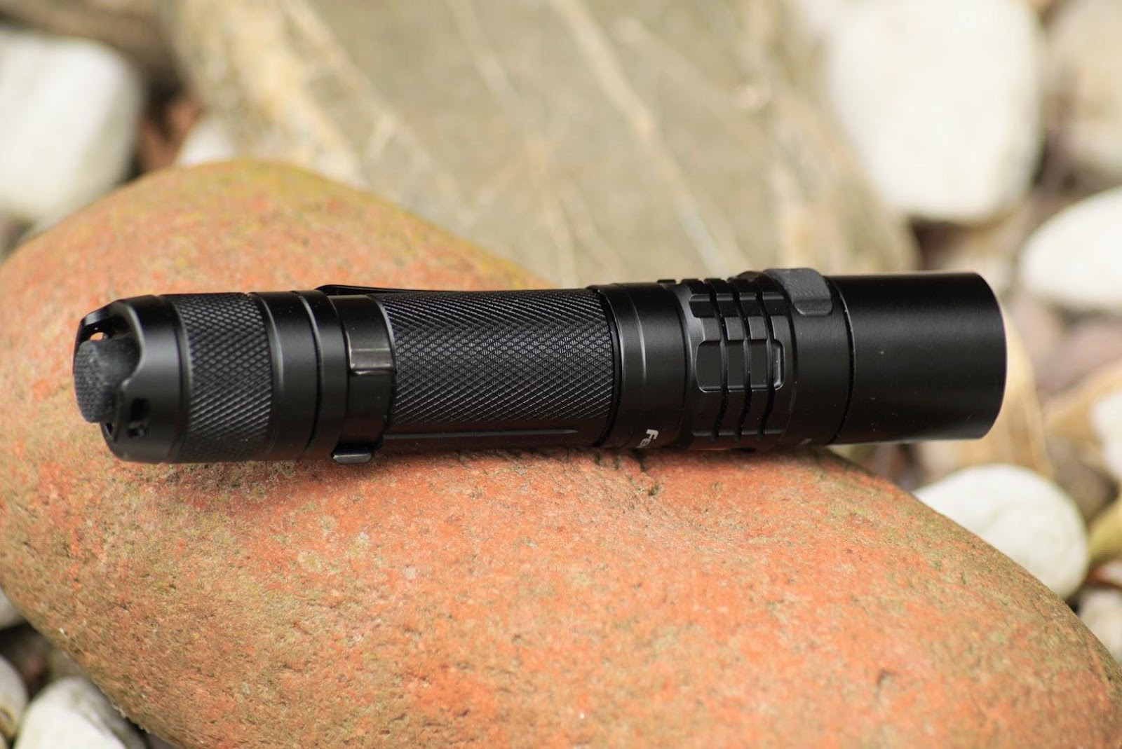

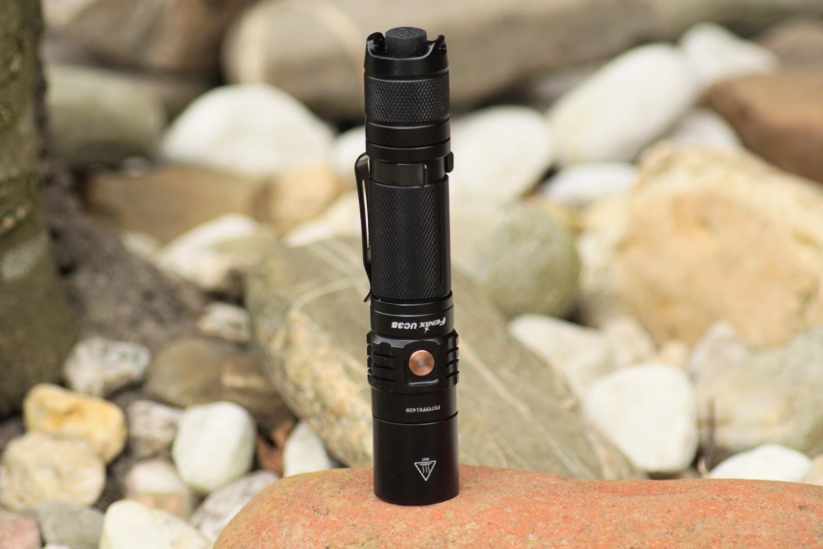

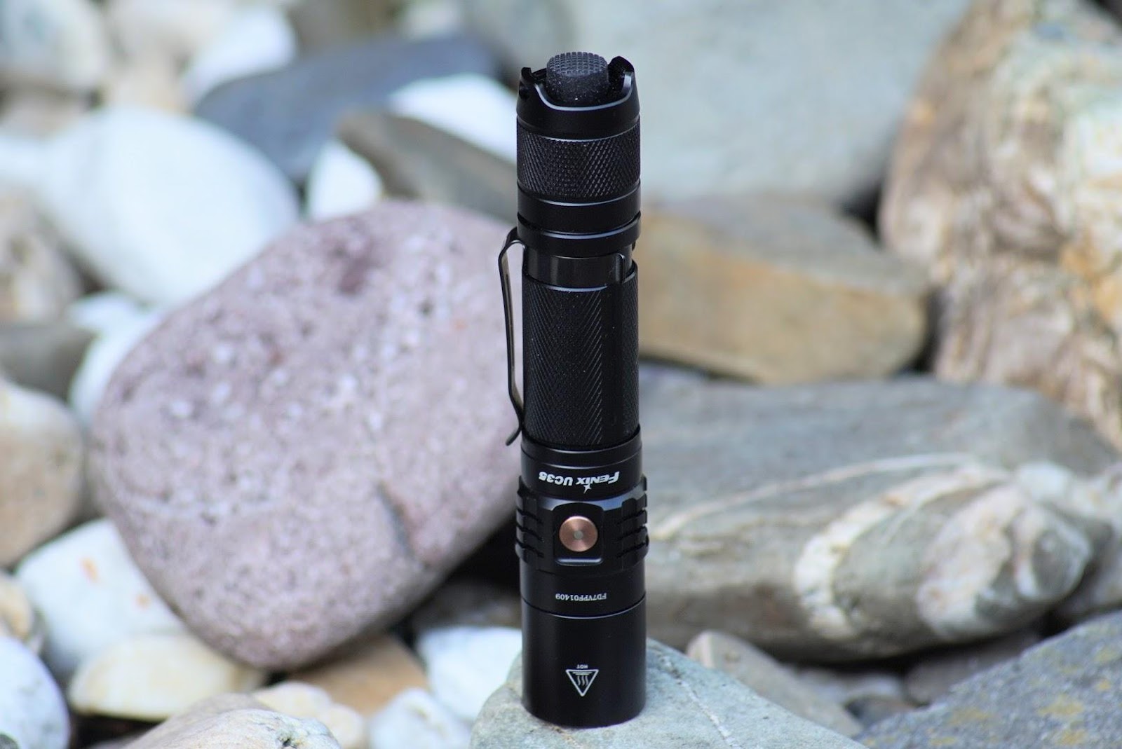

    Everytime when I’ve unboxed a Fenix light, I notice that all products of this manufacturer are of excellent quality. Same to the UC35 V2.0, the light feels robust and well balanced. It comes in matte black, maybe other colors will follow later. The anodizing-job is done well, the grey engraving is clear; and I’m happy that you can’t find too much information engraved on the body. As expected, the light can tailstand, but on the head it is stable enough. Thanks to the heads’ design it has an excellent anti-rolling design, which I really appreciate. Tactical lights like these are good to handle with, same to this one: Thanks to the sleeves and the fine body-texture, the strong clip and the design of the head the UC35 V2.0 can’t slip out of your hand. Looking into the lights’ head we see a rather deep reflector that keeps a perfectly centered XP-L HI V3 emitter. A plus of this led is that it will the light more throw than the previous led, but the beam won’t be to focussed. We’ll see this later in this review when we have a look at the beamshots. On the head we see two striking details: Eye-catcher is the renewed switch: This is a metal-one with “copper-look” and has a power-indicator in the middle. This switch is insensitive to rust and more resistant when the light will be used in heavy conditions. Above that, I like the looks; it gives the UC35 a more luxurious look. Second detail is the micro-usb charging port: it has inner water-proofing treatment. This means that you never have to worry or the cover is closed securely. A very big plus to the new version! The long and very strong clip keeps the light in place, it can only be clipped on at one way to the body. Looking at the rear we see a double lanyard-hole and the big rubber main-switch. When we disassemble the UC35 V2.0 we see that the light is made of totally three parts. The threads run smooth, but could have some more grease. I advise here to do it by yourself. In the tailcap a strong spring protects the light against shocks. Also inside the head, the body and the cap all parts are well finished. Therefore, at the end of this paragraph about my impressions of the light, I can be short in my conclusion: The UC35 V2.0 is excellent constructed and finished. More impressions and details of the light below; please scroll down to watch a couple of pictures!
    the Fenix UC35 V2.0 comes in matte black color

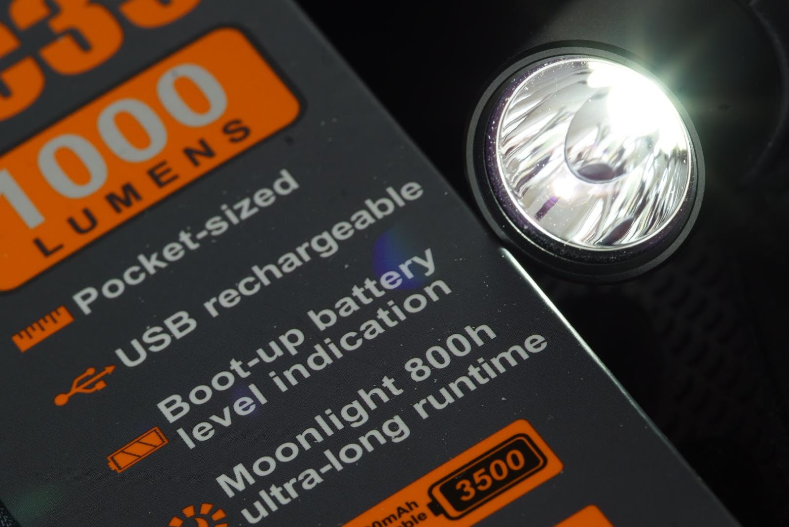

    a smooth and rather deep reflector
    a nice design that has a good anti-rolling function
    two battery-options: 18650 or two non-rechargeable CR123A-cells
    mid-sized flashlight
    good grip thanks to the knurling and the design of the head

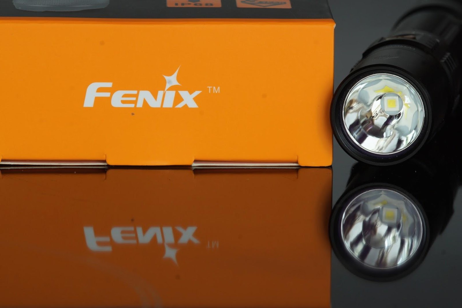

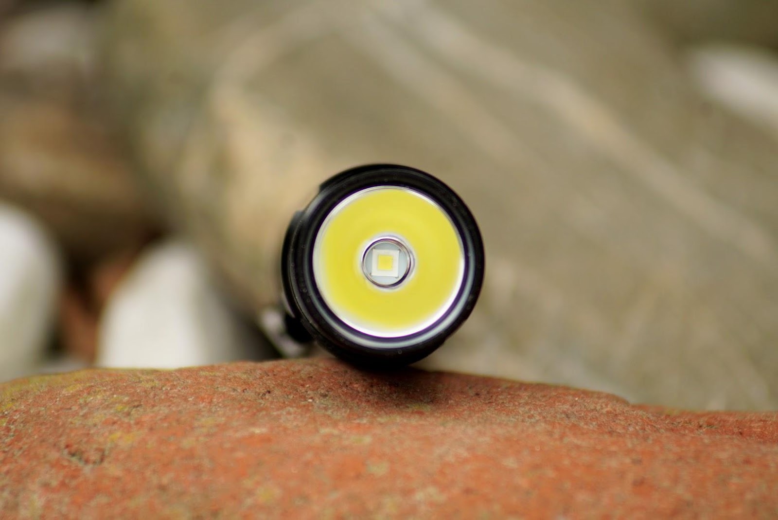

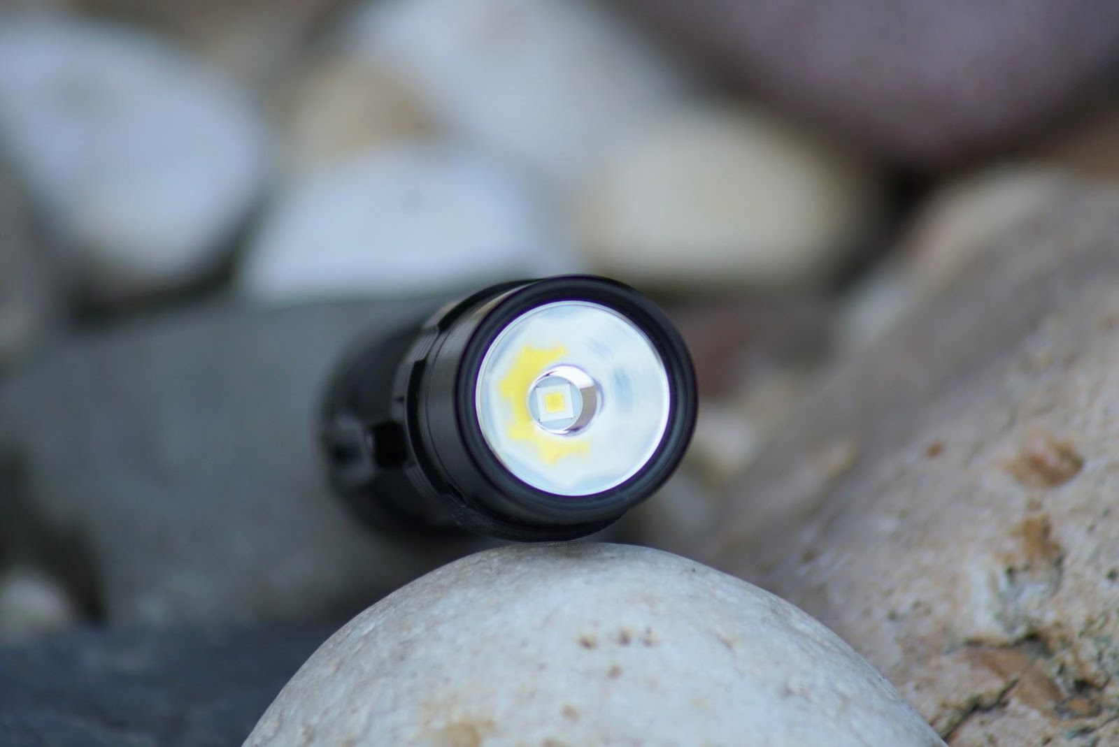

    the XP-L HI V3 led gives the light a nice combination of output and throw

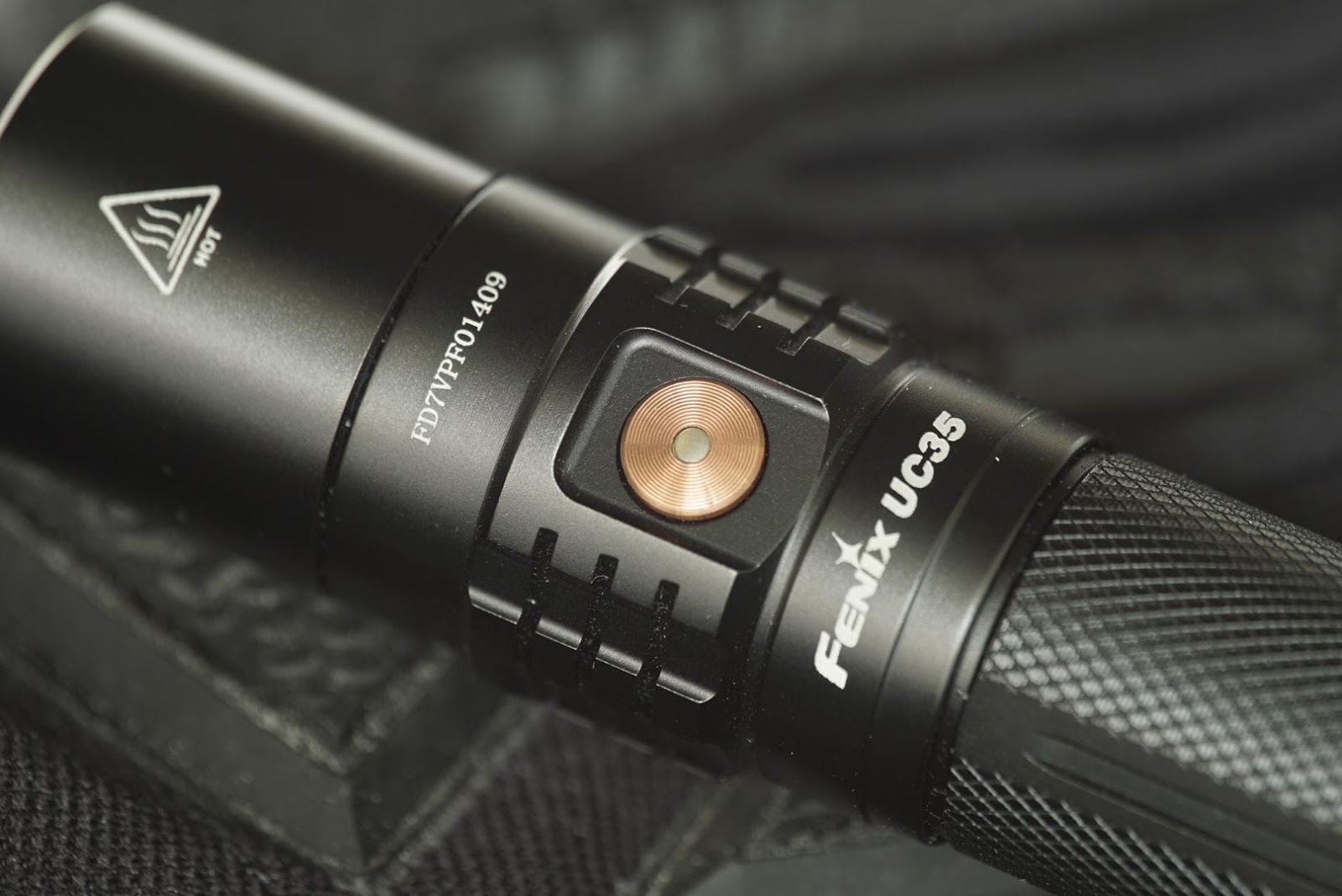

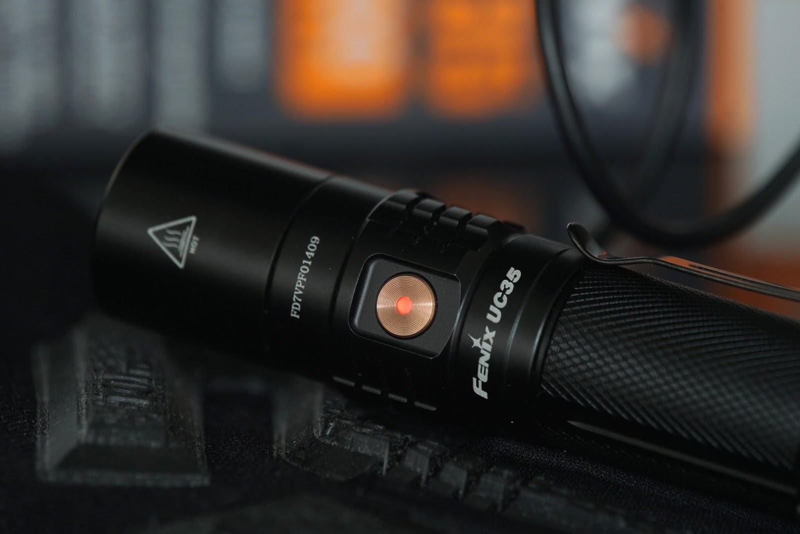

    the new metal switch: long lasting and anti-corrosion

    the emitter is perfectly centered

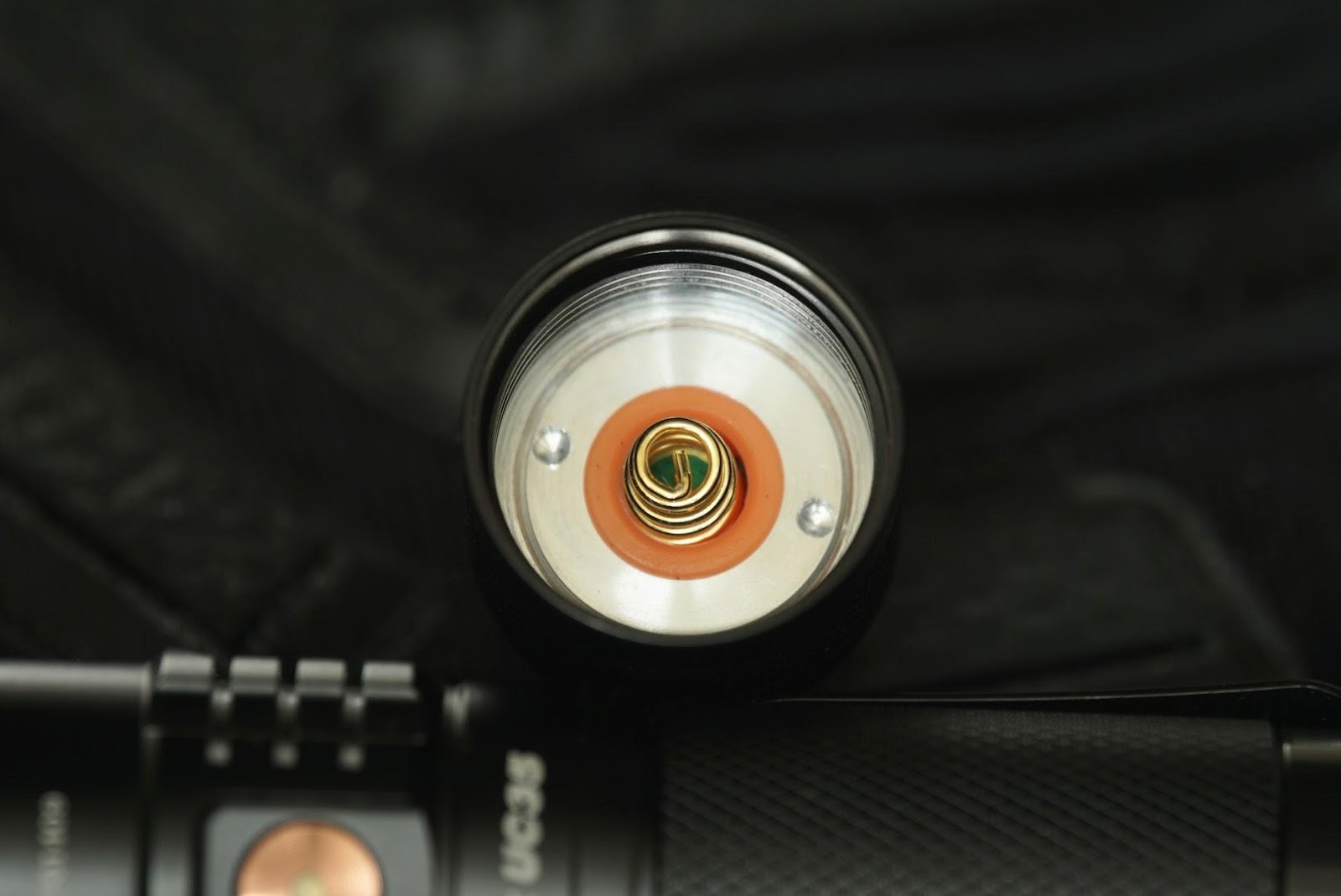

    a look into the unscrewed head
    a strong spring in the cap protects against shocks
    there’s a power indicator built-in the metal switch

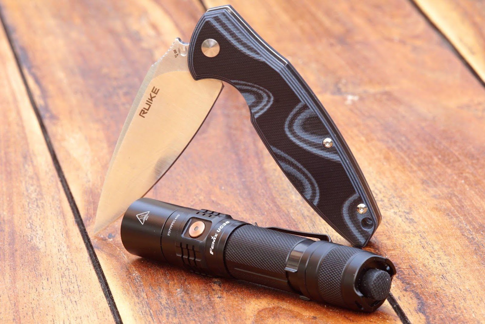

    together with a Ruike-knife, that is produced by the same manufacturer

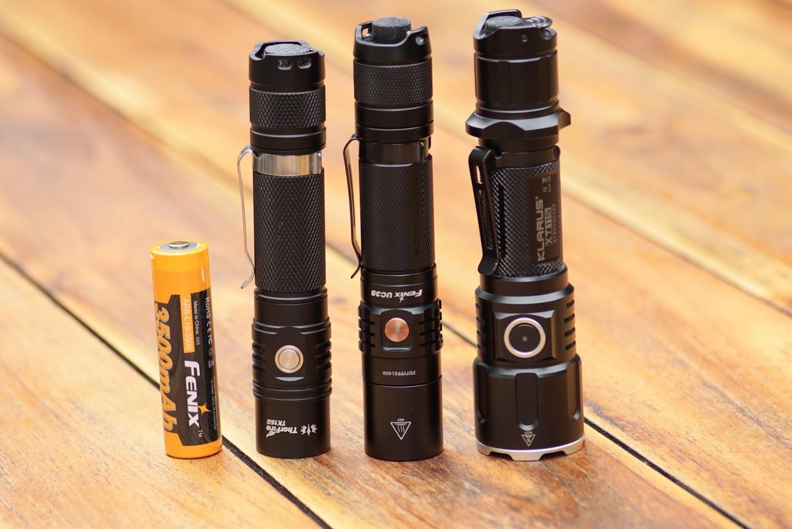

    For the comparison, I picked some lights in the same lumen-class. The led of the Thorfire TK15 is different, the Klarus XT11S is the larger one of the three and uses the same led as the UC35 V2.0. So, an interesting couple for my beamshots! Later in this review, I will show you the results!
    18650 battery, Thorfire TK15S, Fenix UC35 V2.0 and Klarus XT11S

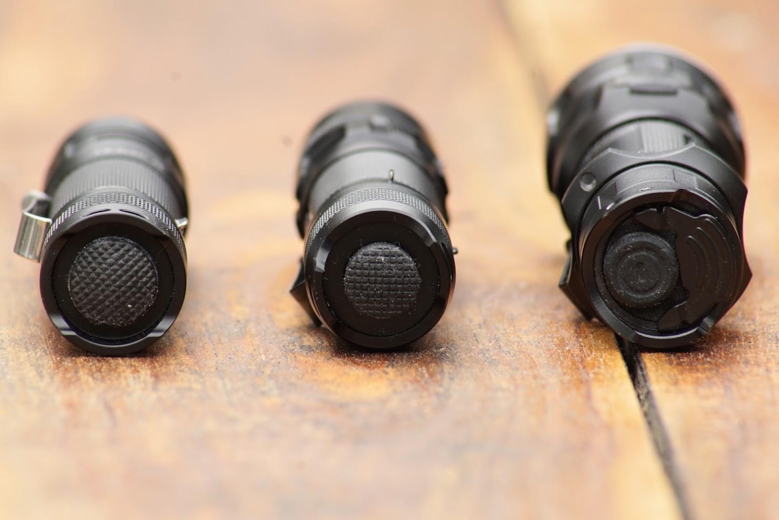

    the backs: Thorfire TK15S, Fenix UC35 V2.0 and Klarus XT11S

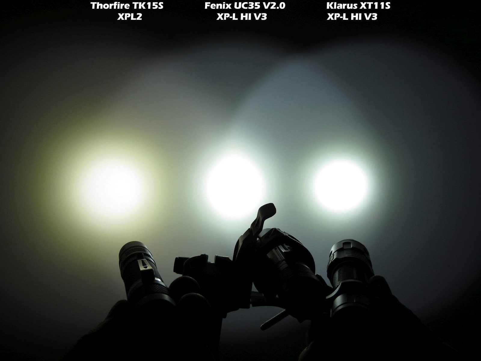

    Tint:
    When I did a quick check about the (coolwhite) tint I mentioned that it was pretty good. The photo below shows this: Compared to the others the Klarus shows more blue in the spill and the Thorfire has a yellowish blush. So to me, the tint is ok on the UC35 V2.0.

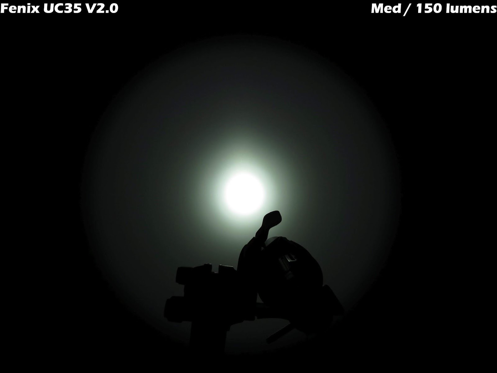

    The XP-L HI V3 is a led that gives good throw, but the beam is no to narrow. On the UC35 V2.0 in combination with the smooth reflector, you get a flashlight that reaches a good distance to its size. So, a good option in and around home on the lower modes, and one the higher modes a good solution for tactical use. We see a rather small hotspot, a medium corona and big spill. Later, when we go outside, I will show how this looks in real life. I couldn't detect PWM at any mode, which is a good point. I can tell you also that the beam is “clean” and free of defects.

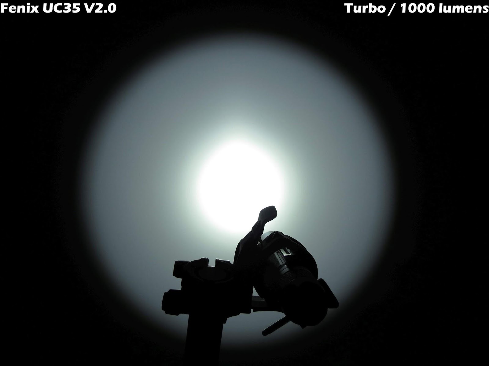

    Highest time now to see how this compact Fenix performs! Let’s have a look at a couple of beamshots that I took. First, I will show the five output modes with the beam projected on a white wall, followed by a GIF-animation. Distance to the wall is about one meter.
    Camera settings: ISO100, WB daylight, F/2.7, 1/125 sec, 35mm

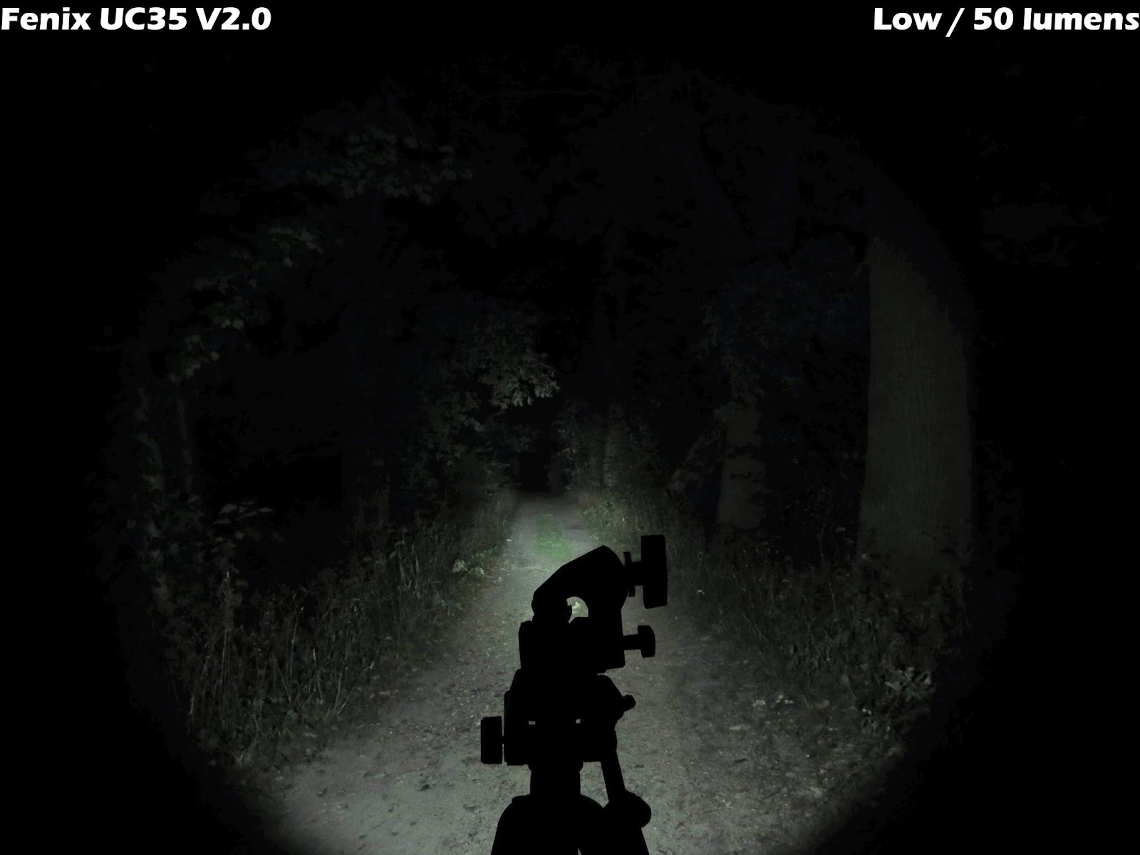

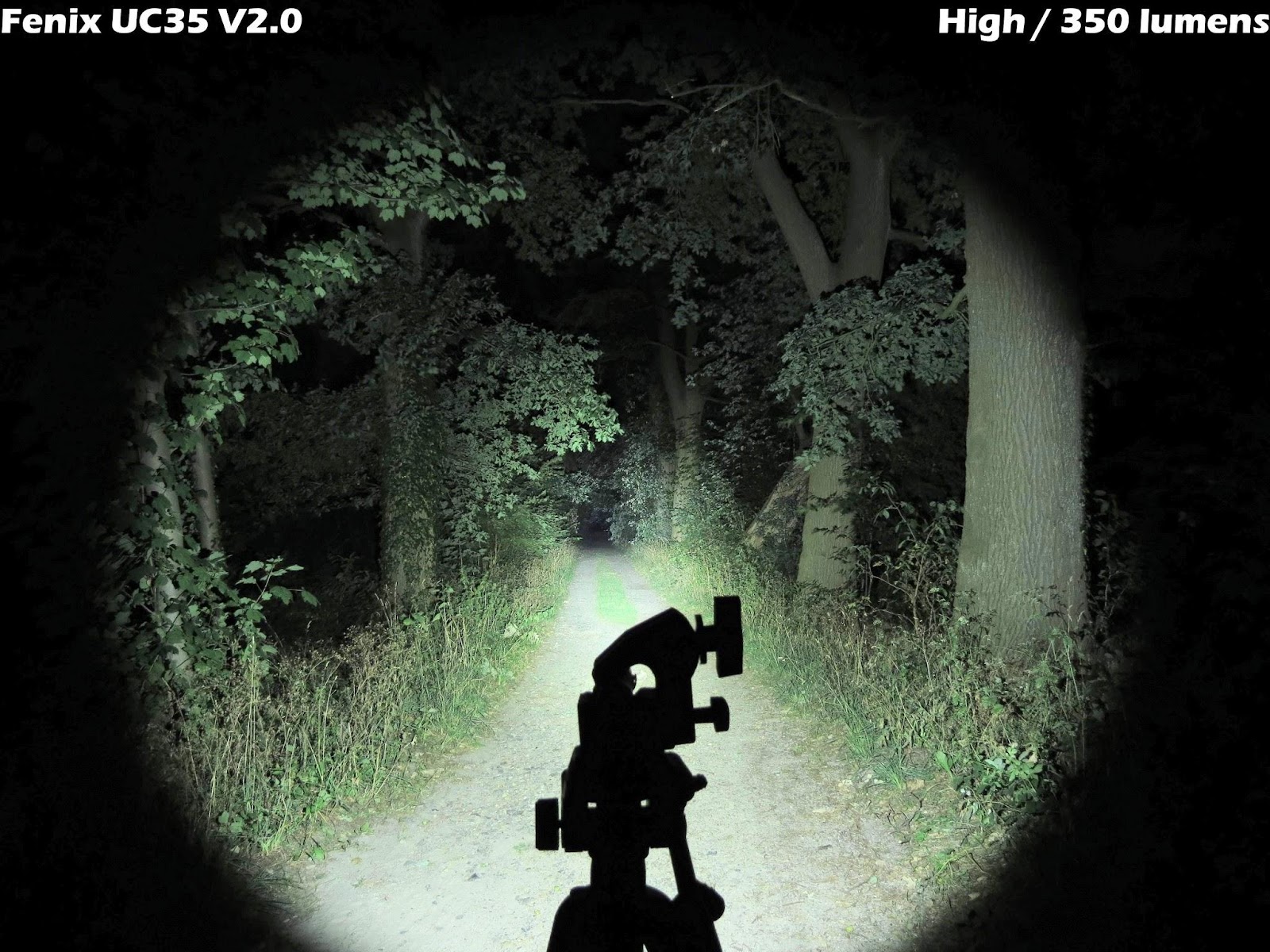

    Now, a look at the main thing that a flashlight is made for: Bringing light in the dark. The location is a dark forest here, I’ll show you the five levels of the light followed by a GIF.
    Camera settings: ISO100, WB daylight, F/2.7, 4 sec, 35mm
