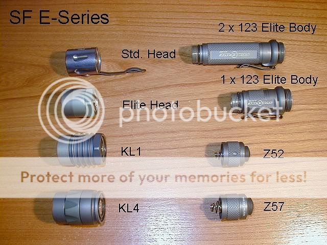

    1. Surefire E-Series parts ========================================
    - Elite 1x123 and 2x123 body with bezel-up clip
    - Std. 1x123 and 2x123 body w/o clip, not in picture, discontinued
    - Z52 LOTC
    - Z57 Clicky Tailcap with lockout feature
    - Elite Head with hex ring, accepts MN01, MN02, MN03
    - Std. Head with attached clip and tear drop marks, accepts the same lamps, but will not fit on elite-bodies and McLux bodies with installed ti-clip (because of the attached clip)
    - KL1 LED Head with a 1W HD LED (older models use a LD LED) and NX05 optics driven roughly at spec. Will run on 1x123 and 2x123. Well known mods replace the LED and / or optics and tune the driver for a more impressive output. Ask Chop, CM et al.
    - KL4 LED Head, the Head of the L4 flashlight. Runs on 2x123 and unregulated on 1x123 (combo is known as TW4 since Tactical Warehouse sold these first). Uses a 5W LED and a reflector for a flood-like beam. Best known mod is the McL4 by McGizmo that replaces the guts with a 1W HD on a BB600 for more throw.

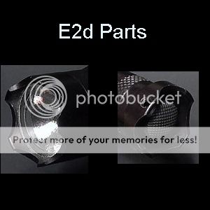

    - E2d-Parts: the new guarded tailcap and crenelated bezel with a domed lens. Never seen those in my hands though [img]/ubbthreads/images/graemlins/tongue.gif[/img]

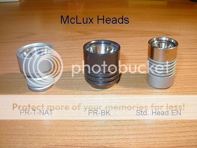

    - McLux Standard Head as on the initial Turnkey units. Accepts McFlood reflector, NX05 optix and NX01 optics and maybe Fraen LP optics.
    - McLux PR with the famous Pelican Reflector for optimum photon management with LEDs so far. Has massive heatsinking capabilities for 5W applications with longer runtimes.
    - McLux PR-T, a trimmed version of the PR-Head. Legend has it that the “T” stands for “Turbo” [img]/ubbthreads/images/graemlins/grin.gif[/img] [img]/ubbthreads/images/graemlins/evilgrin07.gif[/img]

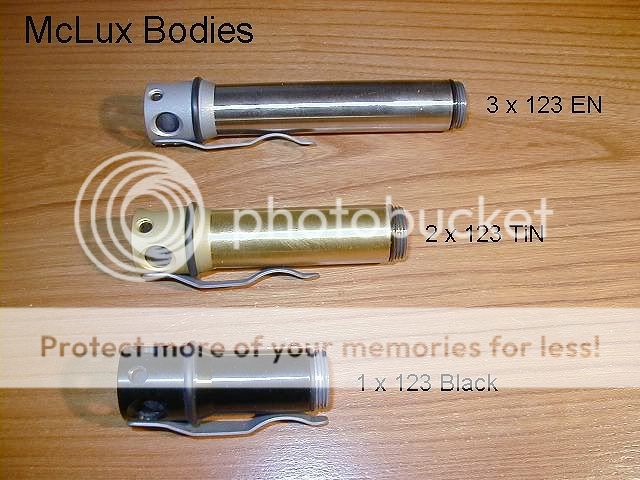

    - McLux Tails 1x123, 2x123 and 3x123 with a Kroll switch at the rear end and a multi-purpose switch guard as well as a bezel-down clip option.

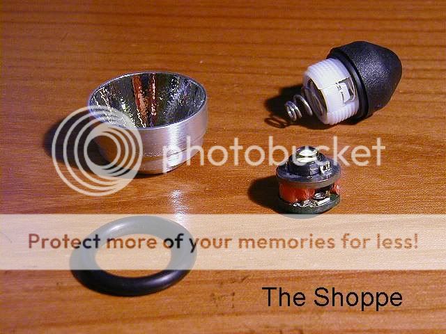

    The single parts and components to build your own McLux light are available at dat2zip’s sandwich shoppe.
    There you will also find the driver boards to make your light regulated (created by Wayne Y.):
    - BadBoy, a current regulated boost driver that can be ordered in various drive levels
    - DownBoy, a current regulated buck driver that can accept up to 4x123
    - Wizard, a buck-boost driver
    - MadMax, a voltage boost driver in various configurations

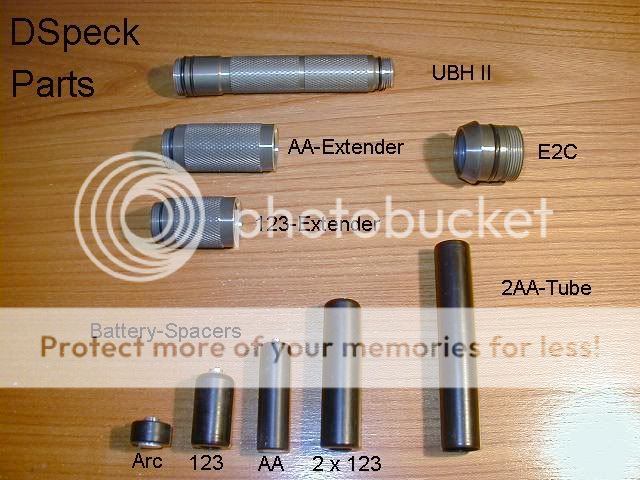

    - UBH (Universal Battery Holder); a 3x123 battery tube that accepts an E-Series compatible head at the front end and the appropriate tailcap at the rear end. Up to the UBH II the KL4 head will not fit!
    - Spacers for the UBH: there are battery spacers as shown in the pic as well as an Arc-spacer so that E-Series components may accept the Arc LS Head and a battery tube that allows 2xAA to fit in the UBH. Of course those spacers also work in other bodies just as well [img]/ubbthreads/images/graemlins/grin.gif[/img].
    - E2C: an adaptor that joins the E-Series bodies with the C-Series heads for even more possible combos. First made by McGizmo (see below)
    - 1x123 and 1xAA Body Extenders for E-Series compatible bodies, e.g. UBH, McLux.

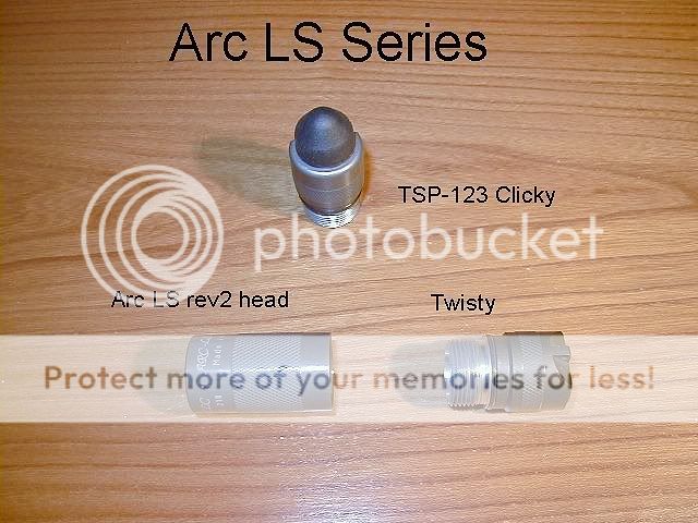

    The Arc LS1 and LS2 Head may be screwed on E-Series compatible bodies, but will only work with DSpeck’s appropriate “Arc-Spacer” to compensate for the length of the battery. This head will not fit on bodies with shoulders, especially the SF Elite bodies.
    The TSP-123 Clicky and P-123 Twisty may only be used with an appropriate adapter (see below) to make a very small E-Series Twisty.

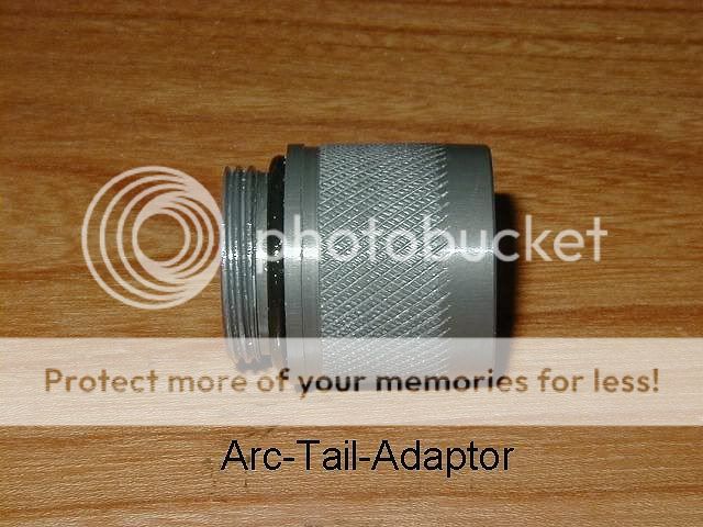

    An adapter to join an Arc Twisty (or TSP-123 if you are so inclined) to an E-Series body. Makes a very short E-Series twisty, watertight.
    This one is made by Rothrandir and works like a charm, jtice is being forced into making some more right now [img]/ubbthreads/images/graemlins/evilgrin07.gif[/img] while the original credits go to McGizmo.

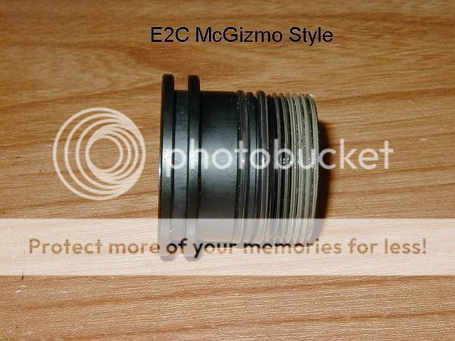

    E2c McGizmo Style, the original version of the E2C with 2 o-rings and a slightly different form-factor than Dspecks E2C.

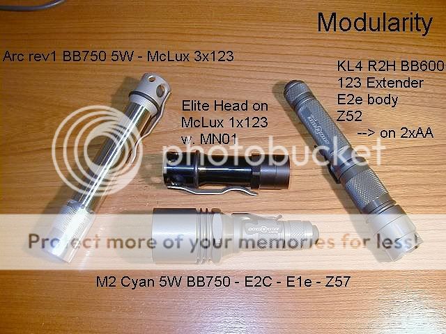

    Some Modular Examples:
    so … modularity is cool. [img]/ubbthreads/images/graemlins/cool.gif[/img]
    Almost all of my serious small lights fit in this modular concept right now. The more parts I got, the more fun I have [img]/ubbthreads/images/graemlins/party.gif[/img] …

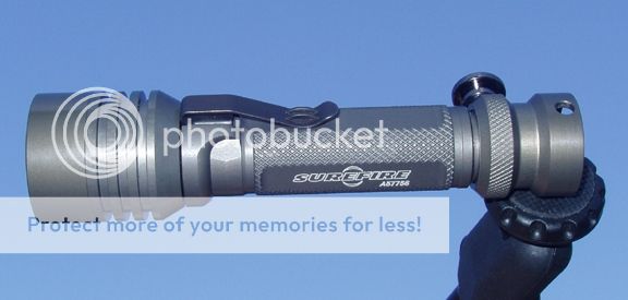

    Here is another example of the E-series Modularity: A composition that I call the E2-Defensless [img]/ubbthreads/images/graemlins/grin.gif[/img] Well, that's not really fair, as the LuxIII LED driven very hard makes for a great tactical defender too. It is really nice when the factory finishes closely match the modder's finishes. [img]/ubbthreads/images/graemlins/thumbsup.gif[/img]

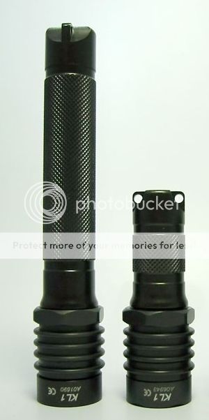

    I have an E2e gunmetal and the head has the tear drop look. Something about this setup appeals to people in a office enviroment. Maybe because the color and design doesn’t look "Tactical".
    The KL1 head is very versatile it works on 3,6, or 9 volts. When used with the Vital Gear bodies you can use 1x123, 2x123, 3x123 and 2xAA batteries. Very useful if you like to mix and match. Since the new KL1s seem to be using Highdomes I may have to get another one in the future.

    The available top of the line mod is McGizmo's L1-PR-T combo, runs on 2x123 with high/low switch for either 917mA or 70 mA to a LuxIII. Unfortunately this mod is destructive and ends the modularity of its components.
    If you want to stick with this platform a classical combo is BB500 Lux1 or Lux III on 1x123 or DB700 or 917 on 2x123. Of course the combos are endless, your pain to chose.
    Don's 2-stage-tailcap will bring a two-level switch to this modular platform, thus enhancing it for the future.

    [ QUOTE ]
    Kiessling said:
    If you plan your own custom light the McLux heads are the best choice since they are made to be customized with your choice of LED and driver. You chose brightness, beam characteristic and runtime.

    As an example, though, what sort of improvements in brightness and runtime can be aspired to with the McLux heads?

    no improvements over other solutions except that the PR reflector is the best photon managment device for LEDs right now. The important thing is that those heads are designed to accept diverse components (drivers, LEDs) to allow you to chose your personal combo. Of course you'd have to be able to build it or find someone who can.
    The overall quality is very high ... HA III, glass lens, o-ring sealed, perfect machining, ...
