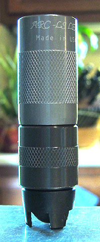

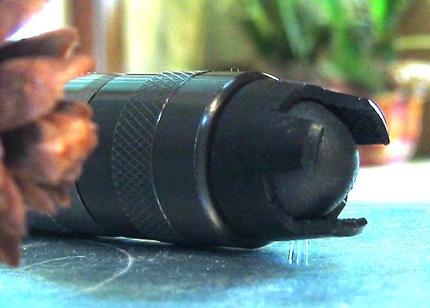

    Guys, thank you for all the kind words. [img]/ubbthreads/images/graemlins/blush.gif[/img] Bob's light was really nice, and I actually played with it (oops! TESTED it) [img]/ubbthreads/images/graemlins/wink.gif[/img] for a couple nights before sending it back. Just by dumb luck, I did happen to snap a couple photos before returning his light...
    Modded light, standing.
    Closeup of the Kroll stand.

    I realized that I didn't talk about one of the neatest features...
    Milky installed a cylinder of fairly stiff rubber around the rubber-covered portion of the clickie. On the outer end it has cutouts, kind of like the ones on the base of a VIP. The remaining tripod allows the LS to stand up on end without getting in the way of the clickie or the lanyard loop.
    The standup ring is functional, looks cool, and doesn't add anything to the overall dimensions. Great idea!
