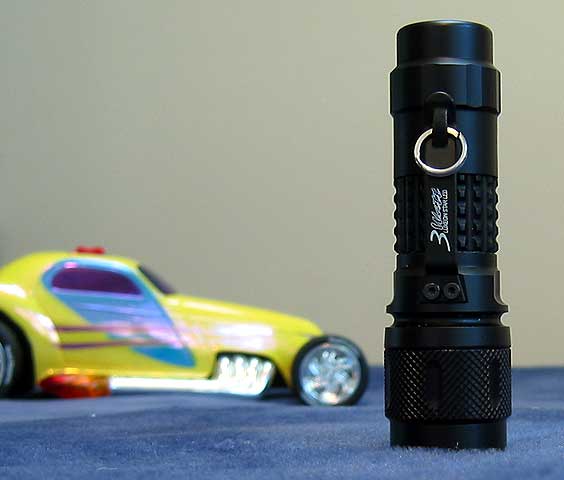

    Hey everybody! [img]/ubbthreads/images/graemlins/grin.gif[/img] Like so many fellow CPFers, I bought a Nuwai Quantum-III 1x123 light a while back, and while I thought it was a neat little light, I also found some things not to my liking... so naturally I began modding, heh heh... [img]/ubbthreads/images/graemlins/wink.gif[/img]
    Introducing... my pimped-out Nuwai Quantum-III! [img]/ubbthreads/images/graemlins/grinser2.gif[/img]
    Okay, well it looks pretty much the same as the UNMODDED Q-III. [img]/ubbthreads/images/graemlins/frown.gif[/img]
    In the interest of offering one example of what can be done with these things, here's a quick rundown of what I did, and why...
    1. Replaced the stock LuxIII star with an SY0J binned star, which runs at lower voltage than stock and comes closer to a pure white color. (The original star had a distinctly blue tint.)
    2. Replaced the stock boost circuit with a modified board pulled from a Dorcy 1AAA LED light, available for $5.94 at any WalMart. I've been using these boards quite a bit lately, both because of the low price and the easy availability. It does entail a little more labor to prep the board for use, though. Anyway, the board performs more-or-less like a MadMax, or perhaps MMLite and greatly increases the runtime of my Q-III over the stock board, plus fails MUCH more gracefully than the stock board did, with hours upon hours of lingering light that's bright enough to navigate around my house and find stuff in drawers. That's after 120 minutes of basically flat output, followed by 30 minutes of gradual dimming to the low output mode. Here's a runtime chart I did for my MilkMite mod, which uses the same circuit...
    3. Removed the switch from inside the tailcap, and inserted an O-ring to recess the rubber boot just enough for the light to stand upright.
    4. While the tailswitch was opened, I replaced the switch board itself with a dual brightness one from another Nuwai light, and replaced the resistance for the low beam with a 10 ohm resistor.
    5. Added a stainless steel split ring from Berkeley Point, to facilitate easy lanyard carry. If you look closely at the photo, you'll notice something unusual about the split ring: one of the turns is missing around roughly half the circumference of the split ring. I snipped it off! This was because the stock split ring was a little too thick for the attachment point on the clip. After snipping some of the split ring off, it now moves more-or-less freely up and down at the attachment point, and doesn't seem to lose all that much strength... certainly not enough to cause it to fail under the small amount of weight of this particular flashlight!
    The upshot of all this is a nice little light that can stand upright, attach to a lanyard, run for 2 hours at high brightness and STILL provide many hours of emergency light, and provide two levels of output: I measured the low output at 83 lux at one meter, and the high level output at 593 lux at one meter. That works well for me! [img]/ubbthreads/images/graemlins/smile.gif[/img]
    The point is, many mods are possible with this light. IMHO it's a great platform for modders! Yippee!

    Very nice! [img]/ubbthreads/images/graemlins/smirk.gif[/img] Didn't know the Dorcy boards were that useful...

    Very nice!! Can we get?? (fully completed?)
    Sep 2002
    New Jersey
    4,905
    Default Re: My pimped-out Nuwai Quantum-III
    Cromag, sure you can get one fully modded! The price will depend on whether you're supplying the stock light, or I'm buying one on your behalf, then modding it. I generally charge $20-30 for the labor, plus parts cost and other expenses. PM me if interested! [img]/ubbthreads/images/graemlins/grin.gif[/img]

    Nice mod Milky!
    Sep 2002
    New Jersey
    4,905
    Why thank you, Mr. Hotster! [img]/ubbthreads/images/graemlins/grin.gif[/img] Your blessing pretty much officially endorses my mod. Now all I need is certification from the great MR Bulk to seal the deal! [img]/ubbthreads/images/graemlins/wink.gif[/img]

    Sweet. How much does the tint change, with the Y0? I'm thiking about a PM...

    Pablo, the head unscrews at the point where the knurling stops, on the side closest to the clip... look closely and you'll see a seam there. It's Loktited shut, but you can break the seal with a couple pairs or pliers. However, make sure you protect the light itself with some rubber hose or something similar, so you don't end up with plier marks on the housing! [img]/ubbthreads/images/graemlins/icon15.gif[/img]
    Haesslich, the stock Q3 circuit and also the Dorcy circuit will both tend to shift the tint in the "warmer" direction, away from blue and toward green. Maybe the Dorcy circuit does so just a bit more, but it happens with both. Since Y0 is slightly on the blue side of white, this downshift moves the tint CLOSER to pure white. Hope that helps.

    With the 2-stage switch is it still a clicky? Guessing that it's a click on High (or low) & click again for Low (or high). Pls. PM me a break down cost for a complete modded light. Thanks. [img]/ubbthreads/images/graemlins/smile.gif[/img]

    Flashlight, the replacement clicky has three states: off, low, high. Put another way, when the light is off, click for low, click again for high, and click a third time to turn off.
