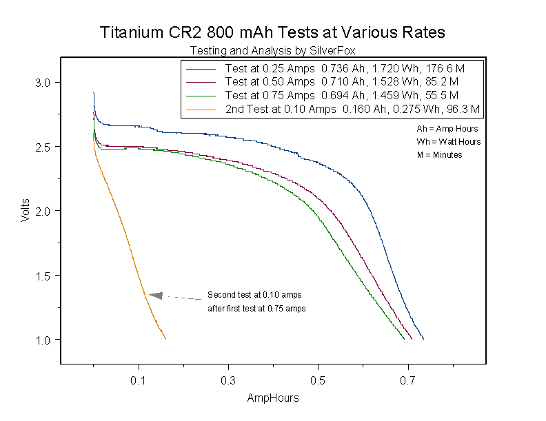

    People have been asking about CR2 cells. I don’t use them, but happened to come across some Titanium CR2’s, thanks to Wayne at AmondoTech. I believe these are rated at 800 mAh.
    Here is the data.
    You may wonder why I did a second run on the cell that had previously been tested at 0.75 amps. HarryN is developing a CR2 light as are some others. These lights can operate at different levels. It just happens that Harry is thinking of a turbo mode at 700 mA, and after running the test at 0.75 amps, I noticed that the voltage had rebounded back to 2.8 volts. It struck me that it would be interesting to see what happens if you do another run at a lower draw. This means that you can run the light in turbo mode until the batteries die, wait 20 minutes or so, then still have usable light at a lower level. In this case the turbo mode lasted a little over 55 minutes, after which you still had over 96 minutes of run time at 0.10 amps.

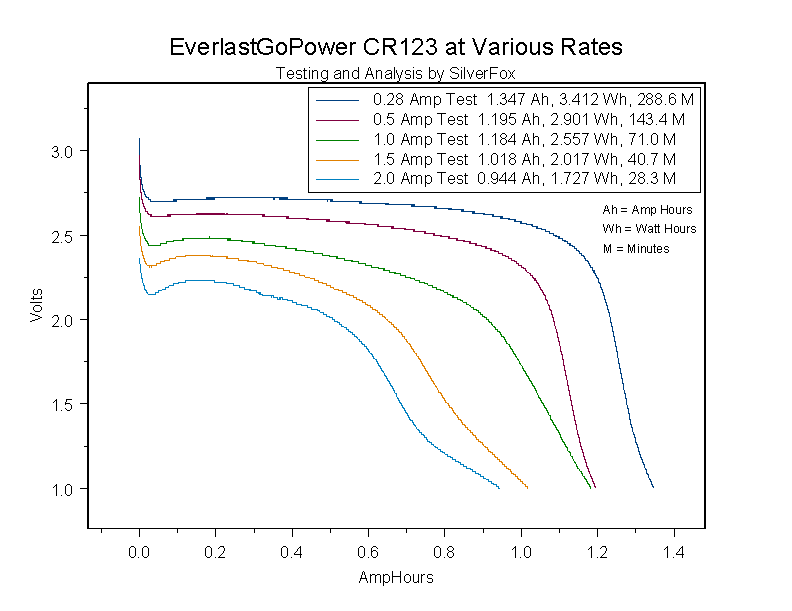

    Here are some Everlast Go Power cells that VWTim picked up for me to check out. At $0.99 each, they seem to be solid performers.

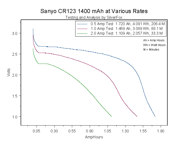

    It seems that Sanyo has some CR123 cells that are being made in China. I have been sent some of these cells for testing and it appears that they do not perform as well as the ones made in Japan.
    Here are some graphs to compare...
    Sanyo Made in Japan
    Sanyo Made in China

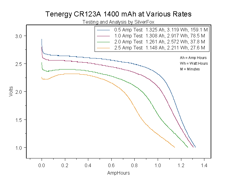

    Vew sent me some Tenergy CR123 cells to test. Thanks.
    I checked them on the ZTS tester and got mixed results. Out of 10 cells, 8 showed 100%, 1 was at 80% and 1 was at 60%. These results are from cells that tested at 100% on the ZTS tester. The cells seemed to perform quite well.

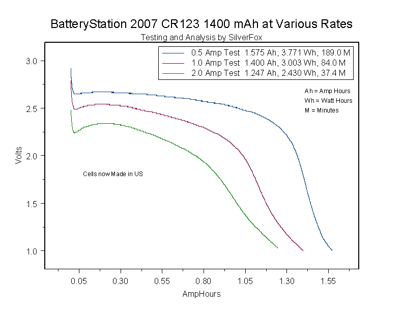

    Kevin at BatteryStation sent me a box of his new Made in USA CR123 cells. Not only are then very strong performers, but they are consistent from cell to cell. The cells tested at 2 and 2.5 amps got over 140 F right at the end of the test, but I figure most people will not use a cell down to 1.0 volts in a continuous run.
    Here is the graph.

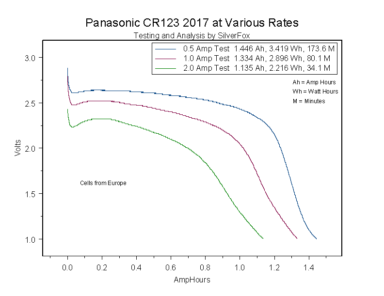

    The Panasonic cells had a 2017 date on them and were strong performers. They even performed well at a 2.5 amp draw, but since I only had one cell to test at that rate, I didn’t add a graph for it.
    Here is the Panasonic 2017 graph.

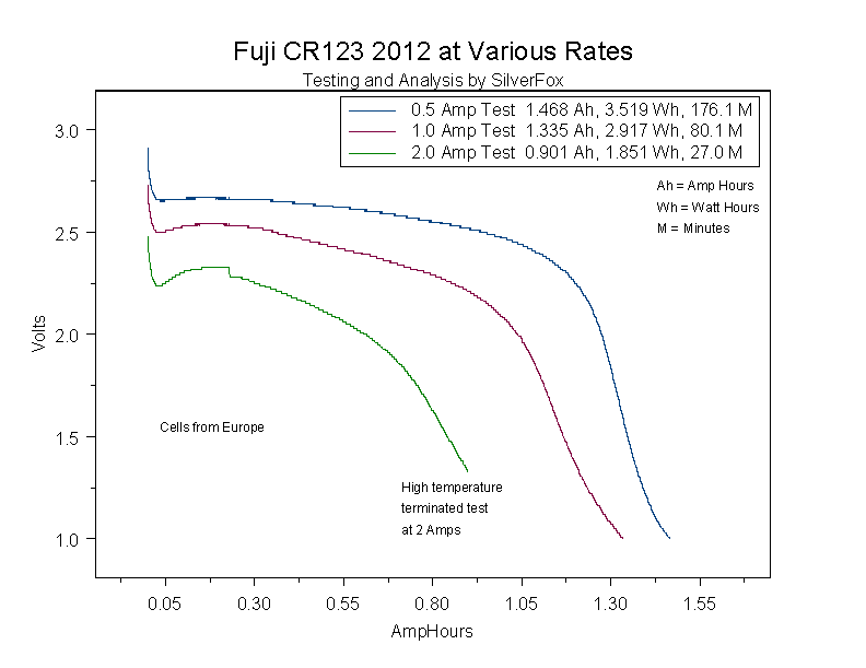

    The Fuji cells had a 2012 date on them. They did well at lower discharge rates, but exceeded the maximum temperature (140 F) during the 2 and 2.5 amp discharges. The discharge curve at 2 amps also has a little dip in it suggesting a little higher internal resistance.
    Here is the Fuji 2012 graph.

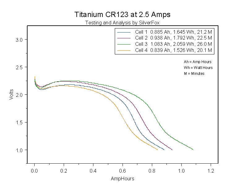

    The Titanium CR123 cells have had some problems. There was a bad batch that was supposed to have been removed from the market, however, I keep hearing of people ending up with cells that won't pass a ZTS test at 100%. I ordered 12 cells and they all checked out OK on the ZTS tester. Here is the test results at 2.5 amps.
    I must add that the battery manufacturer of the Titanium cells does not recommend using their cells at this high a constant current draw. I believe they also caution against using their cells in higher than 3 cell lights.

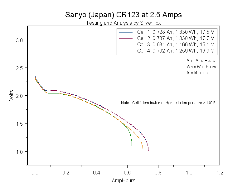

    Here is the results from the Sanyo CR123 (Made in Japan) cells. We have found that the Sanyo cells made in China seem to have around 10 - 15% less capacity than those made in Japan, but at this high rate, I wont speculate a guess as to how well the made in China cells will do. I don't have any of the Sanyo cells from China, so I can not do a direct comparison. We will just have to speculate...
    If anyone has 4 Sanyo CR123 cells they would like to send me, I would be happy to include them in this test. PM me for shipping information.

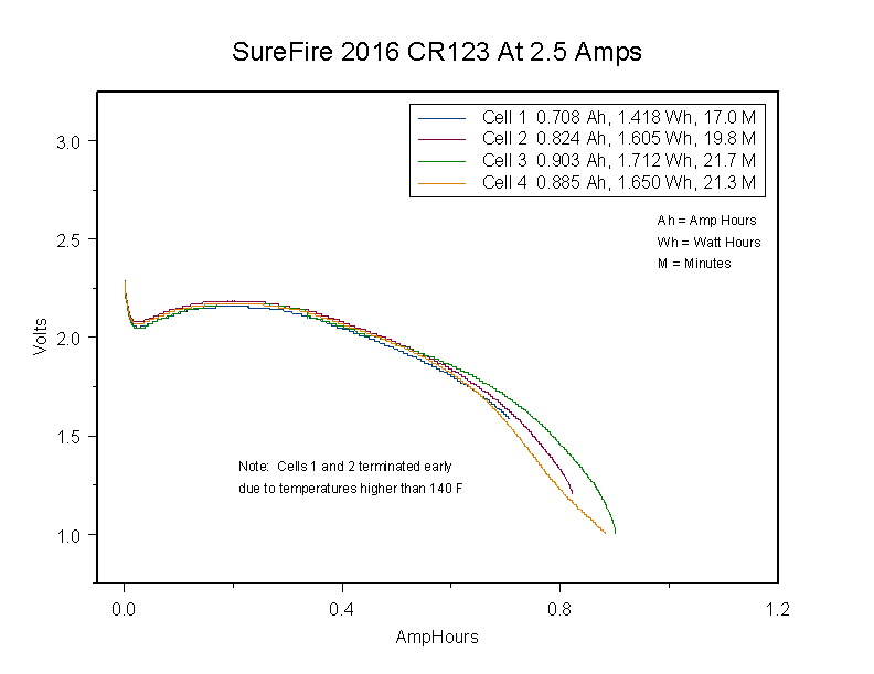

    Cell 1 terminated early due to high temperature. All four cells hit over 140 F, but cell 1 hit it a few seconds before it hit the low voltage cut off.
    Sanyo also does not recommend using their cells at this high a constant current draw.

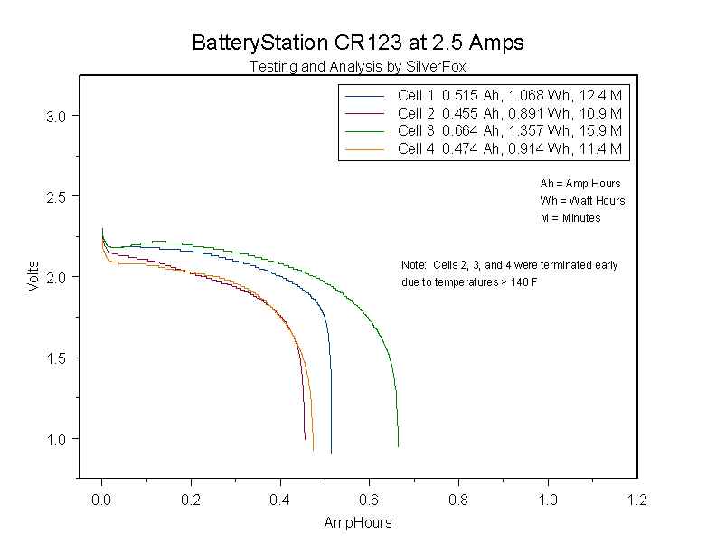

    BatteryStation has been a long time supporter of CPF, and many use their cells. Kevin has worked with the manufacturer to give us good performance and still offers a discount price for the members of CPF. Kevin has gone the extra step of individually testing each cell with the ZTS tester in an effort to add another layer of quality to the cells he sells.
    I asked Kevin about testing the BatteryStation cells at 2.5 amps. He does not recommend his BatteryStation cells in applications that draw 2.5 amps continuously. As a matter of fact, Kevin provides a box of 12 SureFire cells free with every SureFire M6 that he sells. He stated that if you are going to continuously use a light that draws that high a current, you should use the batteries recommended by the manufacturer of the light, and let them worry about any liability issues.
    Kevin also mentioned that BatteryStation cells are continuing to change. His next batch of cells have all stainless steel construction and, I believe, a new PTC. These are safety related items and will probably not impact performance in any way. Kevin went on to inform me that in the rare event of a "venting with flame" incident, a stainless steel can will not ignite where the aluminum possibly could get hot enough to ignite.
    I have also heard a rumor that BatteryStation cells may no longer be made in China in the future... perhaps they may even be manufactured in the US.
    Here are the test results of the BatteryStation cells at 2.5 amps. Note that cells 2, 3, and 4 terminated early due to the temperature exceeding 140 F.

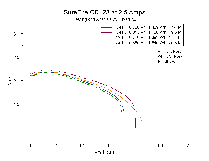

    SureFire recommends using their batteries in their lights. I guess this means that the SureFire batteries are manufactured in a way that evens out the tail end of the discharge curve. Many people have questioned SureFire about running the M6 for a constant 19 minutes, and have been repeatedly told that it is OK to do that. Here is the SureFire CR123 data.

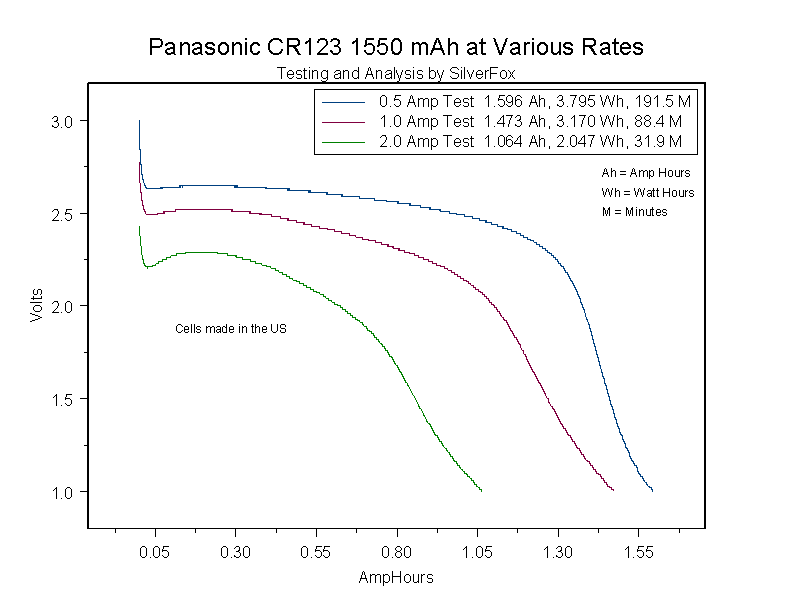

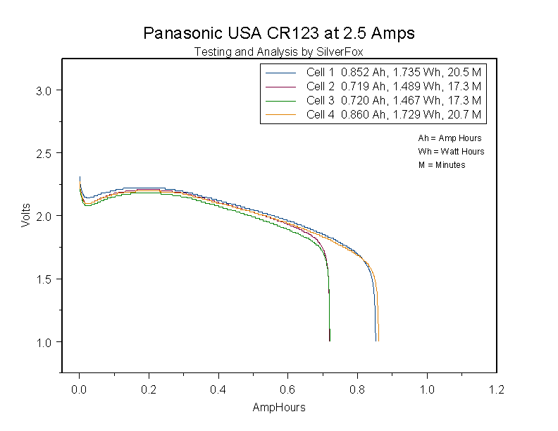

    Here is the data from some Panasonic CR123 cells that were made in the USA. These were individually packed and it looks like I got two separate batches.

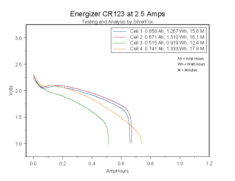

    Here is the data from the Energizer cells. I don't know what happened to cell 3, but it seemed to behave differently.

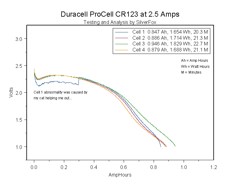

    There has been some discussion that Duracell Pro Cell and Ultra CR123 cells are the same. Here is how they perform under this 2.5 amp load.
    First the Pro Cell test data.

    Bill Waites wondered if a different batch of SureFire cells might behave differently under these high loads. The cells I tested had a 2013 date on them and he had some that had a 2016 date on them. He sent me 4 to test. Thanks Bill.
    It appears that these are pretty close, but 2 of them got hotter than the other two.
    Here is the data.

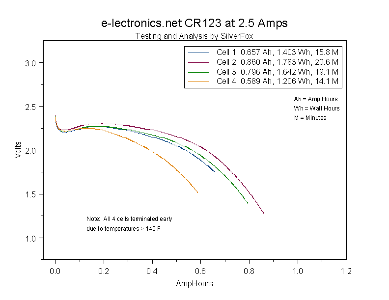

    CPF memeber Markcm sells CR123 cells from his web site at e-lectronics.net. All 4 of these cells terminated early due to temperatures exceeding 140 F. In spite of that, they seem to be strong performers.
    The new BatteryStation cells did very good during the normal testing, so I thought I would give them a try at 2.5 amps.
    While they were consistent from cell to cell, they got hot. 3 of the 4 cells shown exceeded 140 F at the end of the test. I ran another batch of 4 cells, and all 4 exceeded 140 F. I ran a third batch of 4 cells and 2 of them exceeded 140 F.
    Performance is good, but if you use these in a SureFire M6, run the light continuously, and run the light past where it just starts to dim down, you can expect to have to deal with hot cells.
    Here is the data.

    The Duracells always produced curves more like the blue line.
    With any mod I did to my circuit, the Surefires and Energizers consistently underperformed the Duracells. I bought various cells from Safeway, Rite-Aid, Fry's, Sportsman's Warehouse. The Surefires were all marked 05-2014.
    The circuit I was using there is close to a NextGen 1000, but a little higher efficiency, since the ARC4 provides more room for components, I was able to take advantage of this room for higher efficiency enhancements.
    Personally, I feel a person would want to run cells from multiple batches from each manufacturer before drawing any hard conclusions. And if they are like any other manufacturing process, what you get one month may be different six months from now.

    Very nice results! Good to see that batterystation's hold up quite well -- have to send out the next order soon.
    Now we just have to find out what goes on with the Energizers, in light of the suspected Energizer/Surefire connection.
