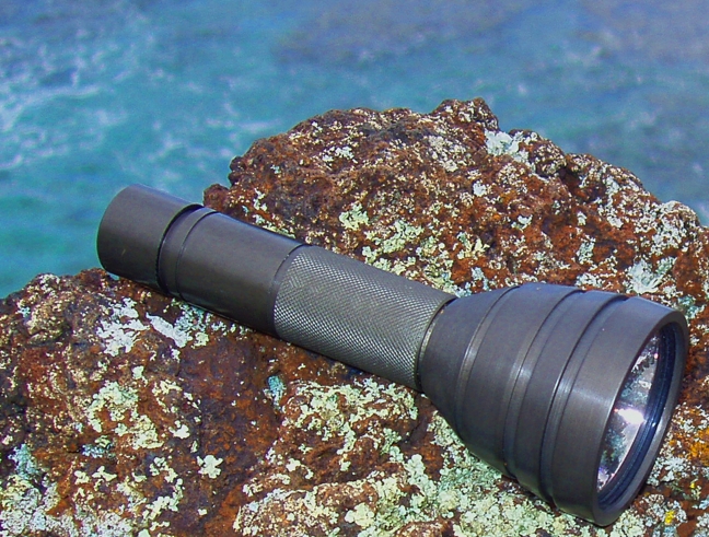

    I got a UY0J from Chris (Orb) and have it driven at 40/950 mA in a proto with a 45 mm reflector:
    Lux readings are rather impressive (8000+ on high - 1 meter) but possibly more important for considerations of throw might be the lesser degree of divergence of the beam when compared to the shorter reflectors (27mm & 38 mm) based on the same parabolic curve. In terms of illumination, it is likely more significant what you do with the light generated as compared to the amount generated. On low with this light for instance, if I recall correctly the lux was somewhere around 700 at 1 meter. However, at a distance, the beam from the 45 mm reflector had better return or illumination than other lights having a greater lux reading at 1 meter.
    Relative size of beam to target, typical distance to target, levels of ambient and depths of shadow; these are all real world considerations and flux of the LED is just one consideration in many. Certainly having more at your disposal is better than less, in many cases, but.....
