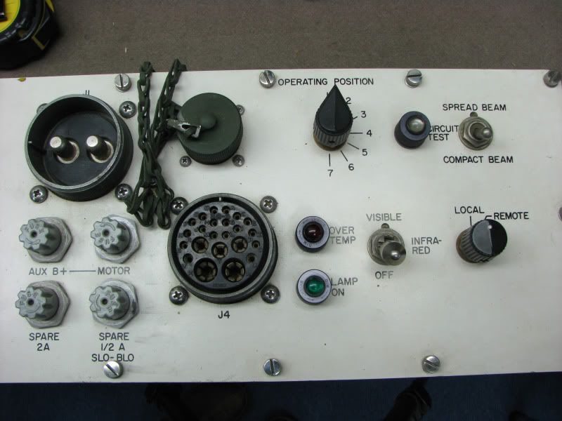

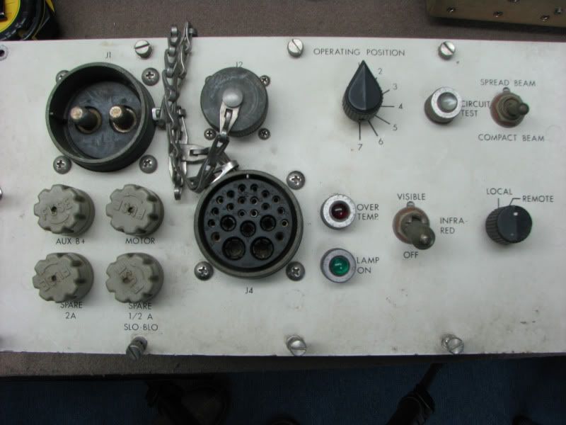

    A good ol thread revival from not too long ago. I found a second VSS-3a control box for my second light. Although they are both control boxes for the VSS-3a and not the earlier VSS-3, there are some subtle differences I find interesting.
    Smaller fuse holders, don't look as weather-proof at the sealing surface.
    Although all words are identical on both boxes, on Box A, the type is bolder and easier to read but not as sharp.
    BOX A
    Larger fuse holders, look more weather proof at sealing surface.
    Same words, but less bold, but sharper type.
    BOX B

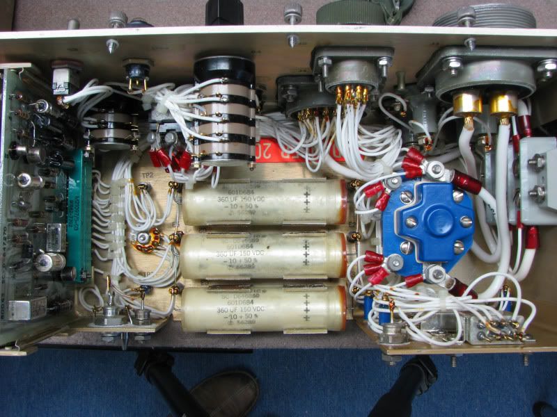

    Box A blue relay faces 180 degrees opposite of Box B and wiring paths are different.
    Two stack switches in Box A are fully enclosed.
    All solder joints are covered in flux residue.
    BOX A

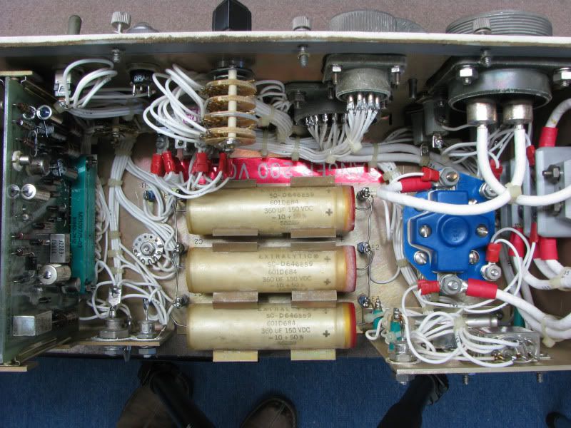

    Box B blue relay faces 180 degrees opposite of Box A and wiring paths are different.
    Two stack switches in Box B are open frame.
    No solder joints have flux residue visible.
    BOX B

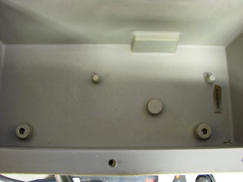

    Box A has no secret surprise! Not even the screw hole has been drilled & tapped. The clip insertion slot is not milled.
    BOX A

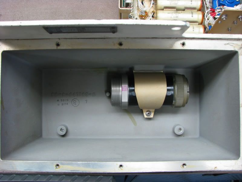

    Box B has the secret surprise! I am guessing it is a testing adapter that hooks up to some type of testing machine. The end with the round nut is threaded to fit on the box and the non-nutted end is the thread that is on the light - the odd-ball thread from everything else.
    BOX B
    Overall, I'm guessing Box A is a newer generation controller with improvements. It has sealed stack switches and the wiring path looks like it would incur less chance of wire chaffing and that may be why they re-oriented the relay. The circuit boards look identical. Box B SN is 4xx but unfortunately, I can't find the flange I took off when I mounted Box A to the tripod so I don't know its' SN. The presence of the testing adapter could be interpreted either way. It's there because it's a new and easier way to test and repair the light or it was never needed and eliminated and that's why the raw castings for the bracket are still there but not machined. I think the latter.
