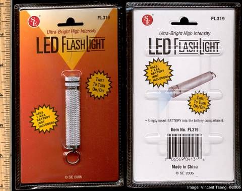

    I just got one of these, and I'm impressed....I've dropped it several times from a 3rd story landing, and chucked it as hard as I could against some concrete steps a few more. Minor cosmetic damage, and it forced the head in once (cross-threading it), but it's still perfectly functional. a bit of teflon pipefitter's tape helps with the loose threads.
    Arrow Re: 1xAAA chinese e-bay light partII
    Compared to classic ArcAAA (2003)
    1LED 1xAAA "clone"?
    The body is definitely steel - as it is strongly attracted by a magnet.
    balazer wrote: "I called Sona Enterprises. At least according to their description of their FL319, it sounds like it's this light. (single LED, AAA)"
    That's the model number on my packaging - and the "brand" seemed to be "SE" -
    see comparison with classic ArcAAA - 1LED 1xAAA "clone"?
