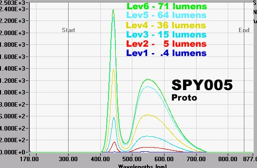

    Hi guys,
    I got one of these little wonders to ponder and test as well. Where to start.
    The engineering is superb, machine work imaginative and excellent; refreshing to be certain! The size and utility of this light is fantastic and only possible with the creative and sophisticated design that Dave has expertly brought to bear. Good job Dave but we all knew that already!
    The light works as one can easily intuit and the less than obvious means of cell replacement can be learned and appreciated in no time. As is, this pre production prototype is a work of functional art and could easily be considered finished and ready for production. Objectively there are no short comings or weakness or flaws to my thinking; power level settings aside.
    Subjectively and functionaly from my perspective, I would like to suggest consideration to a few points (motivation being that I plan to buy a back up as well as one for use so I would love to see the light more in line with what I want but I will defer to the artist )
    1) The volume knob works well with the milled castellated corner but I would like to see these recesses continue down the side of the knob if there is material to support removal in the area. It seems that the switch has significant detents so that AD would be unlikely even with the improved side grip.
    2) the milled lines in the side recesses look nice and interesting but I find they are incongruous with the rest of the light and in terms of grip, I think they would serve better if they were 90 degrees to the current orientation. I have fondled a piece that was without these lines and prefer the light sans these. If any grip detail were added for function at the cost of appearance or slick surfaces, I would like some parallel grooves in the radiused side of the light that the knob extends from, perpindicular to the battery axis. I find it comfortable and natural to hold the light in my right hand , as I would hold a narrow TV remote control; with my thumb and forefinger meeting at the knob. My thumb lays across the top wide side and middle and ring finger wrap around the knob side of the light with the pinky finger more curled and behind the light. The parallel grooves would then be under my fingers and impede the light sliding forward or backward. Such grip details would also aid in pulling the light out of a pocket or holster with the side detents giving grip on the wide sides. The light is just fine as is but I think I would prefer more control of the light with some enhanced griping edges.
    3) As Wilkey commented, 6 levels is more than needed but this switch is already part of the program and a great switch it seems to be!! If the levels are there, use them! Given the current levels of efficacy, resulting thermal output, size of light and optic, I don't think this light benefits with a drive level above 750 mA. I think it could suffer as a result of being used for any extended length of time in higher drive levels, especially if it is left to keep cool without benefit of being hand held. More on the levels later.
    4) This light is begging for a lanyard attachment and upon inspection of the light and using it some, I think I would like to propose and attachment point in addition to the two tapped holes on the side. It looks like there is plenty of material in the tail cap on the head side for a milled D ring groove that would follow the corner radius on the one side and the D's legs could go deep into blind holes in the tail cap. When snapped out of use, the D ring would sit flush in the tail cap and then it could pop up and lift to perpindicular to allow lanyard attachment and the light would hang bezel down. There could be a milled relief that would even allow for an attached lanyard cord loop to be present with the D ring dropped back in form with the tail cap. This would allow tail standing with lanyard attached.
    5) Initially I had some reservations about the choice of both chrome and the HA-Nat finish. I have been using a chrome plated light for a while now and am very impressed with it durability. The contrast in finishes is real easy on the eye and I think Dave has followed through with his form and into the finishes with the same flair of excellence. I think even a chrome tail cap would look rather smart and might even improve on appearance after some wear.
    Time for a picture!
    Ironically, level 1 at .4 lumens is very useful in the dark and it could be considered more than necessary if you are dark adapted. It hardly shows up on the graph above! Level 6 is the most blatant waste of energy I have ever seen! Even with the light pointed at a distant target you can not see a difference between levels 5 and 6. The difference is greater than 10% in lumens and where this 7 lumen difference is a waste and at the requirement of what, 300 mA of additional current, if these 7 lumens were available by themselves, they represent more light than level 2 which is an extremely useful level! I am not being critical of Dave or the SPY005 here and Dave has stated numerous times that the existing current levels were strictly and simply a starting point from which to get some data points. I think a big challange for Dave and Wayne will be in selecting some target levels and then seeing how close to target they can get. You don't just type in a number and presto, get it.
    I am sure I will have more peanuts to toss in here and it may seem that I have spent most of the discussion on changes or criticisims of what in closing I want to claim is one of the best and well thought out lights I have had the fortune of using and messing with! I think the photos and drawings give a rather impressive impression of this light. Handling and using it just add dimension to a favorable impression and it becomes a satisfying reality. Within it's scope and range of applications, I don't think there is a better light around. In so many ways this light is in its own class and there are no rivals.
    This light is small in size and large in performance and broad in range. It is well designed and executed and easy to master. This is not by accident. There is a very clever fellow among us who has brought a vision of beauty, function and inspiration to reality.
