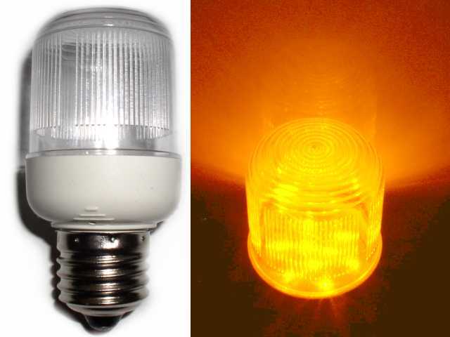

LED Small E27 Edison Lamp Lights, 9-LED "amber"
http://autolumination.com/images/auto_bulbs/7leda.jpg
--- LEDs are yellow
--- lamps and boxes inconsistently labeled yellow, or white; one handwritten 'amber' on box;
--- Assembled with low-temp "hot glue" -- circuit boards came loose after they warmed up in use; operated base-up, boards dangle into plastic cover. They still work.
These are salvageable, I can easily fix the little circuit boards in place. On the inside, the cases have ridges that look like they were meant to hold a slightly larger board than was actually used, so the boards were glued because they fail to snap in. Good argument for homebuilding, I guess. Or home modding. I can fix them and use them.
