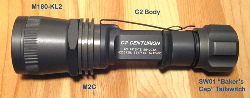

M180-Mag 2C Closeup

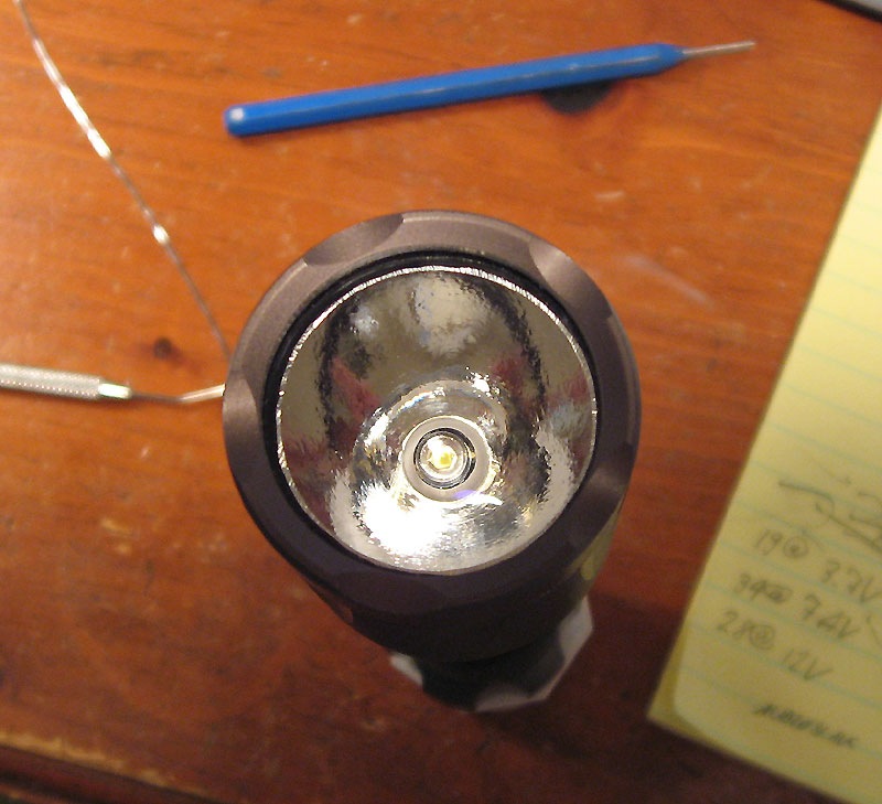

KL3 TIROS Optic Replaced with McR38cut Reflector

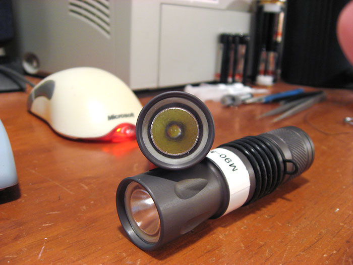

M90-M1 Illuminator (LuxV WXOS, runtime 90m on 1x123 Primary)

At the moment I don't have any KL3 TIROS heads on hand, but if you were to send me yours the rebuild, including the cut-down McR-38 reflector as well as a new emitter (I used LuxI SWOH in this one), would cost $115 plus shipping. BTW, I nicknamed the resulting head the "Blowtorch."
Some more photos of the rebuild...
Looking Into The Bezel. (Yes, there IS a lens on there!)

Would really like to get one of your M90-M1 Illuminator mods on my light that i just got.Could we make that happen?

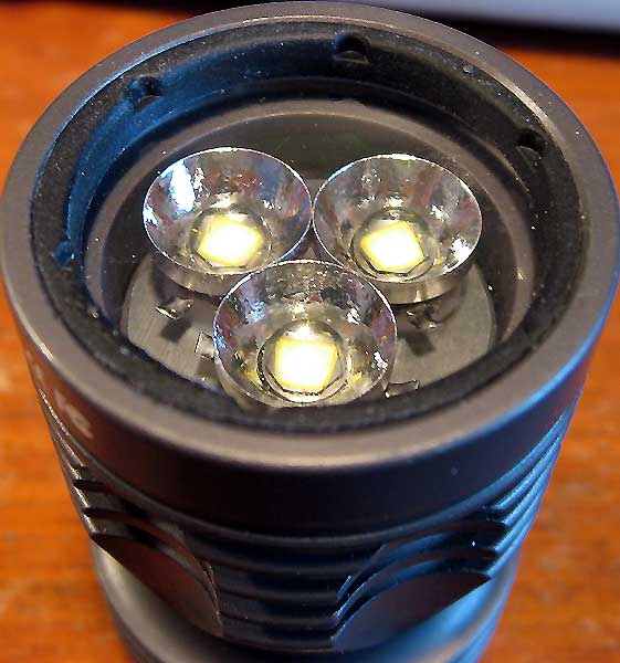

A little new eye candy! This is a special M180-KL2 light I'm building for AreWeThereYetDad. Gotta give him credit for insisting on this specific combo... and IMHO it does look really nice! Good picks, Dad!

Sure! Pricing looks to be $165 plus shipping to do the build in your M1, or $235 plus shipping to do the build in one of my M1 hosts. All things considered, I'd just as soon build into yours unless you've already got other plans for it... but really no problem either way. PM me if you want to move on this! Ask MSaxatilus how he likes his.

2) How did you manage to get 90m runtime from "M90-M1 Illuminator (LuxV WXOS, runtime 90m on 1x123 Primary)". Curious how many lumens from how many amps ?
The WXOS is driven at 350mA. Roughly 90 lumens output. Spec on that part is 170 lumens at 700mA.

X384-KL3 for Miciobigio
It's been a long road getting the right parts together, but I'm working on one of these for Miciobigio... couple quick photos of the build in progress...
M90-M1 Illuminator: The Latest!
Here are a couple just-completed M90-M1 Illuminators... made a few small design improvements over the first generation of this build (from last week!) including 50% increase in light output at no cost currentwise...

Those must be the smallest reflectors i've seen.
The M90-M1 seems kinda slick too.

Milky - I just picked up one of the M1s from benighted. I am considering your M90 mod, but since I already have your M-L1, I would like to know what I can expect in the way of similarities and/or differences between the lights. I know that the M-L1 is 2 stage and supect that the M90 is not. Can you compare/contrast the two?

Hi Kirk... let's see...
M90-M1 Illuminator vs. Milky L1
The M90 and the ML1 are completely different animals. Yes, M90 is a single-brightness light... but I like to call it an "Illuminator" rather than flashlight because the beam is completely different from what most of us have come to expect. There is a hotspot but it's very soft... so soft, in fact, that the light can be used to examine things in the palm of one's hand without torching one's retinas. The M90 basically pumps out a big ball of light that evenly illuminates everything within 20 yards or so. ML1 will throw further but also doesn't offer nearly the intensity of sidespill the M90 does.
Think of the ML1 kinda like a good all season tire... well-rounded performance for a variety of conditions, though there are better "specialist" lights for any ONE of those conditions. The M90 is more of a specialist light, with its strength being short to intermediate range, even illumination across a wide angle. Not quite flood, but gives that feeling!
Technically speaking, the M90 is an oddity in that it's one of the few (only?) LuxV lights running on a single 123 cell... even a single 123 primary! The M90 can output roughly 90 lumens continuous for 60+ minutes on a single 123 or RCR123 cell without much heat buildup.

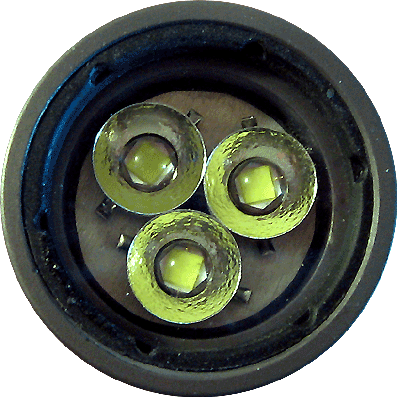

I like it too! Yes, throw is great thanks to that big reflector. It's not really pumping out much more overall output than a Milky L1 but the hotspot is more intense.
I have a KT4 Coming In and wanted to know How Many XR-E Cree's can You Fit in this Badboy? Ok Maybe some U Bins?
Have You Tried to do some Turbo Head Mods?
Well, yes actually... here's an example...
You might also lookup a review of an M420 head I made for MSaxatilus a while back, and over on Flashlight-Forums a review by TonyD of "pinky," a build that included 6x UWOJ(?) white emitters plus 1x high brightness red-orange, to broaded the color spectrum and improve outdoor color rendition.
