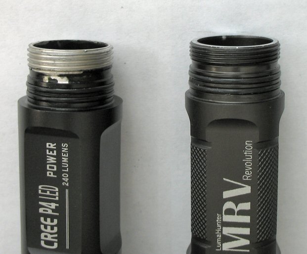

Dereelight DBS V1 and V2 – some pills are 18650-only
  • One of the major innovations of Dereelight is the ability to easily purchase upgrade emitter pills for all their lights, including the DBS. The emitter/circuit/brass pill screws directly into the aluminum reflector, allowing easy exchange.
  • Batteries compatibility depends on the pill. Digital circuit pills are typically 1x18650 only.
  • Beam profile is similar to the RaidFire Spear, with a tight hotspot and narrow, bright spillbeam.
  • Three pills are featured here – the original two-stage Q2 (low mode controlled by body twist on V1), the 3-stage digitally regulated Q4 (3SD-Q4), and the new continuously variable with R2 emitter (DI-R2).
  • Circuit characteristics vary widely between the different pills – basically, pick whatever type you like based on the output/runtimes presented above (see also my V1/V2 review here for comparison of the digital pills).
  • Dereelight uses PWM for low modes on the digital pills, and frequency has been quite variable on different batches. Although PWM freq is undetectable on my 3SD-Q4, it is a noticeable 121 Hz on my DI-R2. Some users have reported 3SD-Q5s in the ~100 Hz range.
  • Some users have also complained about a hum or whine coming from the electronics on low modes. This is common on many digitally-controlled circuits (not just from Dereelight), and is again quite variable across the pills and batches (i.e. subtle on my 3SD-Q4, more noticeable on my DI-R2). Note there is no obvious hum on my continuously-variable Jet-III IBS (which also has undetectable PWM).
  • Build differences between the V1 and V2 DBS are described in detail in my review here. The V2 is shorter (lacks the body twist mechanism), has a redesigned tailcap for easy activation, comes with a removable clip, has black hard anodizing, and allows for tailcap lockout (anodized screw threads).
  • The overall design of the DBS V2 is excellent - very modular, very well designed. The V1 was also good, but suffered in my view from the large number of contact surfaces and screw threads (proper maintenance was very important to keep the light functioning well).
  • My DBS V2 has perfect machining and hard anodizing, although the lettering has a rougher finish than most lights. My V1 suffered from noticeable machining and anodizing defects (as detailed here).
  • Both versions came with a forward clicky. Mode switching on the digital pills is accomplished by either repeated clicks or pressing and holding, depending on the pill in question.
  • Tailstanding is not possible with either version (although a modified tailcap cover may allow it on the V1). Tailcap screw threads are anodized only on V2 (allowing for tailcap lockout).

SmartFire V-68C – 18650-only
  • The V-68C is an exact knock-off of the MRV form factor (i.e. same dimensions to the head), but without the heavy duty brass heatsink.
  • Takes 1x18650 Li-ion rechargeable only
  • Light also lacks the o-ring between the lens and bezel, and the aluminum reflector “wobbles” loosely inside the head unless you have it screwed down very tight. However, since the emitter contacts are not insulated from the aluminum reflector, you risk shorting out the light immediately upon first use (you must isolate the contacts before trying to use the light - see my detailed review for pics and a discussion).
  • Light uses PWM for low mode, at a fairly high frequency of 467 Hz. But my light originally also had a horrible low freq flicker, likely due to a partial shorting issue. Once I isolated the pill from the aluminum reflector, the flicker problem disappeared.
  • User interface is very straightforward – repeatedly click the switch to move through the sequence. One my sample, sequence Hi - Lo - slow strobe (2.5Hz) - medium strobe (5Hz) - off, with no SOS mode
  • There is no memory mode as such. If you wait more than 2 secs between clicks, light will revert to Hi mode (i.e. initial sequence).
  • Emitter is not well focused in the reflector. The result is a very noticeable "donut" effect in the center of the beam. This is presumably a design feature, to try and limit the risk of shorting out the light (but it’s not a very effective one!).
  • Rear clicky switch doesn't seem very reliable in my sample, and the body has a lot of superficial nicks in the anodizing (which is only type II).
  • Surprisingly for such a cheap light, it comes with anodized tailcap threads, allowing you to lock out the light.
  • At a minimum, it is critically important that you to isolate the contacts around the emitter pill before you try to use this light.
  • Adding a lens o-ring would be a good second step. The 40 MM X 1.5 MM BN70 from oringusa.com is a good fit.
  • You might also want to replace the lens with a UCL AR-coated one for improved light transmission. The 41.8mm UCL lens from flashlightlens.com is a perfect fit (it was developed for the MRV), and adds an additional ~2000 lux to the peak throw in my testing (i.e. UCL produces 17,000 lux @1m, compared to stock 15,000 lux). See discussion further down.
