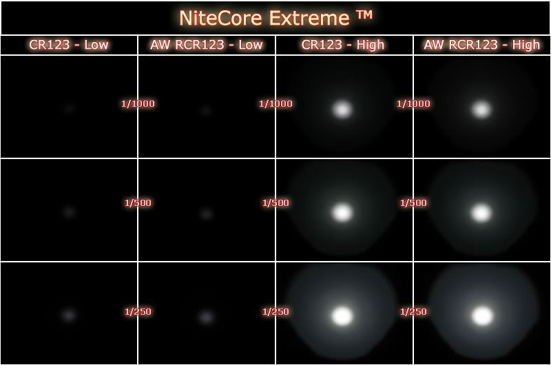

Beamshot's NiteCore Extreme High & Low:Here is the Beamshot Matrix shows NiteCore Extreme on Low & High light levels with single CR123 and AW RCR123 battery. All beamshots are taken at f/8 aperture with varying shutter speed.

Update 2: Beamshots 1
More beamshots Here...
Update 3: Beamshots 2 Here is the comparison between beamshots of NiteCore Extreme and NiteCore Defender Infinity Silver
More here...

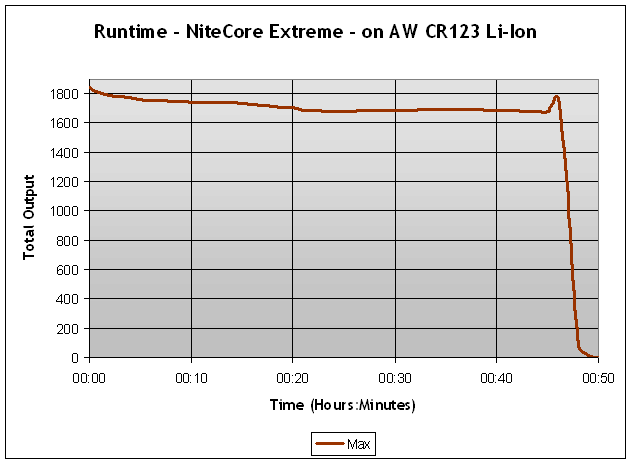

Update 6: Runtime Test: The runtime for NiteCore Extreme with AW RCR123 on MAX light output is about 47 Minutes till 50% . NiteCore Extreme runs completely in regulation. Runtime for NiteCore Extreme for lesser output levels will be considerably more. From the runtime, it is evident that NiteCore Extreme has one of the efficient circuits out there. It is as of till date the best combinaiton for longest running and highest brightness.
These results are in line and similar to selfbuilt's results prooving consistancy in light runtime for different samples. More excellent runtime tests by self built can be viewed on selfbuilt's excellent review thread
