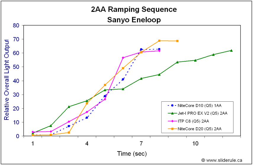

So what’s new with the circuit? One welcome change is that auto ramping in the reverse direction after using the shortcuts to Min or Max now works. On the 1st generation SmartPD lights, you needed to press and release and press again to get it to start ramping in the reverse direction after using a shortcut (double-click for Min, click-hold for Max).
Another change has been to increase the number of discrete output states from 100 to 256, according to NiteCore. As a result, I would have expected a longer ramping time, but NiteCore has kept the total ramp length down to about 6-7secs, which is just a second longer than the D10/EX10.
If anything, ramping is even more visually-linear now than it was before. But I find I rather miss the slower initial ramp at the lowest outputs (i.e. the D10 spends more time there, proportionally-speaking).

Great review Selfbuilt. I received my D20 around a week ago and have been waiting for your review (as you know ).
My only complaint is that I think it ramps up too quickly at the very beginning. It ramps down much slower than it ramps up. Or at least that's what my eyes are telling me.
No argument here - my ramping graph shows exactly that for the low-to-high ramp. I also find it moves through the low levels too quickly - but, technically speaking, it is actually more visually linear than the old ramp.

...but I'm starting to think that minimum mode runtimes are just too problematic. Now that we are starting to see lights with really low output modes, the problem of Vf variability seems to be becoming huge at these outputs. I'm seeing variability in runtime reports on the order of > 3-fold for some lights on low settings than aren't even as low as the ones we are discussing here. And my discussions with various light makers confirms that this is not an isolated problem.
Simply put, it's looking like low Vf lights are running at considerably higher drive currents than high Vf ones for many circuits on low. Although this effect is often negligible at higher outputs, at really, really low ones it wrecks havoc on runtimes. Without a wide range of samples to test, it's impossible to know how representative my one specimen would be.
Honestly, I could easily imagine the range of runtimes being anywhere from 3 days to 3 weeks. One sample point in there is likely to be highly misleading. I think what we really need now is for makers to test high and low Vf extremes, and report the range of results obtained. I expect you'll see days to weeks variation!
EDIT: I see Chevro has recently posted D10 and EX10 Min runtimes, where he got ~4.5 days for the D10 on one Duracell Ultra. My D20 has about the same min output level as my D10 cree, so I would expect pretty decent runtime. It won't be the most accurate, but I've just started a Min run of my D20 on 2 regular Duracells in a corner of my closet. At least this way I should be able to tell you when the run stops, +/- half a day or so, since I go into the closet each morning and evening. But please keep in mind that this is just for personal "entertainment" purposes - Vf variability could hugely affect ultimate results.

I was under the assumption that the D20 was a fairly high drive current light (relative to single-digit milliamperes), regardless of output. Is that not the case?
Reply With Quote
  #29
Old 10-28-2008, 08:13 AM
selfbuilt's Avatar
selfbuilt selfbuilt is offline
Join Date: May 2006
Location: Canada
Posts: 2,463
Default Re: NiteCore D20 Review - 2xAA - RUNTIMES, BEAMSHOTS, DETAILED PICS and more!
Quote:
Relatively speaking, I think that's true of many of the current continuously-variable lights - since they tend to be optimized for max outputs and not low. Unfortunately, I'm not able to confirm current draws (even battery draw estimates are problematic with my DMM, since I know it introduces too much resistance).
