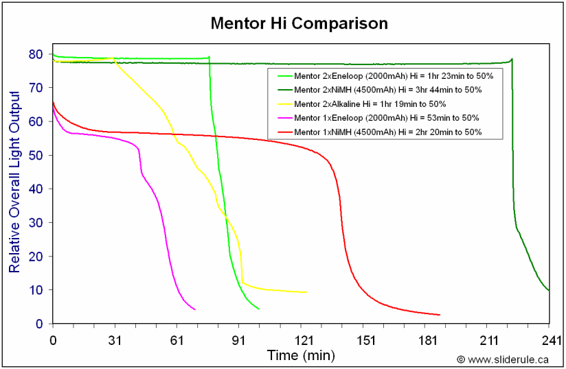

Output/Runtime Comparison:
Performance and regulation on all batteries is quite good – and consistent with what you would expect. As you can see, output is much less on all modes for 1X versus 2X configurations.
C-cell sized NiMH are not too easy to come by, and Lumapower thoughtfully provided a pair of 4500mAh ones for this review. Alternatively, you could use Sanyo Eneloop AA cells with a C-cell adapter, but you would get much lower capacity (2000mAh) than full C-cell NiMH. But for all that, performance on standard alkaline is is quite good.
To give you a sense of the relative output/runtime efficiency of the Mentor, I am showing its performance in 2xAA mode, relative to other lights of that class. As mentioned previously, it is certainly an impressive light on Max mode. On Medium, its performance is about what you would expect for a PWM-based light (i.e. overall efficiency is similar to the LightFlux LF3XT-2AA and Lumapower Connexion 2AA). The current-controlled lights of this class have a clear efficiency advantage, as always.

The wrinkle here is that certain batches of specific output bins are sometimes associated with relatively hi or low Vf. That would very likely affect runtimes in a consistent manner for that output class (i.e. one output bin group could have higher or lower runtime than the other). However, it really is impossible to know if that's the case here - emitters are not routinely binned for Vf, and changing lots can vary the results significantly over time.
So, short version, yes, I would expect similar runtimes across the various versions.

I've been having my Mentor (R-model) for some time now and I have a real love/hate relation with it .
What I like:
- Finally a C-cell flashlight that runs on C-cells (it even runs on 1 cell as well)
- Seems well made and put together with care.
- Form factor: great light to take walking
- (with the standard head) nice balance between good throw and a lot of sidespill as well.
- Good solid output (220 lumens) which will do nicely. (this is the output level/league of the 3 cell Malkoff P4 dropin, Surefire P91, etc.)
- Tailstands
- Good water resistance (shower proof)
What I rather dislike:
- Regulation with 2C alkaline is not so flat, after a (short) while, output starts declining, instead of a sudden drop.
- When using C nimh cells, when the cells get depleted, output suddenly drop to a lower level, comparable to the medium setting.
Contrary to the graph by Selfbuilt, my AA nimh (Eneloop) do not drop that abruptly. They also decline slowly when they get empty.
- Changing modes is a PITA. This is a tool light for *** sake, keep it simple. On and Off will do. If multimodes are really "necessary" add a lower setting (15 or 25 or 50 lumens?) and make this accessible simply (à la Fenix TK20 or L2T) by loosening the head, or something comparable)
(I do not carry a light of this size for having a 5 lumen low output. Sorry, but my ARC AAA will fulfill that job).
Four fast clicks to block it in a given output level . Who invents this?
A flashlight that needs a manual is basically a failure, in my opinion.
- O-rings are quite thin and do not seem to be up to harsh and frequent use.

22hornet - I wanted to address some of your 'cons'
1 - the regulation with alkalines isn't the fault of the light - it's the alkaline batteries. In this type of constant run test their voltage drops steadily from the moment the light is turned on. As the voltage drops, and the internal resistance increases, the circuit is forced to draw more current to maintain output but there's a limit to the current that an alkaline C cell can provide - when that limit is reached the output will drop off.
2 - Batteries; I'm not sure why NiMh C cells would drop off like that UNLESS you're using those 'fake' C cells with a AA or SubC inside (capacity is usually 1800-3500mah). If you're using true high capacity NiMh cells of 4000-6000mah then your light would stay in regulation. Personally I don't see the point of using eneloop AA's ina holder in this light - just buy a LumaPower Vantage if you want an AA light.
3 - UI: As lights have become brighter (remember, 3 years ago 80-100 lumens was the most you could get) it has made sense to add multiple output modes to allow users to tune the balance of output and runtime that matches their needs. The SMART UI on the MENTOR and many other LumaPower products is made specifically to keep 'everyone' happy; it allows you to lock the light on to a single level so the switch is just on/off. I can't change how you feel about a users manual but in comparison to many of the lights on CPF the SMART UI interface is pretty simple and manages to give different types of users the tool that THEY WANT.
