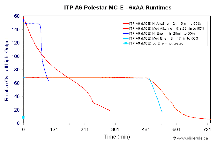

Testing Method: All my output numbers are relative for my home-made light box setup, a la Quickbeam's flashlight reviews method. You can directly compare all my relative output values from different reviews - i.e. an output value of "10" in one graph is the same as "10" in another. All runtimes are done under a cooling fan.
Throw values are the square-root of lux measurements taken at 5 meters from the lens, using a light meter, and then extrapolated back to estimate values for 1 meter. This will be my standard way to present throw on these types of lights from now on. The beams don't really have a chance to fully converge until typically several meters out
Some of the other lights take a couple of minutes to settle into their regulated output state (i.e. their initial output is higher, but not for long). As such, all my output and throw numbers are taken after 2 mins of continuous runtime (on 2x18650 AW Protected cells).
Consistent with what you saw in the beamshots, the A6 is basically the same as the Olight M30, with just slightly less max output. Overall output is still well within the range of other MC-E/P7 class lights (if toward the low end), while throw is definitely at the lowest end of the class.
Output/Runtime Comparison
UPDATE 12/15/09: As expected, alkalines were not able to provide sufficient power on Hi to keep the light at a regulated output level. I doubt it's a good idea to run alkaline cells on max for any period of time, but at least they work in a pinch. Excellent regulation with alkalines on Med.
UPDATE 12/19/09:
Low mode runtime on alkaline lasted at least 3 days before depleting the cells. Didn't do a continuous lightbox test, so no runtime trace to add above, but light appeared to be very regulated over this time.
Overall, no surprises here - runtimes as expected based on ITP stats.
Note: Although the ITP A6 Polestar runs on 6xAA, I have decided to compare it to the 2x18650 for all the other members of this MC-E/P7 class.
All 18650 runtimes were done on AW protected cells (2200mAh). The A6 was run on 6xEneloop (2000mAh).

I have just updated the runtime graph with the Hi mode on alkalines: (hit your browser re-load if you don't see the new trace)
As expected, alkalines can't handle the drain in a regulated fashion for long. Plus I don't imagine it's too great for the cells to try, but at least it does work in a pinch.
Quote:
Originally Posted by adirondackdestroyer View Post
Are you planning on doing a runtime graph for the low setting? I know it may seem insane, but I was hoping you would (if you have the time). I'm pretty impressed that it runs for over 9 hours in the medium setting, considering I tested it to be well over 100 out the front lumens in my lightbox. Not bad!
Hmm, ok, but it will have to be an alkaline-only run and done outside my lightbox (too many other lights to work on ). I'll start it up and let you know when it goes off ...
Awesome! Works for me!
Well, the light shut-off sometime during the night, so that means somewhere around 3.5 days on low on alkaline. Last time I checked it was yesterday afternoon, which was just over 3 days.

Quote:
Originally Posted by selfbuilt View Post
Well, the light shut-off sometime during the night, so that means somewhere around 3.5 days on low on alkaline. Last time I checked it was yesterday afternoon, which was just over 3 hours.
Sweet! I had to be so damn picky, but do you remember if the output stayed flat for most of the time (like the medium mode does)?
Yes, it was regulated over the run. I popped it into the lightbox a couple of times, and the output was rock solid.
Great! I figured it was, considering how good the regulation was on medium, but I wanted to make sure. 72+ hours is pretty damn good considering how useful that level of output is.
