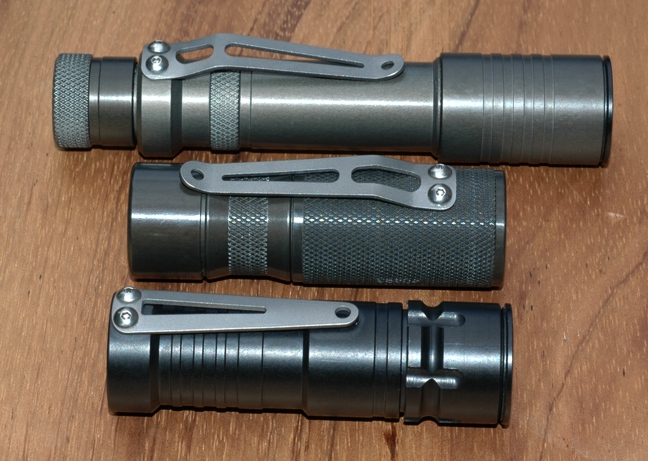

Default Re: Question about UV lights
LT got the twin brother to the one that Larry bought. The form and function of LT's light encouraged me to build out the one that Larry picked up. I still have my "bench tool" but I also machined a one off PD head with a special bezel over the weekend which is now at the anodizer. This PD may become my bench tool.............
EDIT:
The UV light I use for curing the H3 vials has a wiz2 driver and it is the 2x123 light at the top in the photo below. It is a single power light:
__________________
Build Prices .... some mods and builds (not 4 sale) ..In darkness, who better to lead the blind than the blind themselves?
Reply With Quote
  #24
Old 09-02-2005, 05:46 AM
Lunal_Tic's Avatar
Lunal_Tic Lunal_Tic is offline
Join Date: Jul 2004
Location: The Wilds of Tokyo
Posts: 3,538
I can't remember for certain. Can I say that I have a review up in the Reviews forum as long as I don't link to it? I'm trying not to cross post but I also wanted to let people know about the thread.
In any event there's a review about the McGizmo 365nm light in the reviews forum.
-LT
