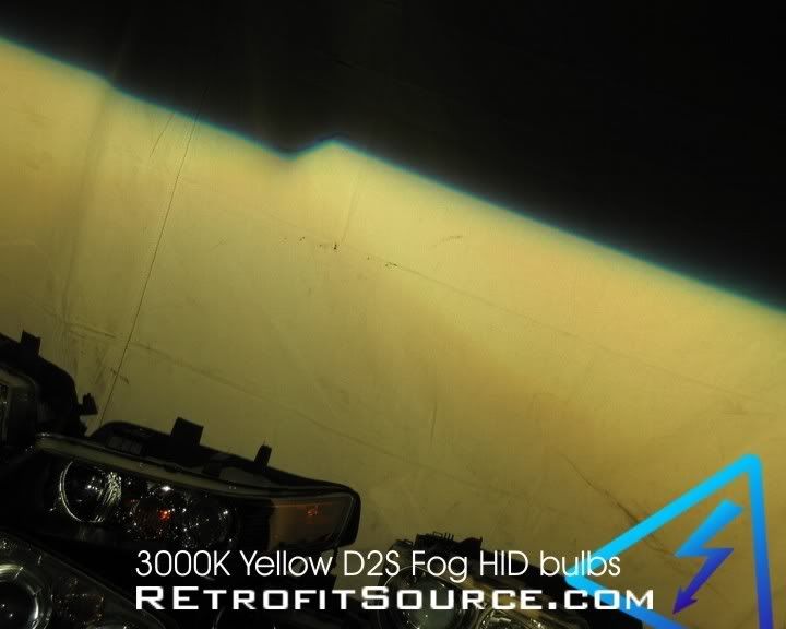

3000K is typically used for yellow fog lights without using a yellow front lens on the lamp housing.
I would not recommend it.
ahh, that would be too yellow...
The bulbs I'm looking at are China made and from all the bulbs I've seen (multiple sources in Asia) are not rated in K correctly. 4300k is more like 5000 K so hopefully the 3000k is more like 3900K...

3000K is typically used for yellow fog lights without using a yellow front lens on the lamp housing....
Is it true that the 3000K lamps actually have an integral yellow filter? I want something warmer than the 4300K lamps I have, but not fog-light yellow!
I'm wondering, because 3000K, if taken literally, would seem like it would be the same as a normal halogen incandescent lamp.
Looking at the picture my HID Bulb looks like something in between 4k and 5K, which I like the most, not too yellow, not too blue.
