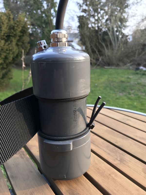

I'd like to tell a little about my build, struggles and choices, some of it might help you not to run into the same problems.

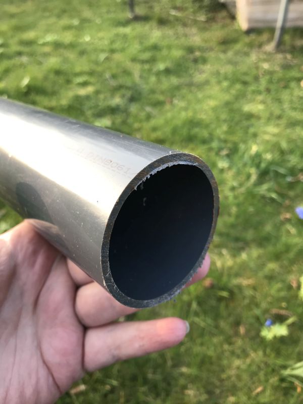

My goal was to build a canister for heating, based on available plumbing materials, as I have no access to a lathe.
The choice fell on 63mm GF industrial PVC 10bar pipe.
As I have no lathe, it's hard to make a location for an o-ring. So I accepted to glue it together and charge it through the e/o cable.
To me it seems like the O-ring where you open for every dive is the vulnerable spots in camera housings and lamps. So I'd prefer not to have to open the water tight barrier every time.
On the other hand, you miss the possibility to look inside, to notice if something odd is going on.
It can hold 7 18650 cells in one "layer" or you could call it a flower, a ring of 6 cells with one in the middle.
Unfortunately minimum buy is 5m, so I have some for new experiments...
Selected Samsung 3400/3500mAH cells.
Going for a Santi-compatible heat vest, requiring "12V", which is 3 cells or nominal 10.8V. And 3 hours of use (two dives and surface interval) with 40-50W of power consumption prescribes 4 parallel cells.
This can be done in the selected tube with two "layers" of cells with 6 in each.

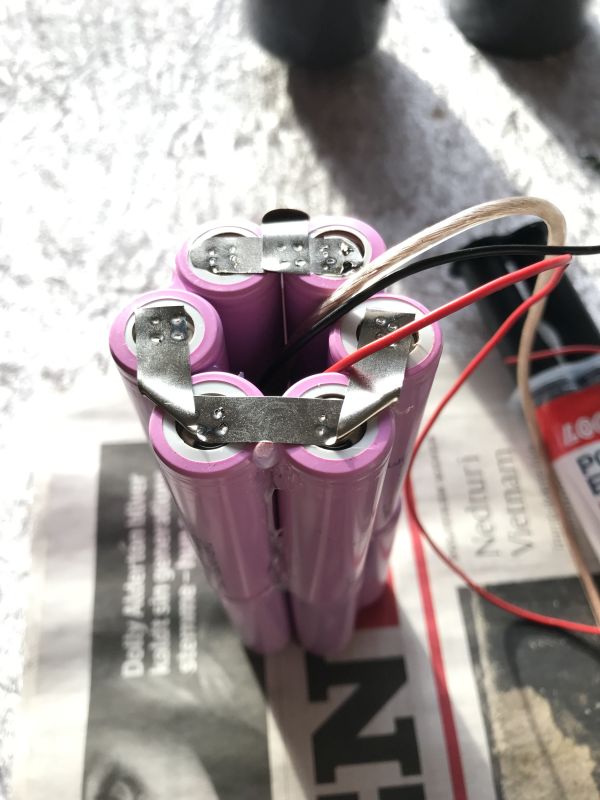

Next step was to point weld the batteries.
We have some serious lab powersupplies for automotive eqpt. at work, 15V 100A, so I thought that could do it - optionally two in parallel. It just heated the strips - no welding.
So I had to make a welder:
I had this 500VA ring core trafo at home from an AMP building project nearly 30 years ago. On a ring core, you can simply add a new secondary winding by winding through the hole, you don't need to remove the old secondary to get space for it - just don't connect the old secondary windings.
It makes 0.5V/turn, I saw some other projects doing 1.5-3V, 2V measured during welding at a professional unit, so I went for 2.5V. 5 parallel wires of 4 square mm, 20square mm Cu in total.
Primary goes through a spring loaded lighting switch (those for kip relay lighting systems), used as a foot switch. A very short bump on the foot switch is enough:

OK, next step is the gland. Wanted something with a long thread to be able to put a counter nut on the inside. And capable of handling Thor 9.6mm e/o cable
https://www.deepstop.de/en/light-accessories/945-eo-cords.html
Couldn't find Agro from reasonable sources. One of the few I could find was this:
https://se.lappgroup.com/fileadmin/documents/technische_doku/datenblaetter/skintop/DB53112005EN.pdf
After I bought them, I found that they seal using plastic against a brass cone, and I simply don't trust it.
I then heard that "blueglobe" glands have a good reputation among rebreather divers. So I bought some of those:
https://www.ibs-gruppe.de/shop/kabelverschraubungen/blueglobe/776/bg-816ms
They seem to work.
I grinded the typing away, drilled in the middle, and made a M16x1.5 thread. Got a nice 7-8mm deep thread there.

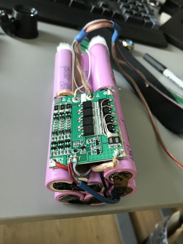

I bought these protection and balance boards:
I got a bit suspicious when I saw that the power MOSFETs had the same name, but clearly were from different factories.
Currently it's hard to get MOSFETs due to allocations, and I've seen fake MOSFETs at work - re-branded, much weaker MOSFETs.
So I wanted to test functionality and power dissipation.
I didn't find any balancing current. So I made a schematic of the device, and realized that there is no balancing circuit on the PCB, even though the seller claims it.
Arrgh..
I had a very big 3S protection/balancing board in the drawer.
to use it, I had to re-arrange my 6 cells, and also cut some of the board away, and replace some power tracks with wires...

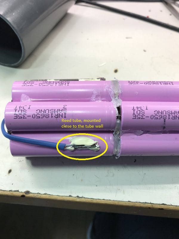

This made me go back to the good old reed tube - an external magnet will be a mechanical indicator of power on or OFF.

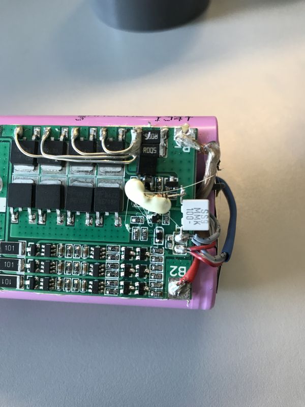

I wanted to use the MOSFETs on the protection board as the power switch also - no reason to add extra FETs, I thought.
I noticed that my protection board had a set of terminals marked T - and I found I could remove the gate voltage there with a reed tube, turning power OFF.
It worked.
I added an LED on the power out cable as indicator. And then it didn't work any more. I could only switch unloaded.
A protection latch turns OFF the MOSFETs of there is voltage over them - made to latch the protection in case of error, until the load is removed.
Now, added a little capacitor/transistor circuit to reset that latch in the moment the reed tube goes on:
Now it worked.

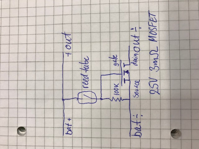

Until I connected a heavy load. Now the over current protection detects too high voltage over the MOSFET when the MOSFET is in the process of turning on.
Yet another ARRRGh.
We had a suitable 3miliohm 25V MOSFET in the drawer at work, but, in a horribly small package: a DirectFET:
3miliohm will dissipate 300mW at 10A, but Directfets are not a pleasure to solder, and that source terminal was like 1x1mm, where I wanted 10A out.
Soldered it upside down to a small un-etched PCB.
I put a 100kohm resistor source-gate, and reed tube to pull up. That would dissipate an acceptable amount of power if accidentially ON in the locker. But it would make the MOSFET turn off rather slowly, and dissipate much more power when in the process of turning OFF.
Testing it proved that it didn't feel like it heated up with a 6A load, and also importantly: I didn't feel any heating of the FET when repeatedly turning on and OFF.
In other words, it might have been possible to use a larger resistor value.
100K will use 120uA, which will last 13 years from my 13.5Ah battery if accidentially left on. I'll better remember to turn it OFF every time ;-)
Now, as this canister will be glued together - can only look at the batteries if I saw it open - I wanted a safety valve.
As DIWdiver has pointed out, a first stage OPV doesn't have the area required by UL. Anyways, I bet it will in most critical occations be much better than nothing. And I have the correct thread tap. So I went with one.
Made a flat surface on the cap, drilled and made the correct threading. Counersunk a little to make a cone for the O-ring.

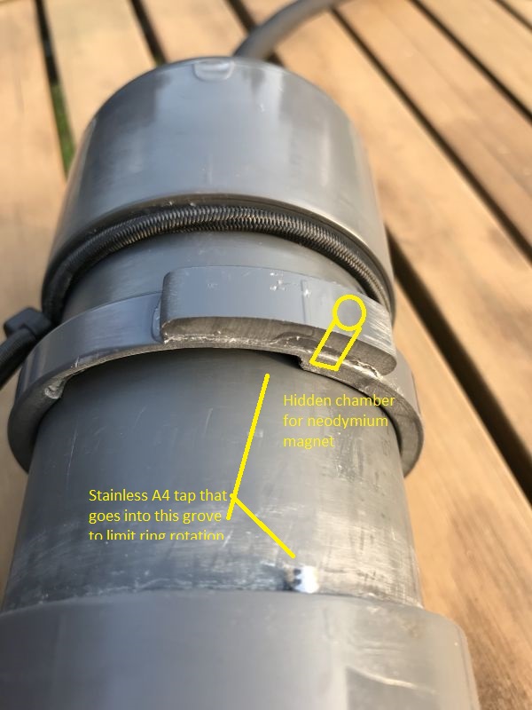

Hey, I forgot to show my magnet ring, to hold the magnet for turning on and off through the reed tube:
I made this ring, where I made a chamber for the magnet in the PVC, and made a PVC glued cap/"button to feel". I hope that as the PVC glue makes a kind of welding, it will be sufficiently watertight for the neodymium magnet to stay well.
I made a hidden grove in the ring, and put an A4 stainless steel pin in the bottom cap to make end stops for the ring movement.
I would also like to add a little comment on balancing - how do you see on the board that there is balancing on it, and how much balancing current is needed?
So the interesting thing here are those black square power resistors on the board. On my large board there are 5 of them, 2 marked R005 (that is the over current sense resistors). Then there is another group of 3 marked 101 (100ohm).
For balancing, there'll normally be the same number as cells in series.
When a cell reaches something like 4.2V, the resistor will load that cell, so those cells that haven't reached 4.2 yet can still be charged, while this cell is kept at 4.2V.
This only works if the charging current when the first cell reaches 4.2V is the same or less than what the resistor drains.
When I charged my pack, I found that the first cell reached 4.2V when charging current was a bit over 100mA. Now as this balancer uses 100 ohm, its balancing current will be 42mA. So with my pack, it's not enough...
I have to admit that even though I should have changed the resistors for something like 39ohm, I didn't have 1812 size resistors of 39 or 33ohm, and wanted to finish it.. so I just closed my eyes.
But next time I will sure want a balancer that can do more power.

I've added more descriptions, including drawings on some of the pictures, to explain things better.

I read your comment on neodymium magnets somwhere -thanks for sharing! I've also replaced magnets in china lights.
I made the precautions here that:
1: the hole for the magnet is way larger than the magnet
2: hoping that the PVC gluing a chamber (as opposed to epoxying the magnet into a hole) would be more waterproof.
3: As I can't replace the cells, I guess the canister will have a limited life - hopefully equal to normal cell life. But I can rather fast make a new one now.
4: Time kills DIY projects.. I had a useable magnet in my hand :) Might try to get a samarium cobalt magnet next time!
