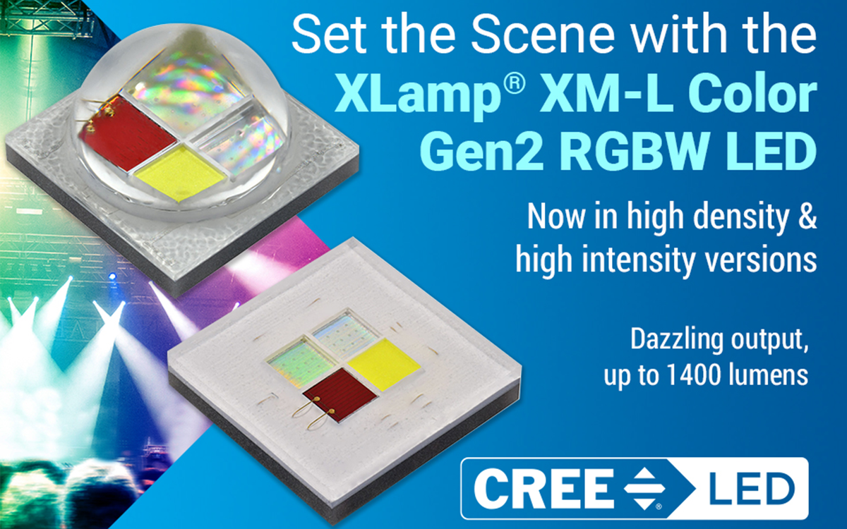

There actually is another alternative. It's not HCRI, but it's exactly what you want in one light.
I'm going to order me a couple to build. My kids will think they are awesome.

Except that an RGBW package doesn't have any UV output.
It's certainly possible to build something with red, white, and UV, but for hobbyist quantities, you're talking discrete emitters per color.

What driver or kind of driver, and MCPCB would you use for a red, white, and UV?
