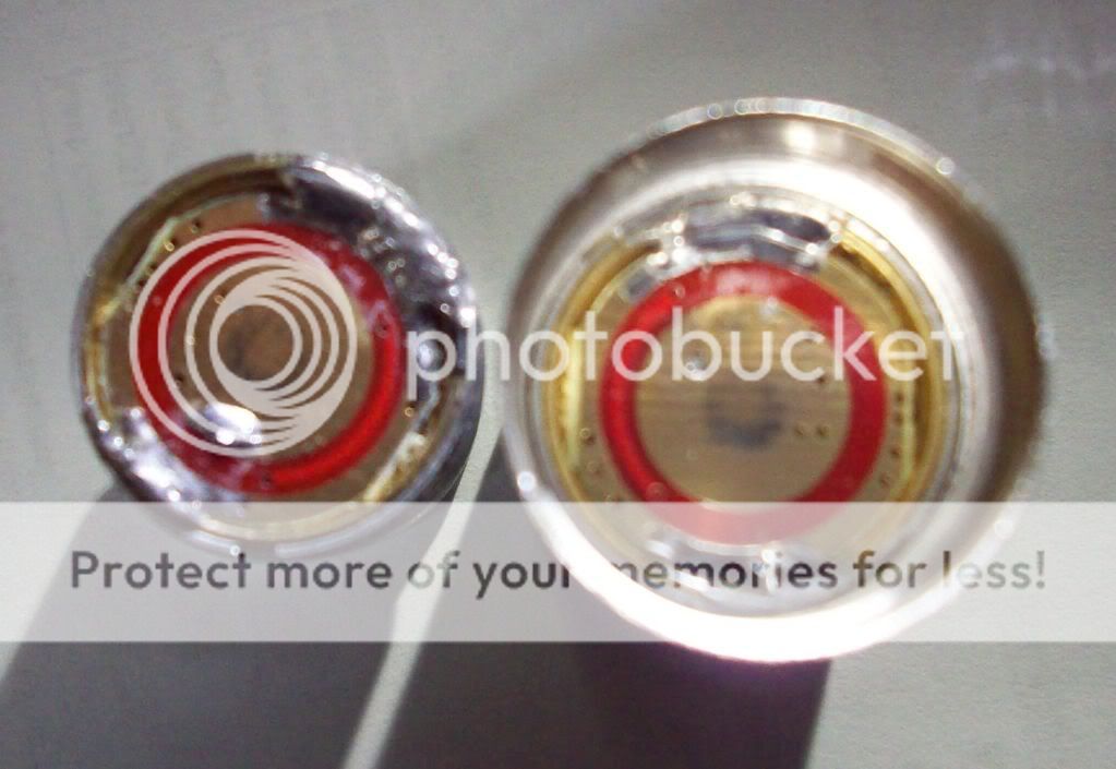

I have a 106 AA and enjoy it so I bought another one and received it today. It won't light up straight out of the package. I unscrewed the pill and noticed some ugly soldering on the one that does not work. (left in the pic) Could that be the cause and what do you suggest I do to make this work?
A larger picture would help. Have you done the usual, try several different batteries, clean the threads, take the end cap of and connect the battery and body to see if it lights?
I'm not real hard-core with tearing down lights ar anything, but I traded the body out (switch) with the non-working one and it didn't work - the other body/switch worked fine on the first one (working one). I'm suspicious the about the head and the solder bleeding over to the inner circle. Am I right to assume the inner circle is the positive contact and the section outside is the negative contact? Ideas?
I've tried several different good batteries. I don't want to go for a 14500 since you can't go back to a 1.5v cell.

I tried blowing up your picture. That blob may be a problem. I'm sure someone will be along with a more definitive answer.
My light is the K-109 and looks a little different. I know from other lights that the very center is the + contact and while sloppy it doesn't look like the blob extends out that far.
It does cross the red circle. I'm not sure if that is a problem or not.
Since it sounds like you have isolated the problem to the head it's likely the blob is the problem. Either that or you just have a bad led.
If you or a friend knows how to solder/desolder you could easily try removing (with desolder ribbon) that excess blob.
I also tried blowing up your picture ( 😉 ), and from what i can tell from that is that there probably isn't a short in there (that would be nasty is you used a li-ion cell in there, one of those could go :poof: ). I have to admit the soldering on that specific light isnt pretty.....
I do have a feeling there's some form of quality control on these lights, it just isn't very good. My guess is that they apply a control voltage to the pill base and check if it works that way, so without the use of an actual battery or a completed flashlight.
It could very well be that the blob on the picture on the middle circle is so thick that it pushes back on say the shoulder of the battery, just enough so the positive pole of you cell doesn't reach the connector. Try to desolder that blob, or if you dont have the means to do so just try to shave/cut the blob down till its as flat as you can get.
This is how one of those ends looks on my 109:
