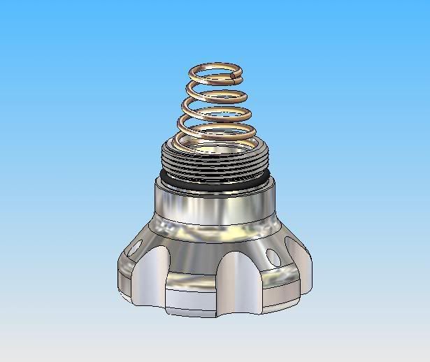

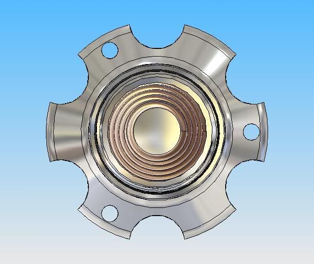

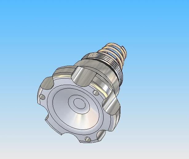

Latest C-Mag Tailcap revision
I just realized that the lanyard hole will have to be relocated or a relief groove cut in order to ensure stability during a tail stand.
Where do I sign up for the D-Mag version ??? :twothumbs

tx101: I think I really need to start another thread for the fluted tailcaps as soon as possible. Then I can have an official interest list independent of the bezels.

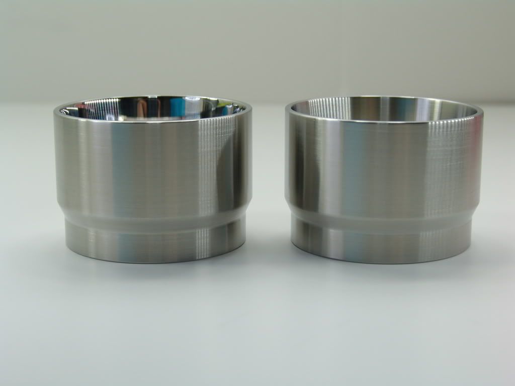

Very possible! In fact here are a couple bezels I did for Karl.
The exterior finish on these is about a #16 brushed. You'll notice that one has a polished interior surface and the other with the #16 inside.
Is this close to what you had in mind?

That is cool but what about The M.G.A.C.F.S. , can you get in between the fins too?

Putting a #16 brush finish on the M.G.A.C.F.S. bezels is not a problem, but getting in between the fins to do anything is nearly impossible while rotating on the lathe. The space is just too small and would cause anything going into those grooves to hang up quickly and bind probably causing more damage than good to both the bezel and operator.
Just getting to the interior surface was a very tricky situation because the crenellations become the equivalent of rotating teeth which left their mark on more then one of my fingers.
Besides its really not necessary because the finish coming right off of the lathe is just about #16 brushed. I just used a fine grain scotch bright pad to achieve a very clean and smooth #16 brushed finish.
Would you want this brushed finish just on the exterior surface or both outside and inside?
