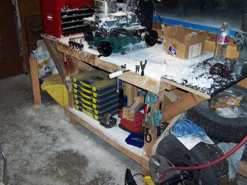

After using the zombie killer to size up all those parts, and then using the 17mm end mill to remove the majority of the plastic, the area around the mill starts to look like one of those snow globes just before you shake it up...
Air compressor, combined with one of THESE (see below) is absolutely ideal for blasting off the table and getting all of those chips up and out of the indexing table and mill table.
After the chips are all on the floor I hit it with the shop-vac. I have one of those little 8 gallon shop-vacs, milling a good 20-40 parts will pretty much fill it up with chips.
Milling operations tend to leave a bit of "fray" around the edges. It's hard to get it all cleaned up in the pockets, but I take about a minute or two per piece with the razor and get it cleaned up as best as possible.
