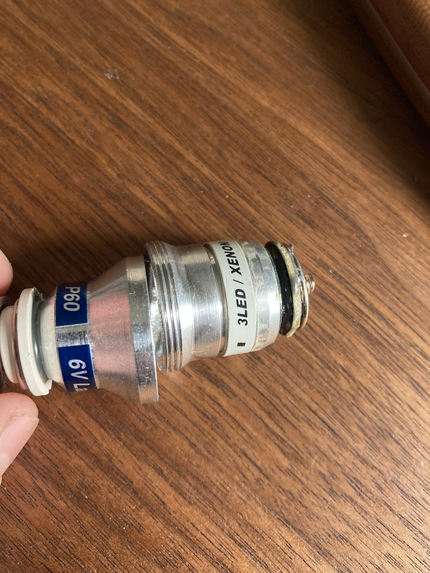

Cleaning out and found a Cabela's 3 x cr123 incan that looks a lot like a 9p right down to the xenon bulb assy. It still works fine. It has an anti-roll bezel. How do I find a compatible LED conversion? What is the equiv rechargeable battery for 3 x 123 length? I'm guessing it wouldn't fit in a "regular" charger either. I can prolly just use 3 x RC123 and a regular charger also. I'm looking at the Malkoff M91B drop in. Suggestions?

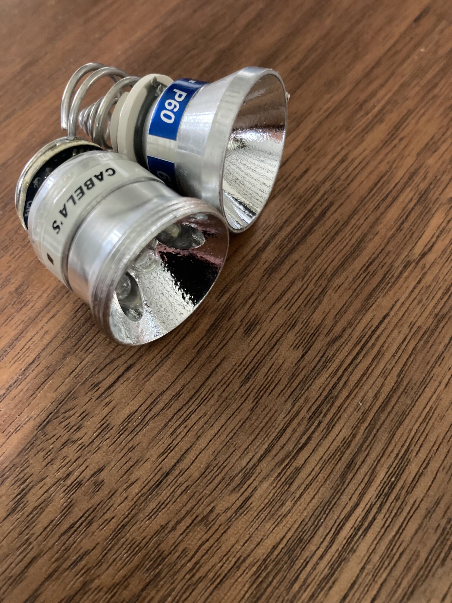

I remember these, but never owned one. I still have a Cabela's lamp module that was both an incan lamp and three 5mm LEDs, similar to the A2. It is P60 sized as you said, and works in my SF hosts. However, it is smaller in diameter than a P60, so another drop in might need to be sanded down to fit.

Yes, to the best of my memory, one click was just the LEDs, the second was both the incan and LEDs. I think I paid all of $6 for it on clearance many years ago. Haven't used it much since it runs on primaries, all my heavily used incans run on rechargeables.
