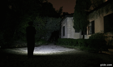

Beam: As it should be on any headlamp they do have a very wide sidespill, near 100º. The hot-spot is ver narrow and bright. Maybe too much for me. The reflector is smooth, and I would choose an OP for a headlamp, but the overall result is quite good. The auxiliary light (6 LEDs has too many artifacts due to the not centered leds and the smooth reflector)

Main source.
Secondary source.
