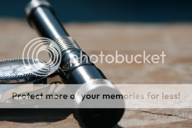

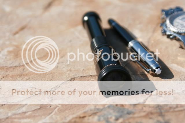

Custom C/L Enterprise LensLight™
The LensLight™
Professional Light Tool
High Power Focusable LED Flashlight
American Engineered
American Manufactured
American Made
(2) AA Batteries
Patented Focusable Aspherical Lens System
McClicky Tail Cap Switch
High Tolerance American CNC Machining
Custom Double Lens
7075 Aluminum Construction
Type III Hard-Anodize
Chem-Kote Contacts and Heat sink
Aerospace Grade Thermal Potting and Flow Management
Weather Proof/Water Resistant
Premium Bin CREE XR-E R2 LED
Premium Bin LUMILEDS K2 w/TFFC
Fully Regulated Light Engine
