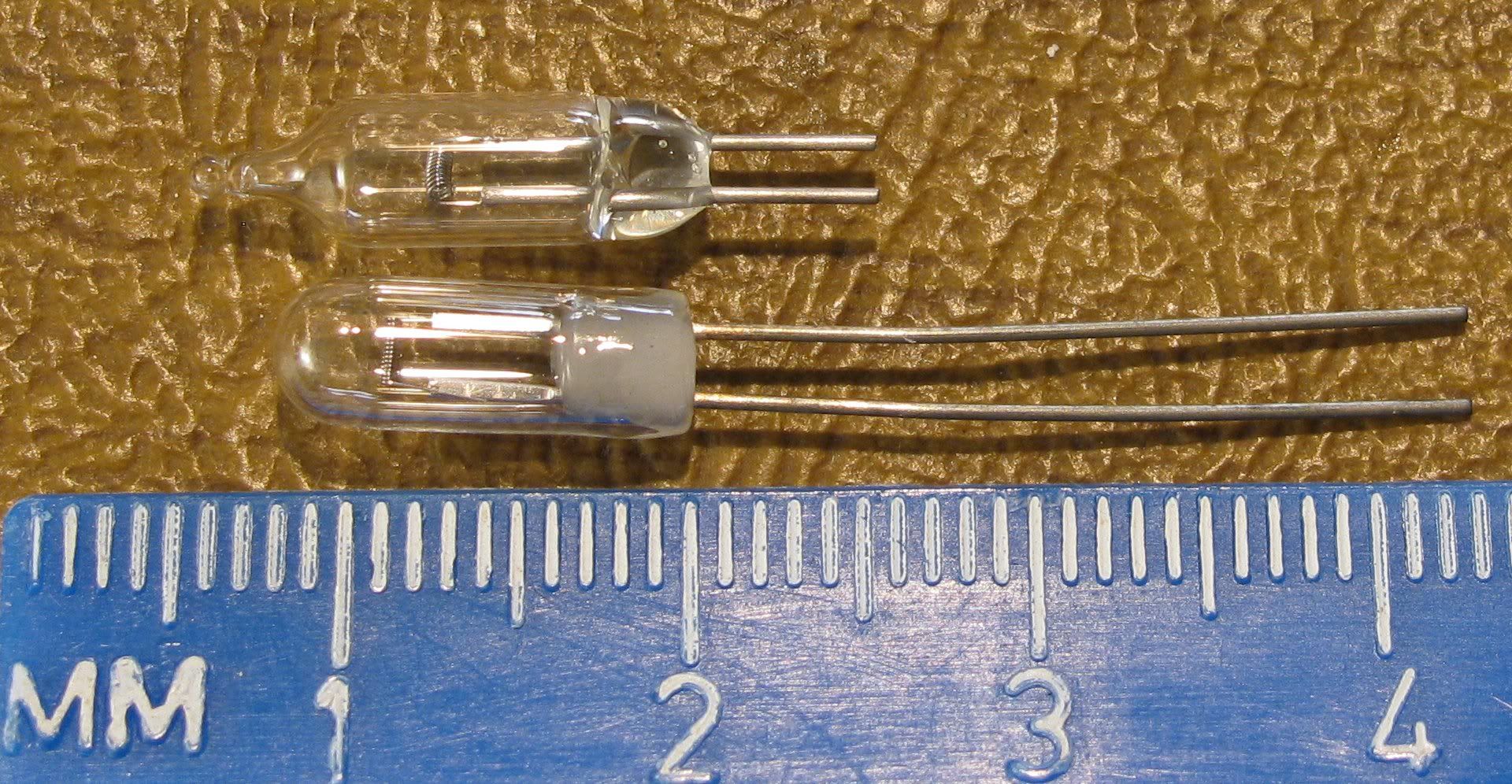

Nite, all the tests on the 1794 & 1499 were ONLY done with the FM 1" MOP heads in that one setup you sent me, and with freshly charged 18650 cells. I had two sets of cells that were used with each bulb test to give both bulbs maximum advantage.
Thanks for the info jslappa. But does a 1794 bulb fit in the FM MN Bi-pin holder? I thought the 1794 was a smaller bulb requiring FM's D26 bi-pin socket? I'd love to be able to use the 1794 in the M3 head if there was a way..
Yes, I was simply referring to the fact that there were better options for the M3 than the HO LF bulb you mentioned. I got the M3 to work with the MN bi pin assy and an 1185, but it looks like a caveman put it together. I hear Kruppstahl is tearing up the night with that thing on 3 IMR 16340's!
As for the 1794, I don't know if the bi-pins can be placed in the MN Bi Pin assy. I suppose the Bi Pins could be altered to fit, but it may not be worth it in the end.....not when the 1185 is such a good performer.
You're right though, out of the box the 1794 would probably not fit in the MN bi pin holder. I would imagine I would have read a few threads on it by now if it were possible.

The other thing I wondered is if these come at the 1499 longer leg length, as that may enable them to be put into other bipin holders.

I just squashed one into an E2d on 2 x IMR cells, and a FM E series lamps holder ( TL3/ Stiron socket )
Its not pretty as there is small gap between head and body, as can't screw the bezzle down all the way due to focus issues.
I'd realy prefer it if you could ask carley to drop the filament height by 2 or 3mm to help get a better focus easier, but it is a bright little sucker. :devil:
Had to uprate the surefire stock tailswitch to handle the current draw.
I just did the same thing.. then dropped it (and broke the bulb
:mecry🙂
if you can get your hands on the old style domed lens E2D head, it gives you a little more room for the bulb...
the 1794 puts out an AMAZING amount of lumens and did not need "focusing" in mine.
