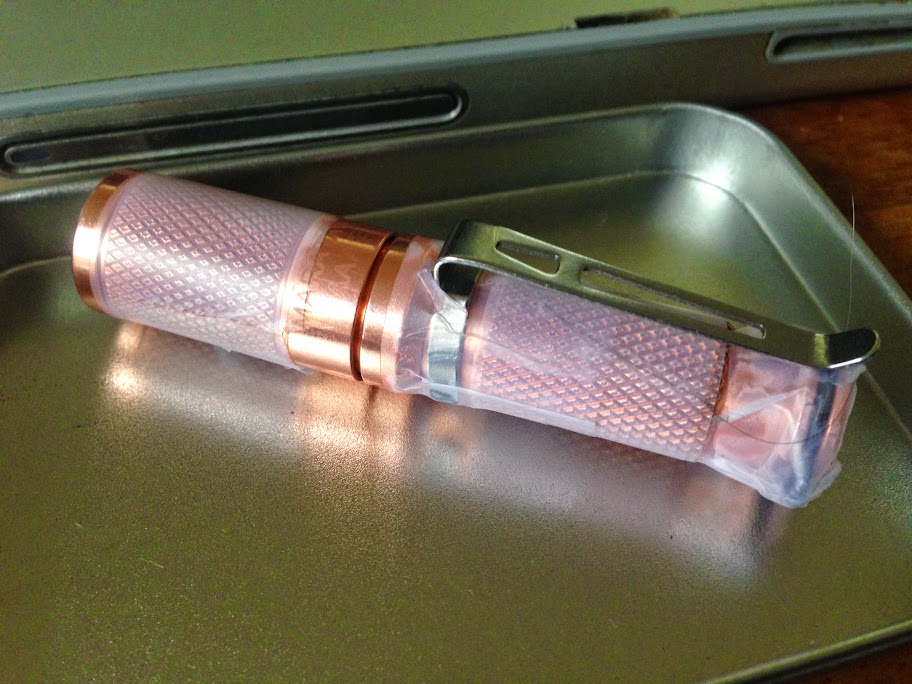

The Thrunite clip is only slightly shorter, and though it allows tailstanding more easily, it is still touching the surface the light is standing on. The Maratac clip has the same issue when the clip is in pocket position, it touches the surface slightly.
So, when a Maratac clip is in hat position, no tailstanding. If tailstand is desired, the clip has to be removed from hat position. The tape all over the Maratac is because the knurling was making my hand raw. The light is so hard to operate one handed, it is almost non functional unless 2 hands are used.

I recommend this light, despite its shortcomings, the copper is beautiful. Im using it without an O ring because it makes it easier to use one handed. The threads are beautifully smooth. I like that the pocket clip will go on in hat position, and even though it wont tailstand that way, I can flip the clip, Im not trying to keep this one as a safe queen.
Ive added a neodymium magnet to the base, with double sided tape. Just having fun playing around with my new toy. The magnet on the base also helps with tailstand, the clip is not sticking out as far.. Not sure if the magnet is a keeper, it keeps grabbing stuff around me, knives, keychains, my other lights.. apparently batteries like magnets too 🙂
