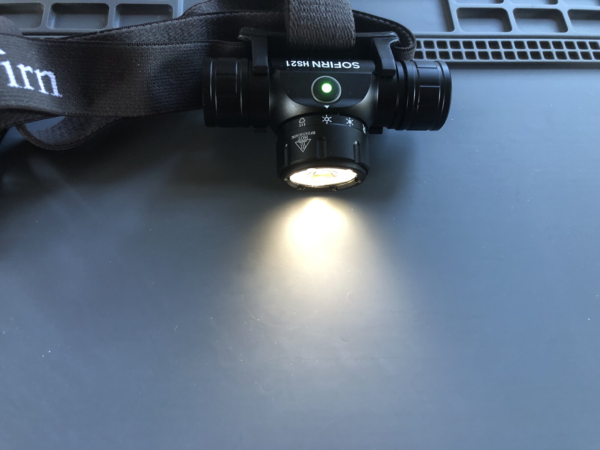

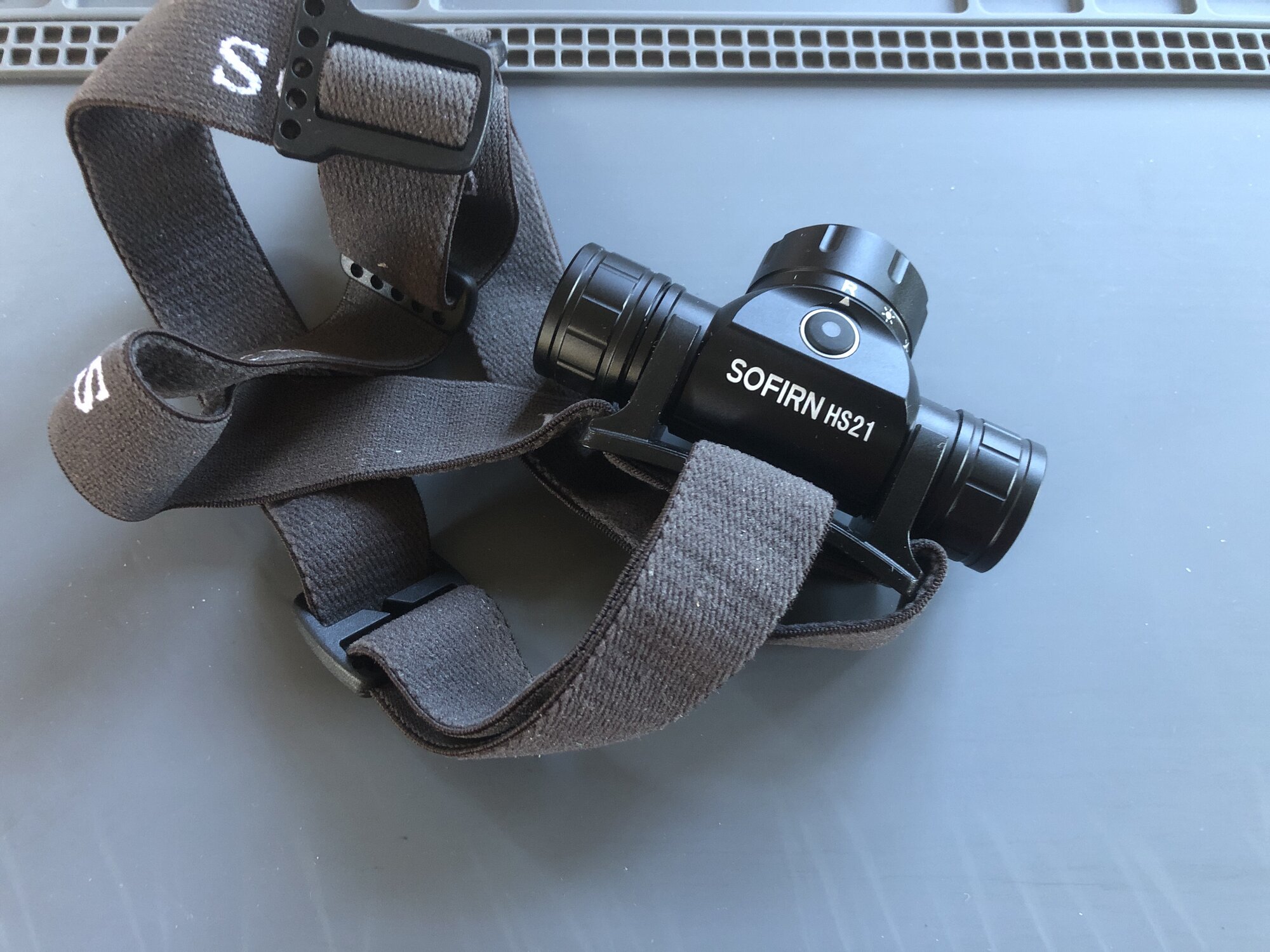

This is a very nice headlamp. It fits well and is very comfortable.
The rotary Beam selector is easy to use to reach each of Four Beam types. Each Beam type has 4 outputs, They each memorize their last used output.

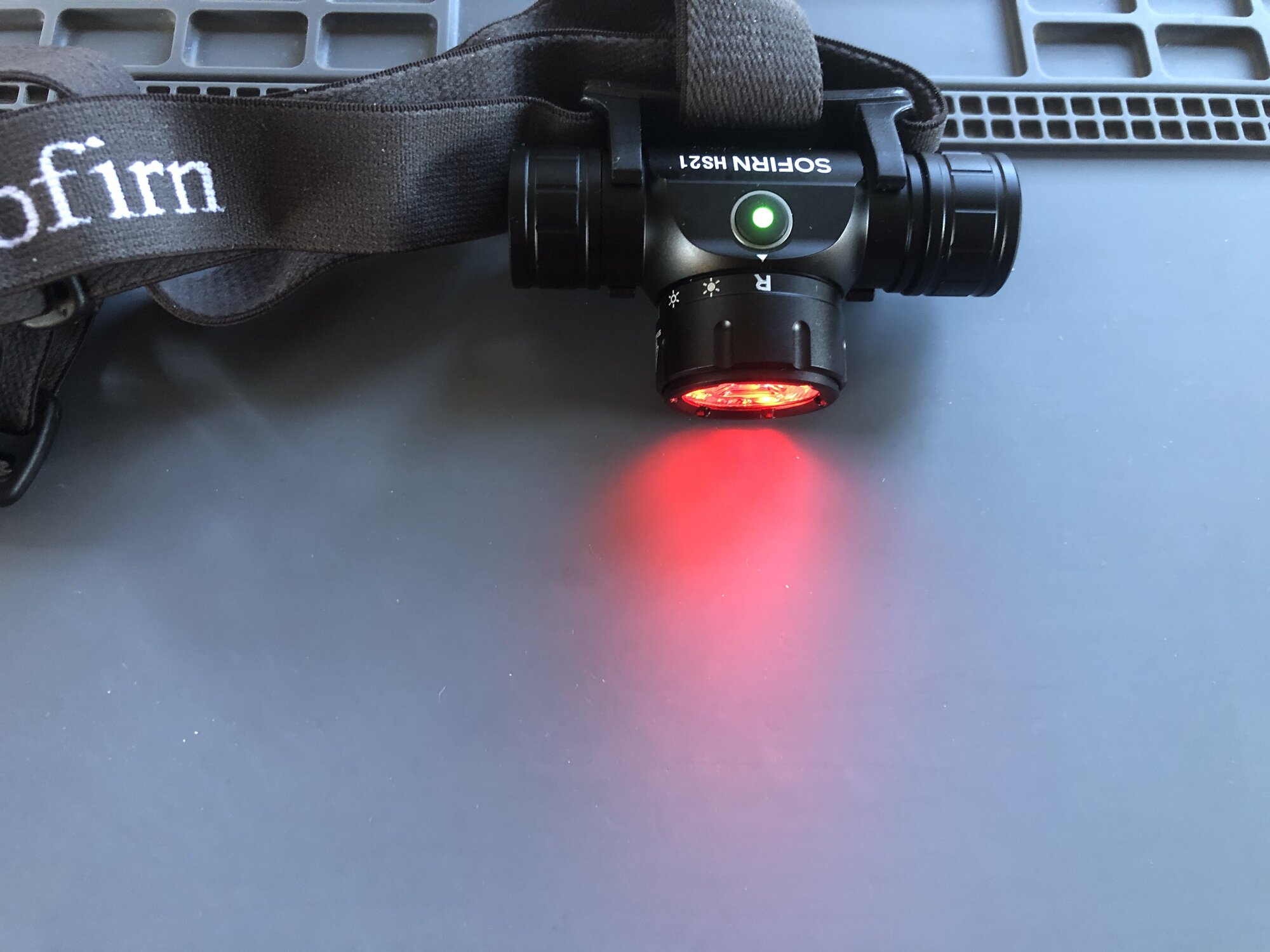

Red Flood:

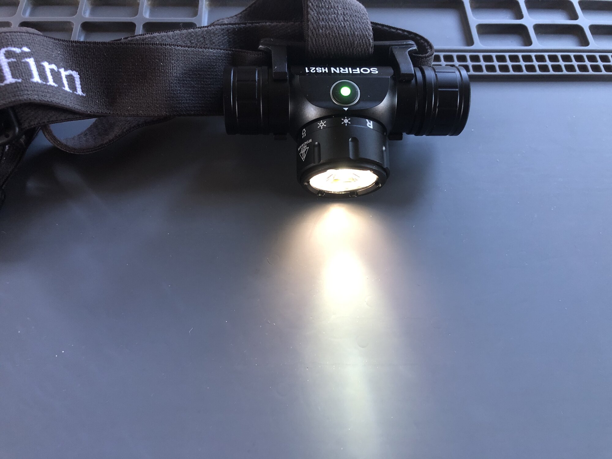

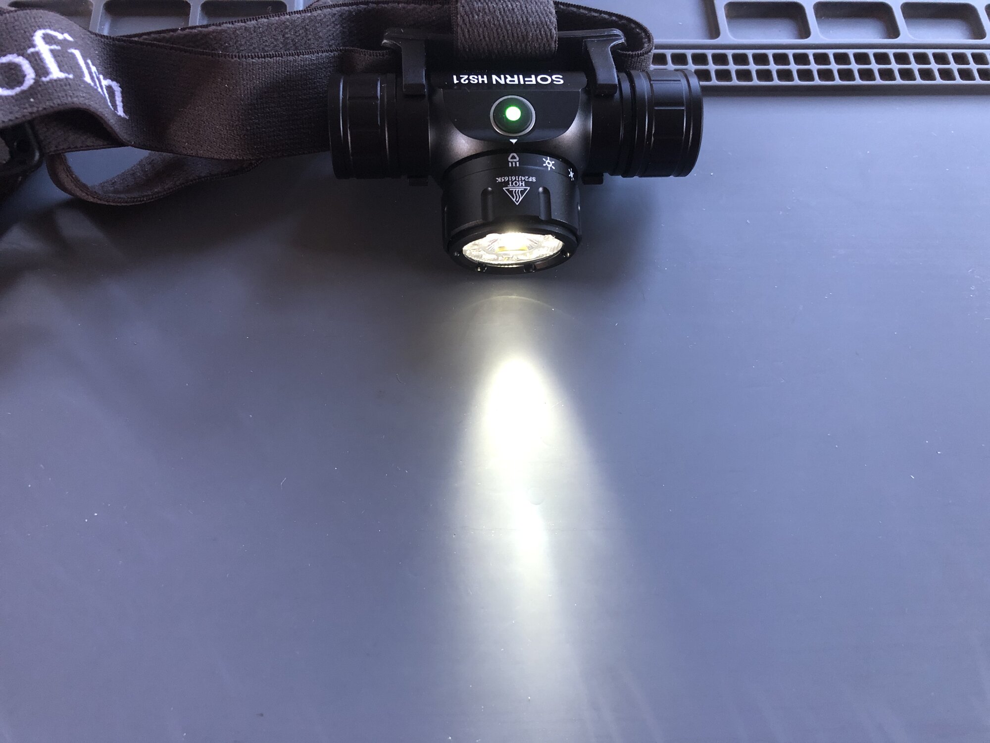

White Flood combined with White Throw:
White Flood:

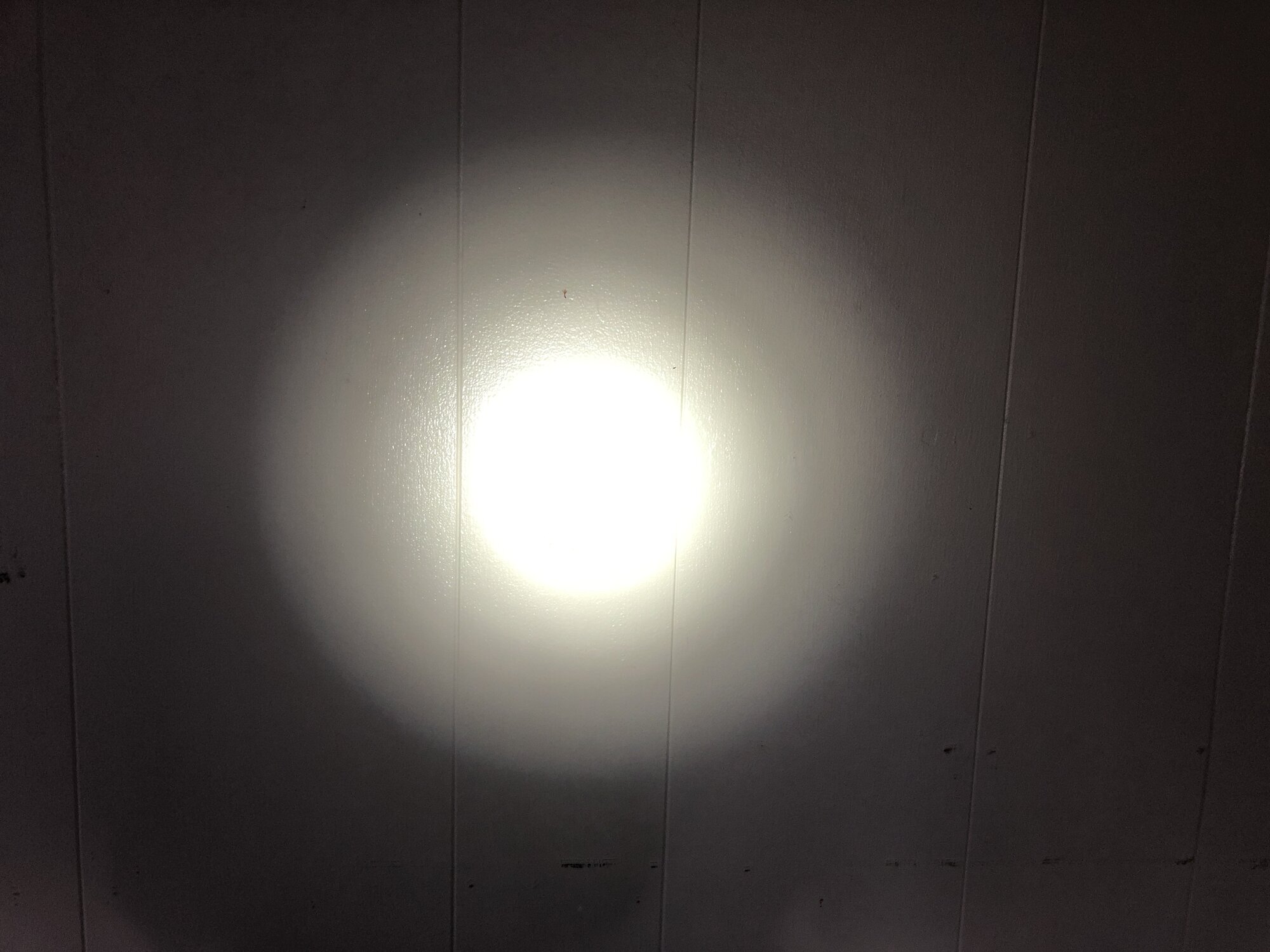

and White Throw beam:

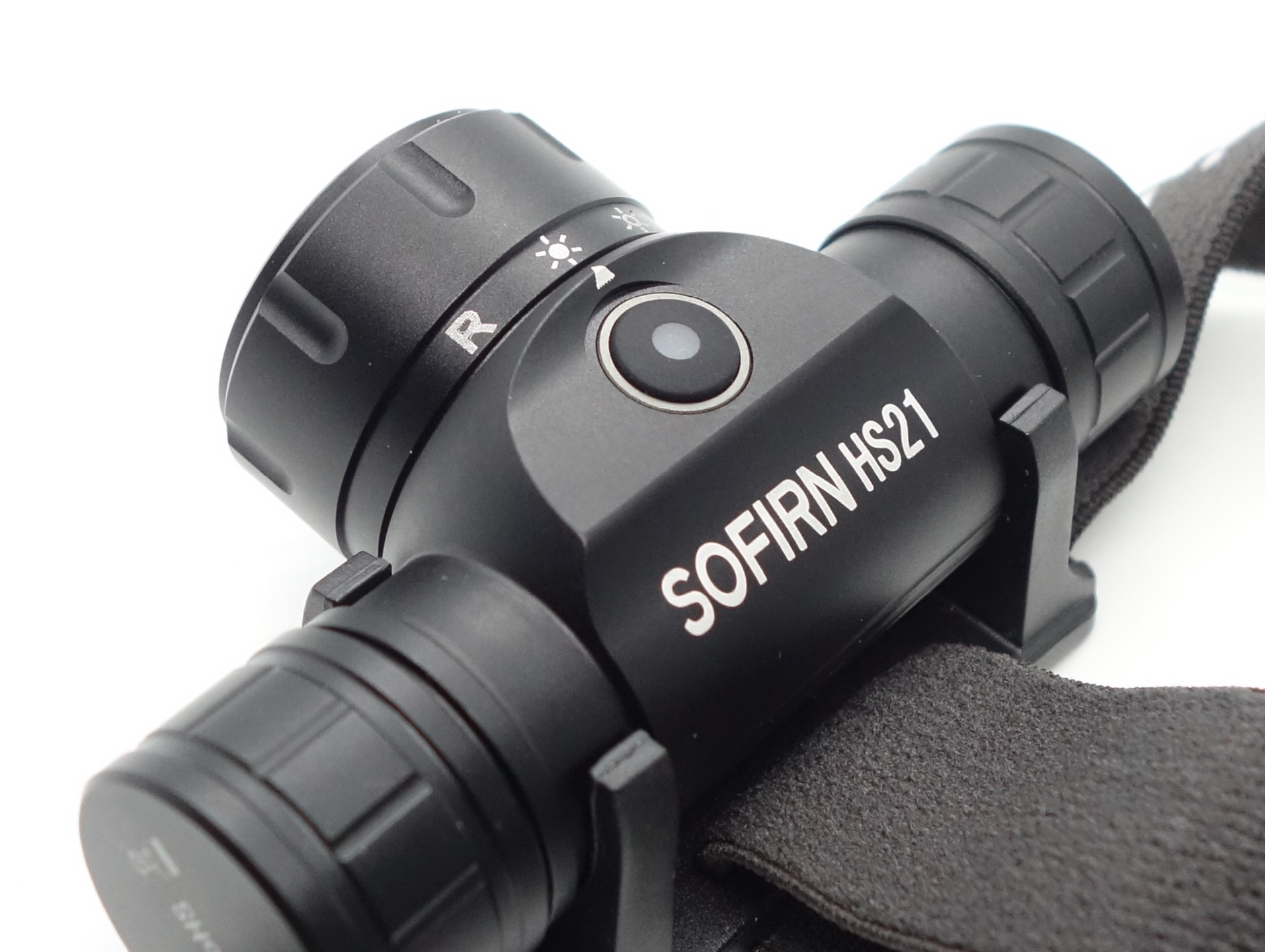

The switch button is easy to use and locate by feel. The switch button also indicates state of charge by showing green or red when first turned on.
The optional motion sensor switch is easy to use. It defaults to off and can only be enabled by triple clic from On. The motion sensor gets disabled when the light is turned off. There is no way that the light can get turned on accidentally by the motion sensor.

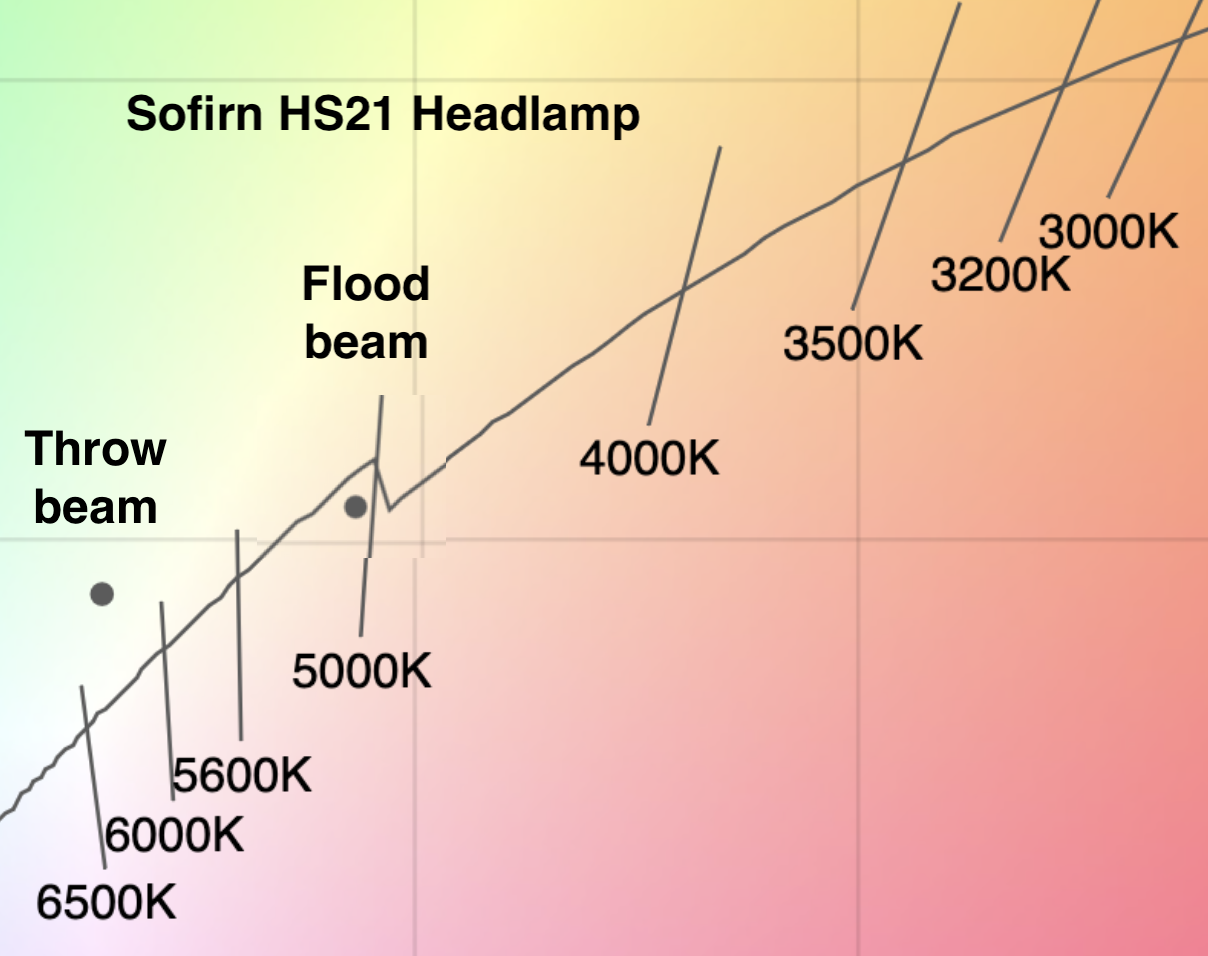

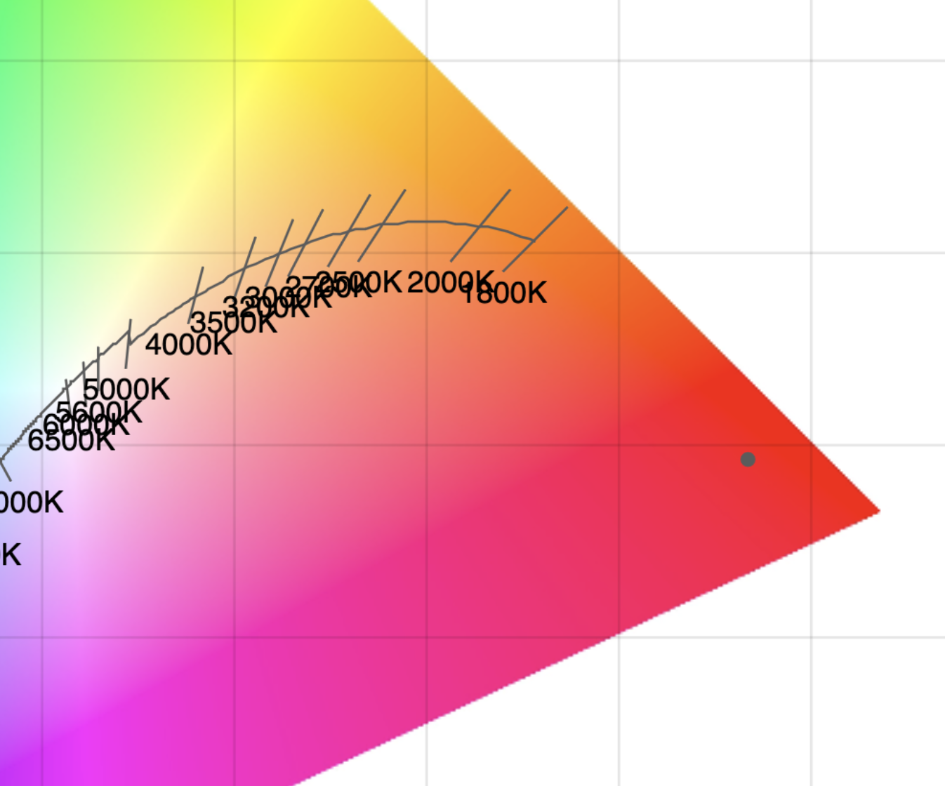

Opple 3 data at the lowest output level for each mode:
Flood and Throw beams:
Red Beam:
There are Four positions on the Rotary Bezel, which selects the following LEDs:
1. The Red LEDs are 620 nanometer, with a floody low mode of 0.2 lumens that seems suitably low for dark adapted situations. The beam is wide and floody with even diffusion and no artifacts.
2. The White Throw LED combined with the Floody LEDs produce a combined beam of about 5900K CCT, w CRI 76 and Tint DUV of 0.0063. The low mode of 1.8 lumens is suitable for illuminating the ground near our feet, or something in our hands or on a table.
3. The White Flood LEDs are 5100K CCT, CRI 100, and Tint DUV 0.0016. The low mode of 1.5 lumens is suitable for illuminating the ground near our feet, or something in our hands or on a table. The Tint and Color Rendering seem excellent and the Floody beam is nice and wide, and evenly diffused. A very pleasant close range mode.
4. The single Throw LED is 6300K CCT, CRI 68, and Tint DUV 0.0096. The low mode of 1.4 lumens has a tight focus that can illuminate the ground a couple of steps ahead. The beam has a nice bright round hotspot that reaches forward very well.

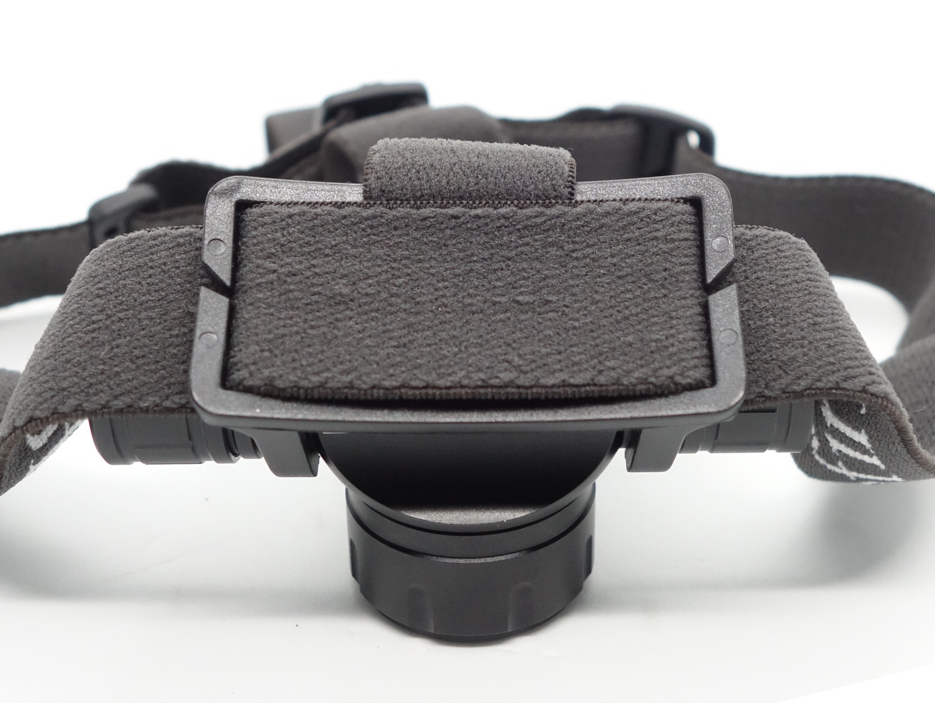

The UI seems really great for a headlamp, especially as it looks like it has a motion sensor, but it looks very front heavy. How'd it feel on the head?
While it'd be significantly less runtime, I'd be interested in a 14500/AA version with only low levels (which, tends to be mostly what I use on headlamps, anyway) to cut down on the bulk/footprint, or maybe even if they put it in their more "triangular" footprint, so it'd lay flatter against the head.
Overall, with the infrared sensor, dial, and high CRI flood, seems like something worth keeping an eye on to catch on a sale...
thanks for commenting
when the top headband strap is adjusted to rest over the top of my head, the unit sits securely and comfortably.. it will not work without the top strap adjusted.

Im finding the motion sensor, which is only active after doing 3 clics from On, is very unreliable. Sometimes instead of getting mode switching the light just turns off by itself, or after I wave my hand past the sensor.
At other times, when motion sensor is activated, output will change unintentionally, due to moving the sensor past some inanimate object.
imho, the motion sensor feature should be ignored.. Just dont enable it at all. The light works fine with the button, and it does have both red and white beams that are very useful.

I just just learned that the sensor induces parasitic drain if exposed to bright light, when the light is off, details here, so I have covered the two sensor holes with some black electrical tape. This means both the parasitic drain and the motion activated mode switching are completely disabled now.
