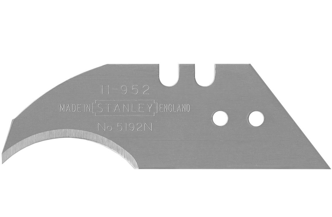

Razor Blade Fitment.
Razor blades with one, two (most common!), three, or four notches can be used in the TPT, and all these notches can be used for the forward deployment, i.e. without exchanging the blade side. That's because the titanium nub is located right at the cap lifter. Because of that freedom an IRWIN 4POINT razor blade enables four deployable positions and a max. cutting edge of 25.7mm, fabulous!
The TPT Slide is more limited with regard to which notch can be used for the forward deployment and how many deployable positions (namely max. two, to be exact!) are available, for example a 3-notch blade can be held in notch1 only...
...while a 4-notch blade, held in notch1, has an invalid position0 (1.0mm, ouch!):
And what about rattle, play, in the deployed position? Well, that depends on the notch tolerances of your blade product AND in which notch the blade is deployed. Because of geometry the further a blade is deployed, the more up-and-down play (in degrees and amplitude) it will exhibit. Here the example of the 3notch safe-carry insert:
And with a clipped trapezoidal blade (the IRWIN 4POINT blade is a segmented razor blade allowing for 4 fresh razor points) the geometries produce extreme cases. Here the minimum possible case:
Here the maximum possible case:
Generally speaking, I'd say that my TPT unit has a tiny bit less play than my TPT Slide unit and that either TPT product has little blade play compared to my Stanley Quickslide Sport MkII, so I'm all good here.
