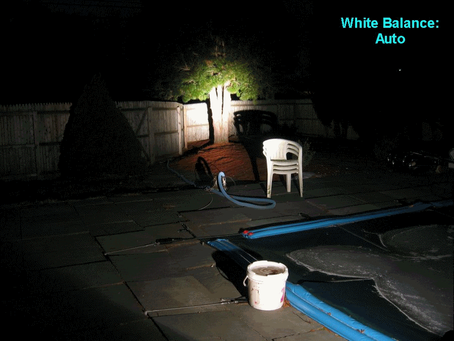

Another important thing to emphasize is that the camera and settings can have a profound impact on how a light's performance is perceived. Click on this thumbnail to see the effect on my just changing the "White Balance" setting option on my Canon Powershot S45. Otherwise the shots were all identical of a SF M4 (MN-61 Incan) with exposure of 5 sec & 4.5 F-stop.
(Larger GIF file is 875K)
None of these images looked like what it did in person.
No
As was mentioned in an earlier post (apparently unnoticed), my thread Finally, an LED light that rivals an incan's color rendering contains a lot of discussion about white balance and visual perception, largely thanks to orcinus.
Your eyes and brain will adjust to the CCT of the illumination being used in a similar (but far from identical) way to the way that a camera (or software program like photoshop) can adjust color balance via the white balance setting. This is the reason for the white balance setting. If you set the WB for "daylight" or even more extreme "cloudy daylight" and then take a picture of something illuminated under a standard household lamp, it will look impossibly yellow in the picture. It will not look like what it did in person. Conversely, setting the WB to "tungsten" and then taking a picture outdoors on a cloudy day will make everything look impossibly blue.
This on-the-fly adjustment that the brain makes is the reason why CRI is defined as 100 for any blackbody, any incandescent, regardless of its CCT. (Not that I agree with this, mind you).
However, the CCT of illumination is noticed by people, nonetheless, and not just .1 percent of people. It's noticed by the majority of people, and by "notice" I mean consciously noticed. So, the eyes and brain do not so fully compensate for things that objects under candle light are seen as just the same as under a Cree LED of the same brightness.
So, a camera set to a white balance that is totally wrong for the actual light will capture an image that looks way off from what you actually saw. But the camera can also be set to a white balance that makes objects illuminated under candle light look as if they were illuminated under nice white light. There is an intermediate setting that will compensate, but not over-compensate, for the white-balance in such a way as to render as faithful an image as possible to what you saw in person.
But this is only the white balance, and doesn't even begin to touch other, more important differences between the eye and the camera, at the top of which list is dynamic range.
