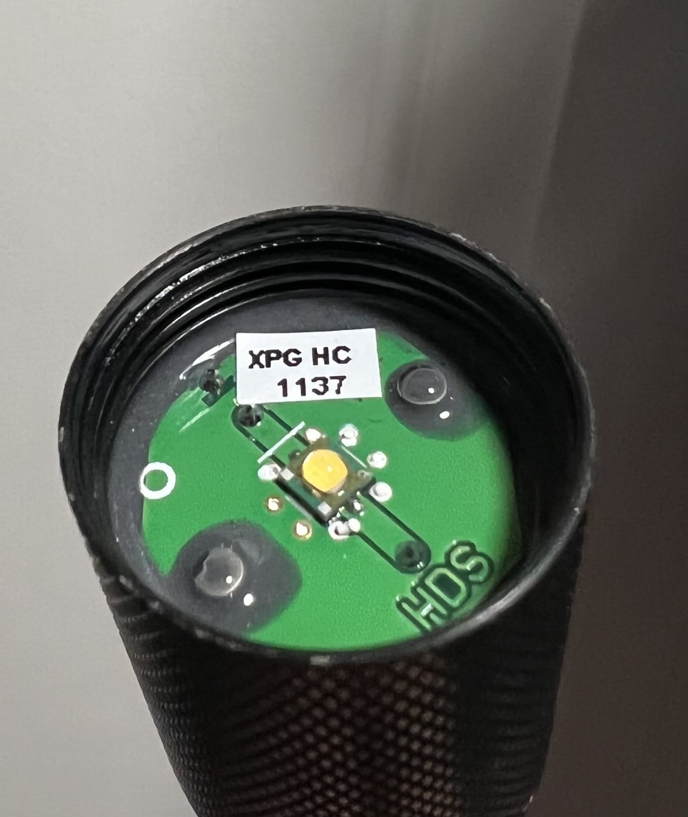

I have an older EDC Clicky and am trying to figure out what LED it has. I get that it is an XPG. What does the HC and numbers mean? It is a very warm (I would say around 3000k) light. One of my all time favorite lights.

It could be. It seems warmer than 3700k. To me it is more 3000k to 2700k.
Should be 3700k. Looks the same as the one I have. Mine is also warmer than the NB35 I have, considerably so. Agree around 3000k or maybe even warmer. Attaching photo of my light’s LED for reference.
I wouldn't have guessed 3700k. Thanks for the information. Is yours 120 lumens (green ring) as well?
It is a Cree high CRI XP-E. Without putting it on a sphere, I can't tell you the exact color temp but probably around 3k as mentioned earlier.

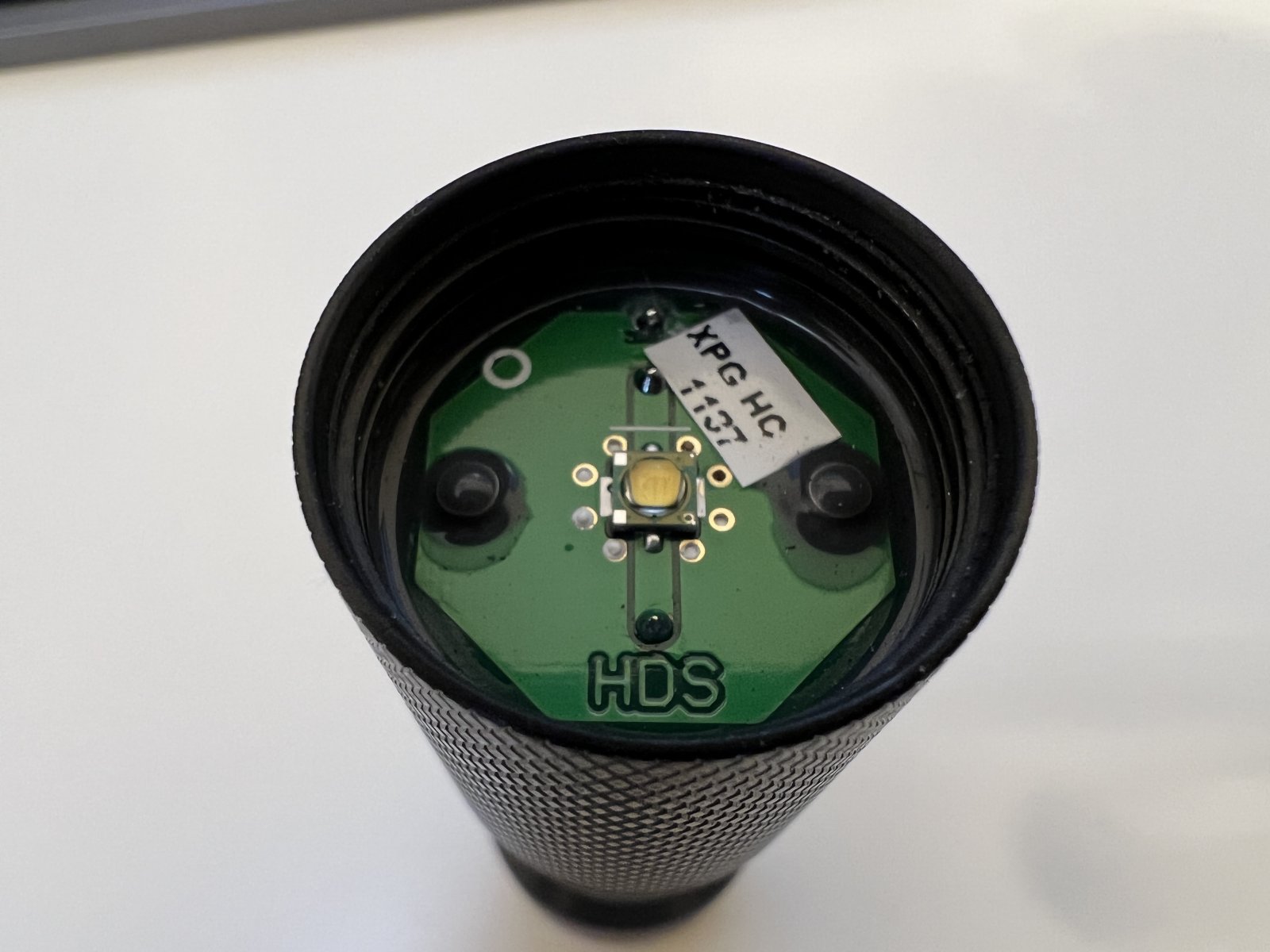

I have one also. Mine has a blue sticker on the spring. I think blue is 140 lumens? 🤔
One of my favorite lights. It was a clicky but had it upgraded to a rotary a while ago. I always thought it was sold as 3700k. At least that’s what I have in my notes. It does appear warmer than that tho.

So a Cree HCRI XP-E 3700k. It truly is my favorite light. I put my HDSRB on it and can't believe how much throw it has. Perfect combination.
