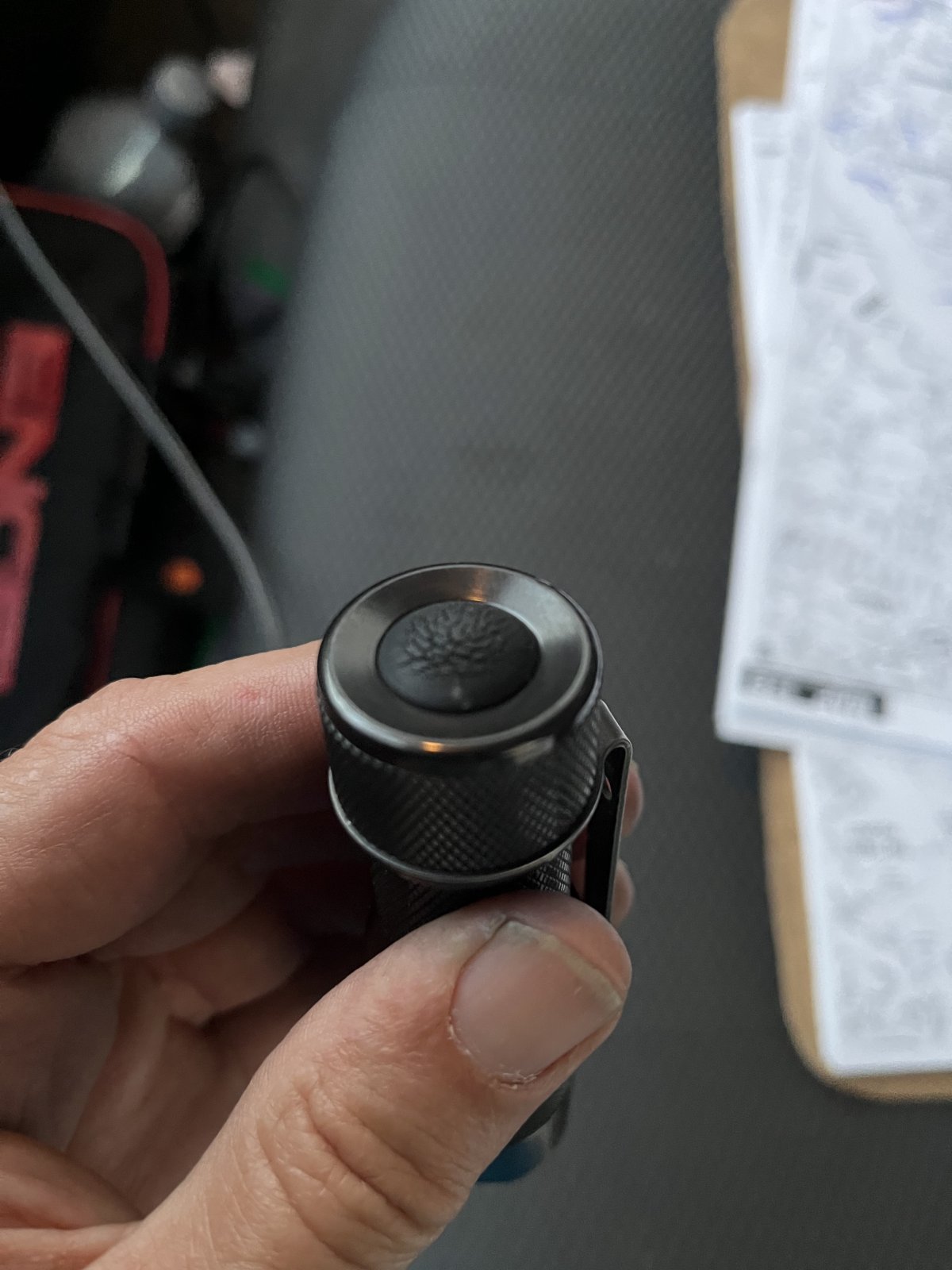

jimmy1970
Sep 6, 2008
1,048
Brisbane, Australia
Hi,
Does anyone know where I can source new HDS flat tailcap rubbers?
As I was a HDS dealer at the time, Henry shipped me a few spares years ago but they’ve all split and gone to heaven.
My last cap rubber is ready to split too. I sent HDS an email 2 years ago and didn’t get a response!
Any assistance would be appreciated.
Thanks,
James….🙂

Hi,
Thanks,
James….🙂
You're lucky it's the clicky version. He has a lot on his site
Thanks guys but the website wants to charge me $75 USD for shipping to Australia for 1 tailcap rubber!
