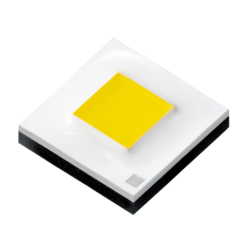

Sounds like you need to salvage the emitters by dedoming them and selling them as 4300k!
There will be no dedoming by us... unless I can convince Henry, but I doubt he will want to do that. What the end user chooses to do is up to them. I may try it on one just to compare on the sphere... a 5000k domed and dedomed side by side might be an interesting experiment with actual data from the integrating sphere. I'll have 3 built out to play with next month.

Right from Nichia's Data Sheet. The 5700k should NOT be hitting right smack in the middle of 5000k especially with the narrow bin we have. Nichia is either playing silly buggers or figured that since most flashlight manufacturers lie about everything, they might as well join the bandwagon. It isn't how we do things here. It is why we spent tens of thousands of dollars on an integrating sphere rather than $50 on some light meter or better yet, some phone app.
We expect our customers to actually KNOW what they are getting and not give them some regurgitated info from a data sheet... which is often wrong.
Yes, data sheets **** me off when they are inaccurate... so in general, they mostly **** me off, but Nichia's have not been this bad in the past regarding Kelvin temp... which makes me think they mislabeled the real.
It isn't that they are bad emitters. Far from it. The 5000k is very nice in my opinion, and I will be putting some in a few lights for myself to play with, but they are NOT 5700k.

I’ve removed the dome on a few 519a emitters. I used the slice and scrape method. Pretty easy as long as the emitter is fully exposed. The quicker method of flipping the dome is rumored to introduce air between the glass and phosphor and reduce output. There’s also a theoretical a risk of completely ripping the glass off the phosphor.
It is a little like getting a Snicker's candy bar in Japan. You fire into it expecting a good ol' USA type Snicker's only to find it has about half the sugar... not what one is expecting... and at first, a bit disappointing, but one may find they like it better over time... we shall see.
I suppose the wrong stickers were pasted on some party and someone from the management does not want to admit the mistake. All subordinates are subject to it.
Some large companies hate admitting mistakes, especially such small. For example, what happened in Fukushima and how the engineers and company management acted. Now they generally want to drain the radioactive water into the sea.
I'm waiting for the new NVSW219C-V2 with a flat dome
