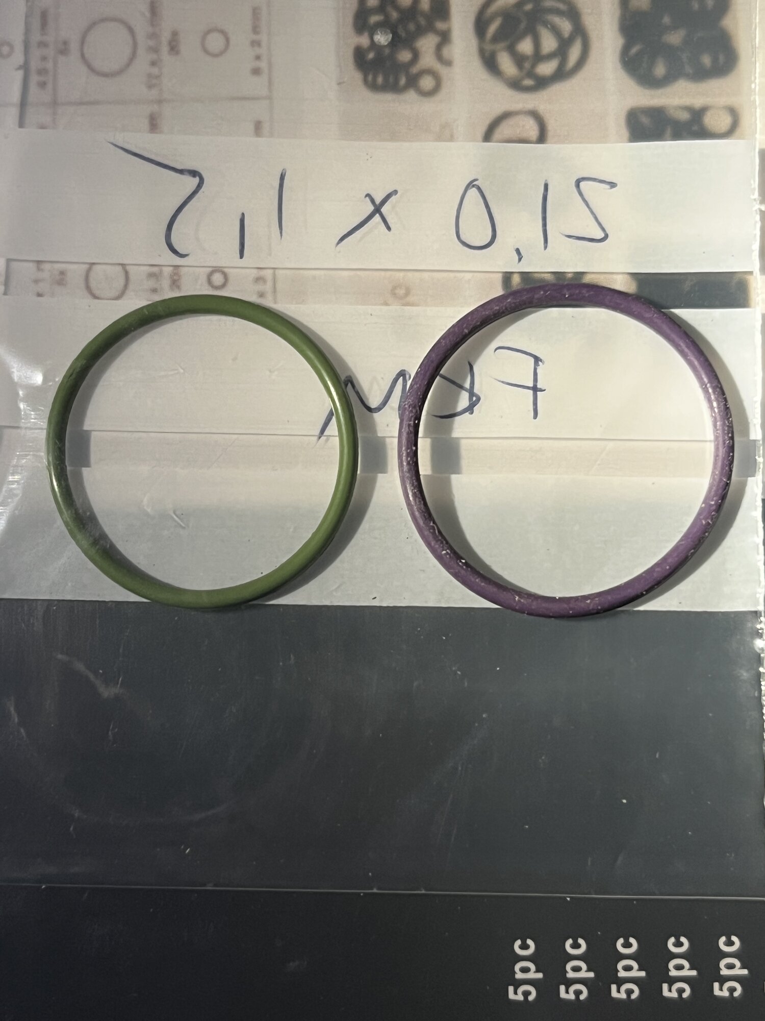

A wee little update with both good news and bad.
The good news is that something akin to a Malkoff boot fits perfectly in the HDS except it lacks the nub to actually let it press the button, the button is 14mm wide and the rim/flange/whateveryouwannacallthething is 19mm in diameter and 2mm thick, make of this information what you will.
Indexing the PCB after putting it back was made through this process, you'll have to follow this very specific process and it's so advanced you might want to read through this twice. Ready? Ok, you tighten the PCB and retaining ring until snug, put it on the body, check high and low, if both are fine you're good to go. If either isn't as it should be, adjust it by then instead, first snug it down.
I've yet to receive the o-rings, but looking at the spare parts for the Malkoff and comparing sizes i'm half sure already that 20,57x1,78 will work in it, otherwise i'll just have to get others and keep trying. It's a fun experiment regardless.

Aren't you happy there's people like me keeping you in business? All jokes aside, i did manage to put it all together again, being a CNC teacher by trade does have some perks. I'm not overly worried about getting things to work as they're supposed to, even if it might take a little while to get the stuff needed to fix it.

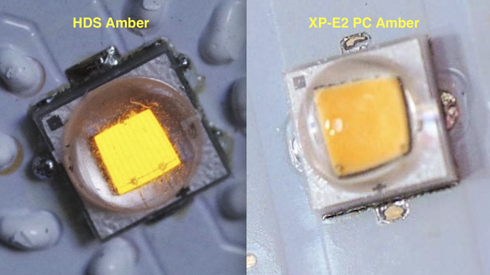

Probably a Cree XP-E or XP-E2, as there really aren't that many options for direct amber in the 3535 package that HDS uses.
That is my guess. The Amber LED looks like XP-E (or XP-E2).
I posted a picture of my amber HDS years ago here:
jon_slider
Mar 31, 2015
4,892
silver for the XP-E2
thanks!
photo of WOL's HDS Amber and MtnElectronics PC Amber:
Silver package looks like a match

Thank y'all very much. I'm going to order a few single LEDs and see how it looks.
