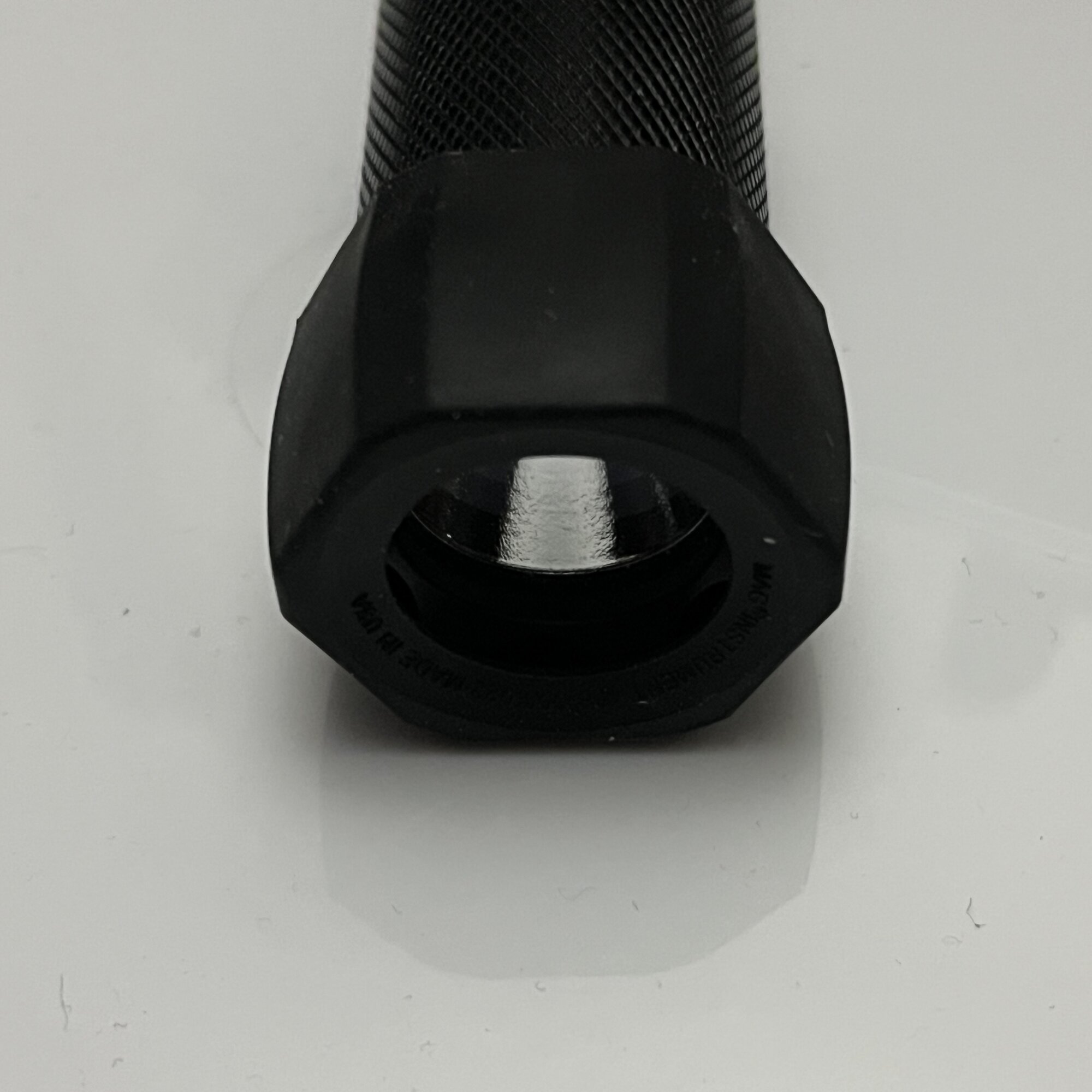

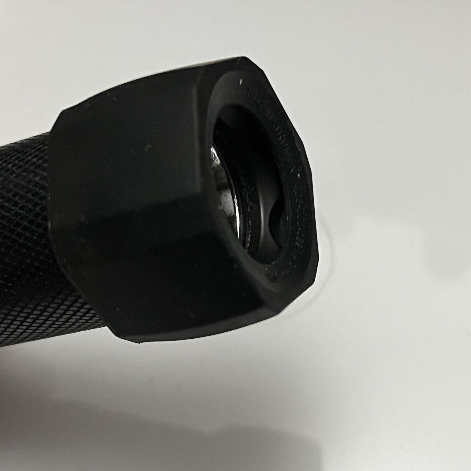

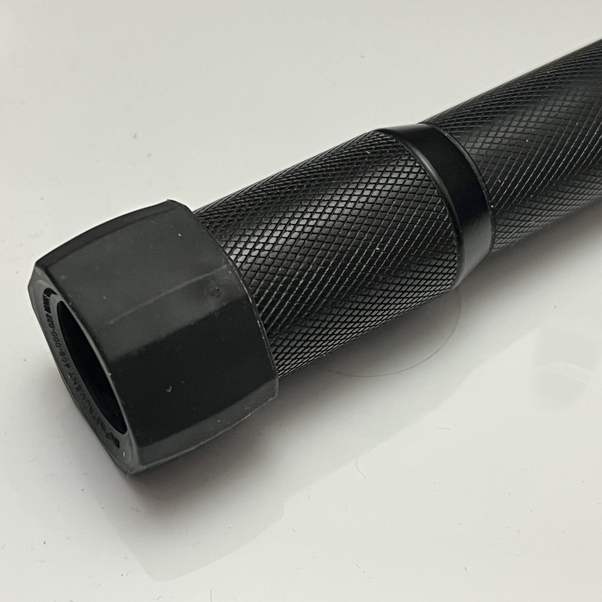

I purchased F04 Diffuser but the inside diameter is too large. It seems that this was F04-A.
Yes, the old F04 fit 1 inch diameter lights like the HDS, but the F04 is no longer made. It was replaced by the F04-A for 1.125 inch diameter lights. The F04 can sometimes be found on the secondary market. Alternatively, the translucent cap from an ordinary plastic water bottle can be used as a diffuser on an HDS.
I purchased F04 Diffuser but the inside diameter is too large. It seems that this was F04-A.View attachment 68386
When I see the Picture with your red, blue and White diffuser, the White one is a F04-A. It is clear to see. I am sorry you got the wrong diffuser.
Today F04 diffusers are not easy to get. Once in a while they can be found at ebay for ~18-20USD.
I am glad I got some new F04 in Germany some time ago for small money. My 1" Surefires and HDS lighs have enough diffusers.
If you buy from this ebay, the shipping cost is double the price of the item. These filters can be found on the second market in Japan, so we will continue to look for them. The F04-A I purchased by mistake was the right size for the elzetta alpha, so it didn't go to waste.
I meant to reply to this earlier but i completely forgot to. See if you can find the accessory kit for Maglite Mini, the diffuser for that fits nigh-perfectly on a HDS flashlight.

..., the shipping cost is double the price of the item.
That is the problem, I have some "spare diffusers"...
... but shipping from europe is like stealing money for a item that is maybe $10! My guess on shipping from germany would be ~20-30€

International shipping can be expensive, I too focus my international shopping and ebay on items I can't buy domestically. And nice collection picture!
I didn't know you could also use accessories for mini mag. Sounds like a good idea to prevent rolling.
It's decent, the package includes a clear, blue, and red lens as well and some pocket clip stuff, it works on my Surefire Tactician, all of my BLF FW3A, the only flashlight of that form factor it doesn't fit snug and nice on is ironically the Maglite.
