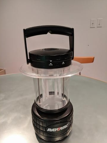

In the past I use an assortment of large and small flashlights, some LEDs and some incandescent, but the most practical one I have so far is a Rayovac camping lantern that has two fluorescent bulbs and it seems to cast a light over a fairly large area and it uses 8 large D cells.

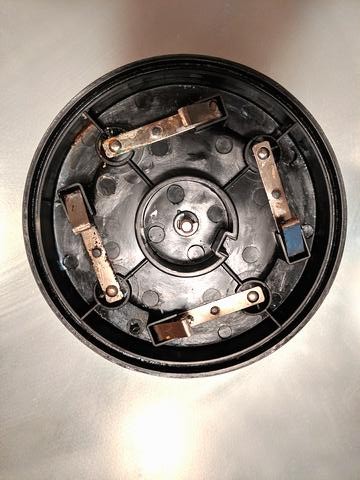

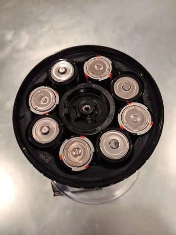

Unfortunately, when the latest hurricane approaches us in Florida I found I had battery leaks inside the lantern. The lantern DOES light up when I turned it on, but several batteries were leaking badly. I cleaned up the leaks as much as I can, then inserted 8 new D cells and now it doesn't work at all. I don't understand, it was working with the leaking batteries, and after I cleaned it all up, it doesn't work, AT ALL. Here are some pictures of the inside in case someone spotted something I may be doing wrong.

Did you clean all of the contacts up? Use vinegar and cotton swabs then maybe finish them with some fine grit sand paper. You may need to open it up even more and clean inside where the switch mechanism is.

Regarding your lantern. I believe that you have the batteries installed improperly. IF you look at the connectors inside the battery case, half of them are spring steel, the other half are slightly raised buttons. The batteries should be aligned such that the negative contact of the battery touches the spring, and the button side (positive) contacts the button. In one of the pictures I can see that there are two buttons side by side and two springs side by side. Position your batteries according to them, see if that works.
