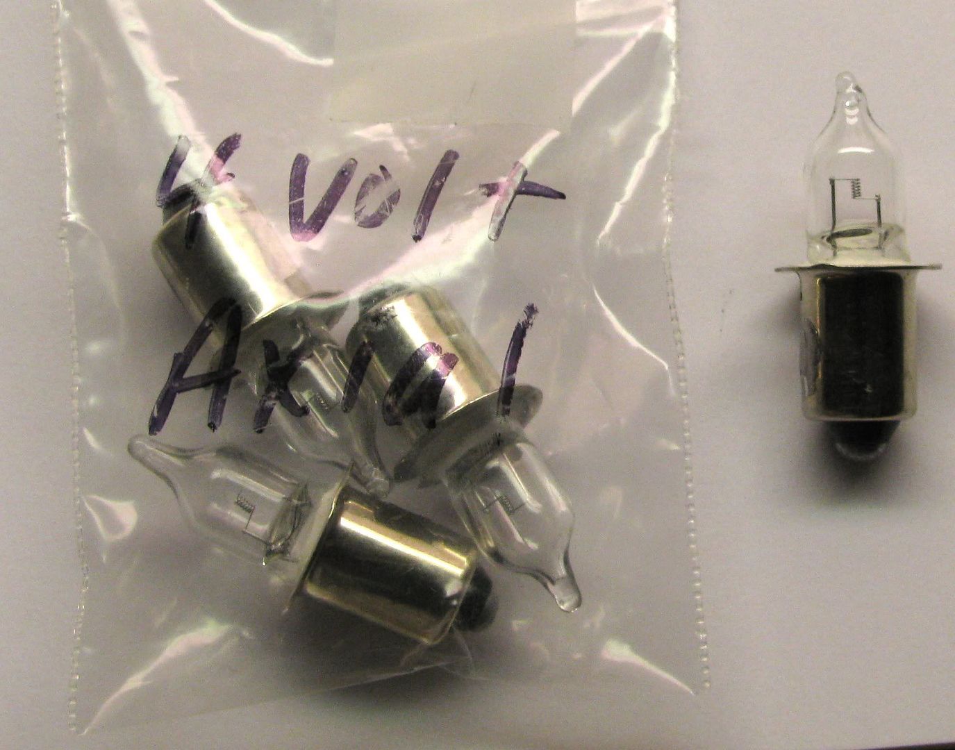

Lux, what kind of incand bulbs can we run with a // setup like this? Or would it be limited to running LED setups only because of the low voltage?

Thanks, Lux. You're right, I want it for LED applications, including a KL6/P7 head.
