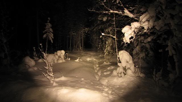

I did some runtime tests with my MG PLI MC-E warm white, tested with 2200mAh 18650 to 50% brightness.
I'll add the graph later.
High, 300 OTF ~50 min
Med, 110 OTF ~3 hours
Low, 40 OTF ~8 hours
Lumen readings are guessimates based on lightbox readings compared to Fenix TK11 R2, Fenix TK20 and Quark AA neutral white with 14500.
There was no difference in brightness between 18650 and 2xCR123.
With 18650 the light gets hot on high even though I used a fan.
Fenix LD10 Eneloop.........47 Quark AAw 14500......Fenix TK20...................MG PLI warm white
