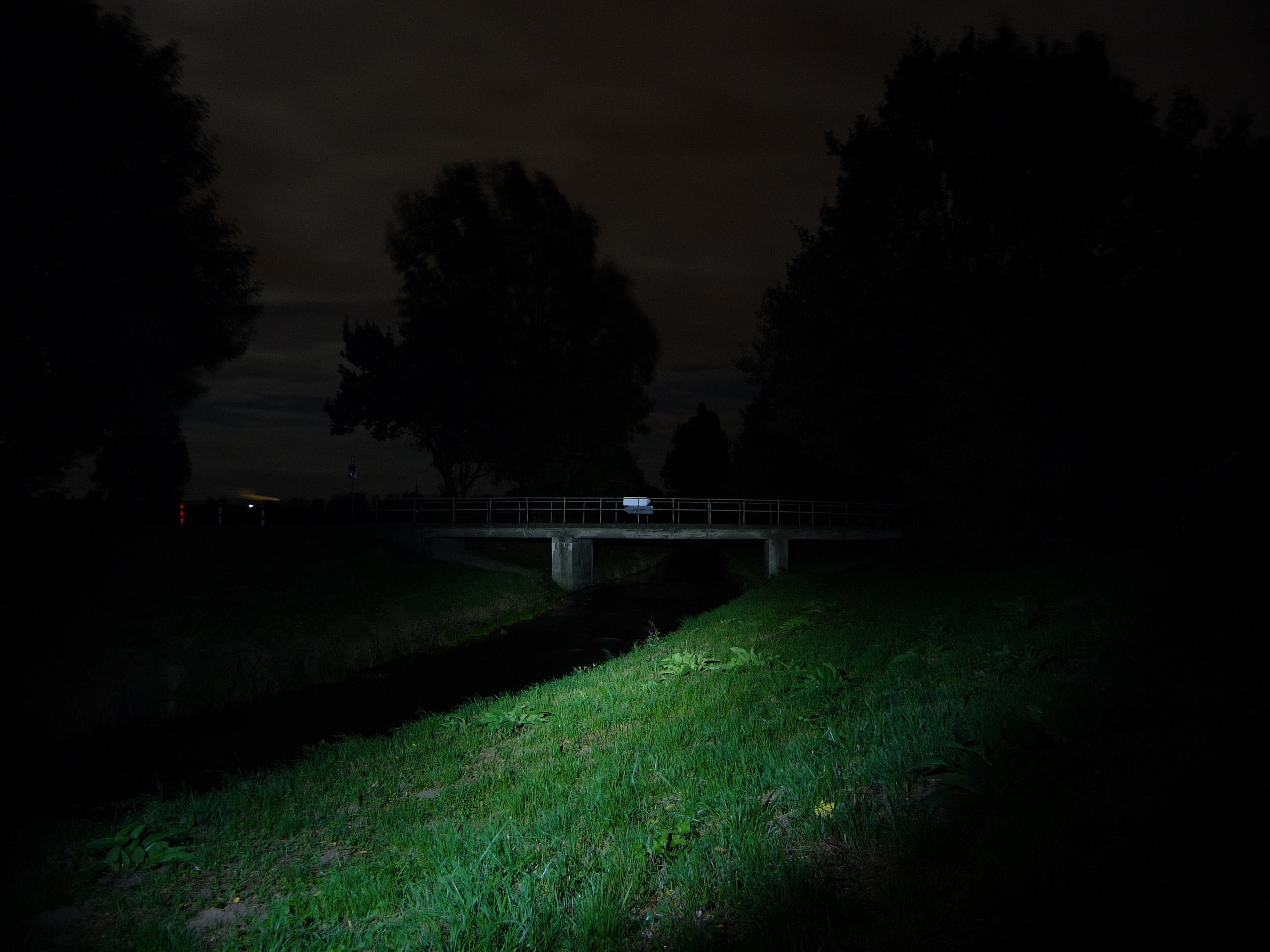

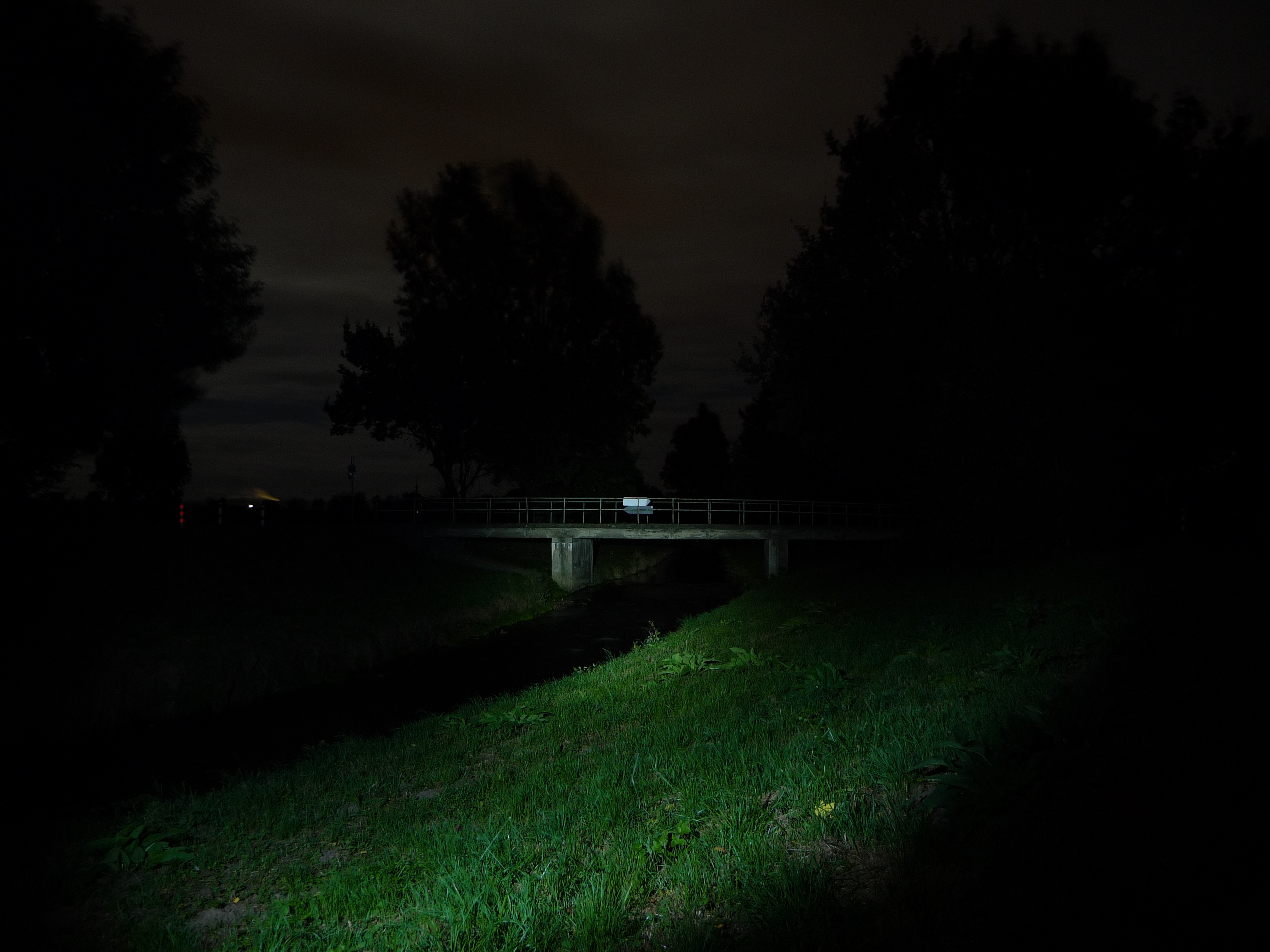

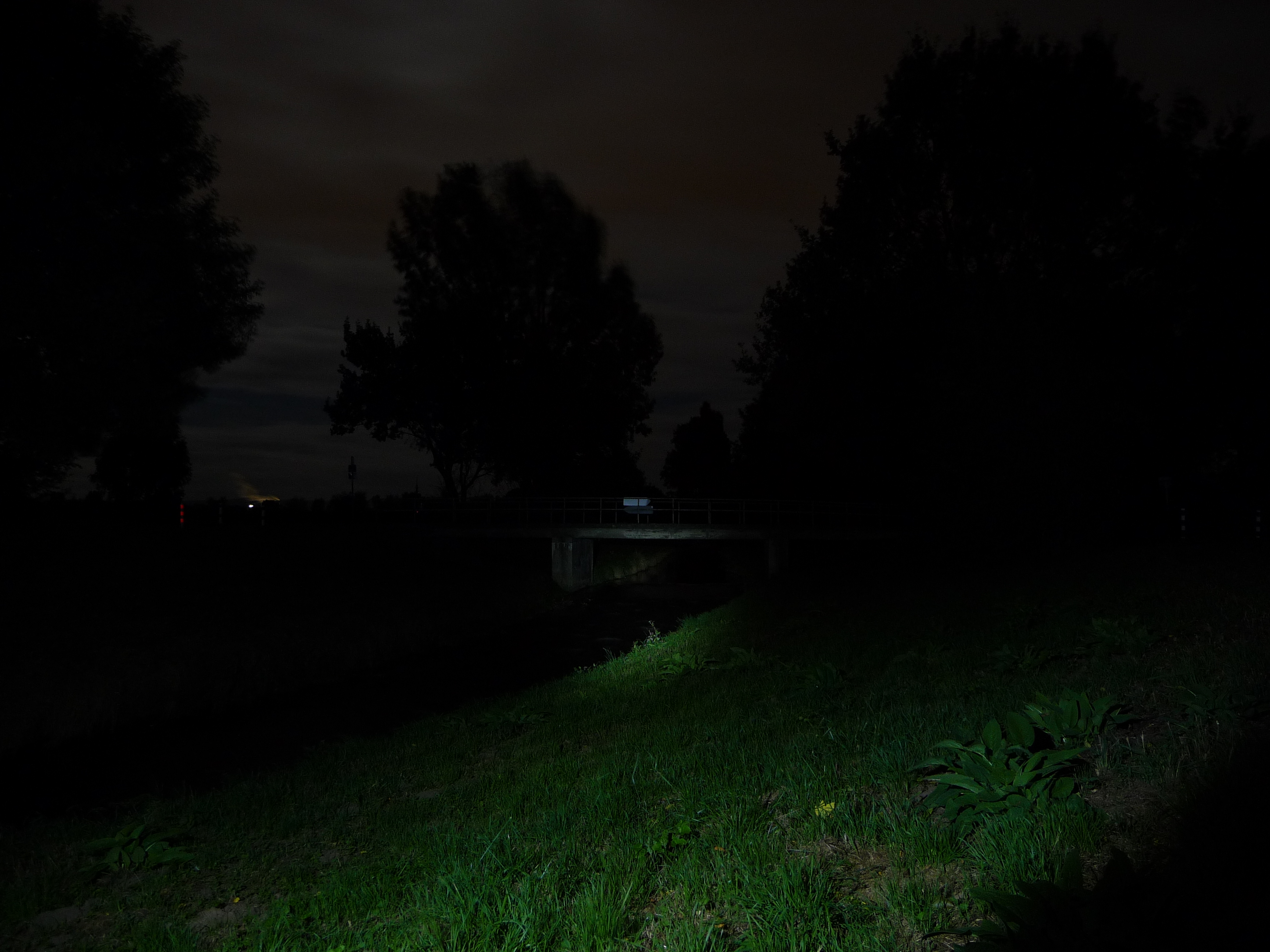

I did some spontaneous outdoor beamshots when I came across this location, having the Xenide on anyways for some photos. These feature my CustomLites SST-50 and SST-90 drop-ins from nailbender that saw their first outdoor use at that point, IIRC. 🙂
Distance to the bridge was about 35-40m, the targeted opposite shoreline behind the bridge should be at least 50m away. All lights except for the Xenide running on fresh protected 2600mAh AW 18650 cells.
The settings for all photos are f/3.3, 8s, ISO100, 28mm. Click the images to see the original images.
Wolf-Eyes 6AF Sniper, Digital Cree R2 WC low Vf HO 3.7v-6.0v D26 4 mode:
SureFire 6P, CustomLites Luminus SST-50 3 mode 2.5A regulated:
SureFire C2, CustomLites Luminus SST-90 3 mode direct-drive:
AELight 25W Xenide Class 1 Division 2 with diffuser filter:
AELight 25W Xenide Class 1 Division 2:

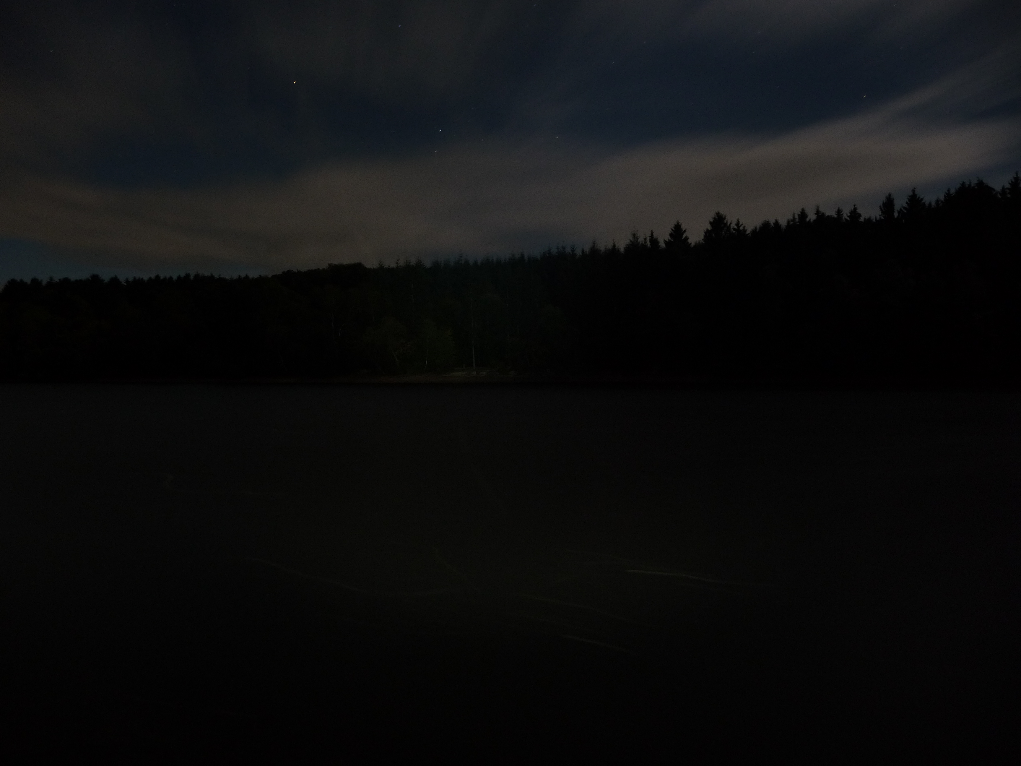

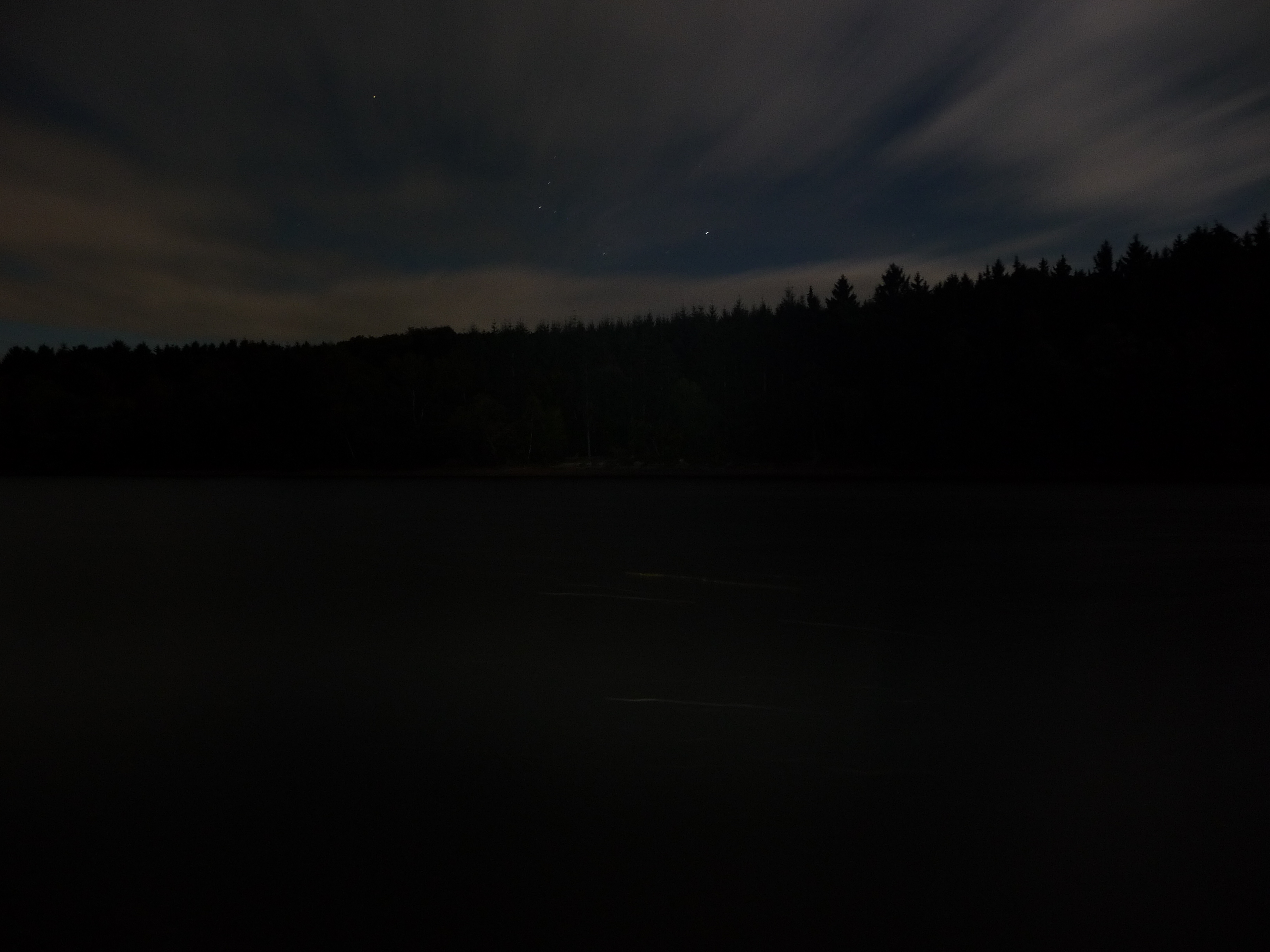

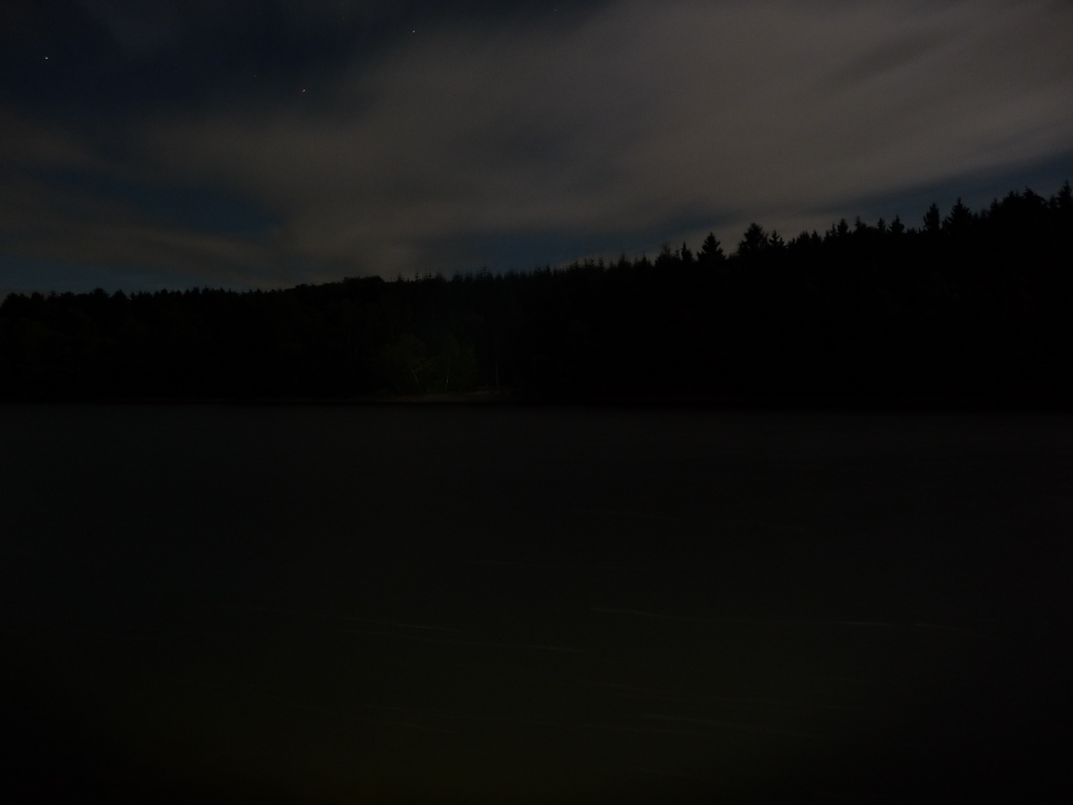

Later that same night I also did some longer range beamshots at a lake.
These aren't as realistic as the ones before. They are somewhat overexposed, but the ones with lower exposure turned out nearly dark except for the Xenide. The camera apparently does not seem to model the human vision good enough in the darkness, especially at a distance.
Distance to the targeted line of trees at the other side of the lake should be roughly around 170m.
The settings for all photos are f/3.3, 30s, ISO100, 28mm. Click the images to see the original images.
Reference:

NICE! I guess I need my 4th nailbender dropin now 🙂 I have two D36 MC-E as well as a MC-E D26. The SSTs are looking awesome. Especially compared to the Cree R2.
Am I seeing this correctly, the SST-50 throws further while the SST-90 provides better flood?
Thanks for the beamshots!
Eric
Re: Outdor beamshots: WE R2 / nailbender SST-50/SST-90 / AE Xenide
Correct. The difference does not really show on close range indoor white wall beamshots, it just looks like a different sized hotspot. But outdoors one immediately sees the difference.
The SST-50 has a normal (not too throwy) beam like the WE Sniper (or some Fenix PDx/LDx/etc.), just a good deal more powerful, whereas the the SST-90 has a really nice floody beam making it an awesome walking light.
