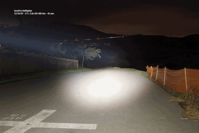

Well I never had the opportunity to take the time to take them both out side-by-side and capture the images. Tonight I did.
Each image was taken with the camera in the same position relative to the lights.
The camera was in full manual with the settings remaining the same within each sequence of images.
For the most part the light were within 4-6" of each other, same height and to the best of my ability the "hot spot" was placed on the same area of the target. The notable exception was the first images on the road, when the lights were separated by about 18", but placed at the same height and line relative to the camera and the target area.
When facing the lights directly there was quite a noticeable difference in the output in terms of the level of discomfort when looking at the light from 100, 200 & 250 yards away. Polarion on top here.
The Hellfighter took up to 5-8 seconds to reach maximum output. Noticeably slower than the Polarion. I had to recycle the switch several times during the photo session to get the Hellfighter to reach it's maximum output. In other words on several occasions the light was turned on, but seemed 'stepped down' for some reason. A recycling of the switch "reset" the light and it reached it's full output.
One you load the first image into your browser, just change the number by +1 then you can see immediate difference in output between the lights. Then you can hit forward or back to get a quick frame-by-frame comparison.

Wow these are amazing beam shots!:huh: Definitely a brighter "hot spot" on the Polarion, and overall it's in fact a much brighter light. Love the beautiful white color temperature!

Those are really nice shots. I knew the PH40 would do well since I have used one and photographed it's beam before. I was surprised that the Hellfighter did not do better. I know Surefire has a bent toward flood as opposed to spot type beams with it's HID's and the Hellfighter does not seem to be an exception.
While the Hellfighter has a much smoother transition from corona to spill, there is a big price to be paid in the form of down field illumination. The irony is that one would think a light assault vehicle that may mount a Hellfighter, like Surefire advertises, would be better served with more light down field and a "less perfectly even beam pattern" where the corona transitions to spill up close. Surefire mentions handheld use, but at 10 lb I wonder who would want to carry one when a Helios is so much lighter(around 4 lb ) and puts more light down field.

Outstanding pics! The Polarion is a stomper. The Hellfighter probably does a good job for what it was designed but I much prefer the farther throwing beam of the PH40. What an amazing machine. :drool:

I redid these two as gif versions that show both alternating every 3 seconds. Kind of easier to see differences.
