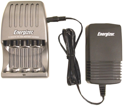

I recently bought an Energizer 15 minute charger (pic) in Canada.
The AC wall wart specs are:
Model: CH15MN-ADP-CA
Input: AC 100-240V ~ 50/60Hz 85W
Output: DC 16V - 4A
As you can see, it's universal voltage input. Also, because the charger module takes DC 11-16V as input, it can be used in a car if you have/make a cigarette lighter adapter plug.
