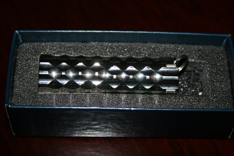

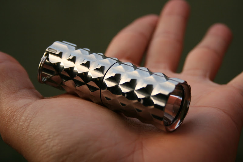

OK, some specs:
Body: 6AL4V Titanium; 24mm diameter by 72mm long (.95" x 2.82"). Weighs 2.6 ounces with the battery installed.
Driver: single level output set at 750mA, the DG750 from the Shoppe
Lens: Double-sided anti-reflection coated 1.5mm thick Sapphire lens
Reflector: IMS smooth 20mm
Battery: Rechargeable AW RCR123
Light Engine: made from 7075AL; easy to install and remove with tweezers.
Foam ring to prevent battery rattle when off
Operation: Twisty--only takes about 1/4 turn to operate
Body will have O-rings installed for moderate waterproofness.
Body has been milled to accept up to five Trit vials for user installation
Split ring hole with recess will allow for tail standing operation.
Bodies have been hand polished; while the bare Ti have been polished to remove almost all machining marks. The DLC coated version will have some machining marks visible, but only under magnification.

Looking good! Looking forward to seeing pics of the whole light, as well as some specs (CR123?, primaries? recahrgeables? Drive levels? UI?)
Thanks for sharing!
thanks. I imaigne it will look rather similar.
Still wondering about specs though...cuz that's what I do.
:eek:oo: That's purrrrrdy. Beautiful renderings too, Fred. They better not come with chocolate - that'll be the dealbreaker! :laughing:
:thumbsup: john
