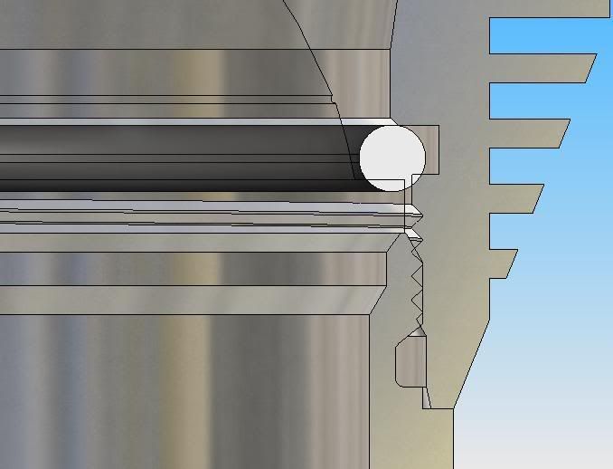

1dash1: Primarily the difference between the KD and the Melles Griot lenses is the edge and base diameter. The KD has a very pronounced shoulder or flange on it and a smaller base diameter , base diameter meaning where the curvature of the lens intersects with the flange, making it compatible with a face seal o-ring groove found on the stock Mag bezel.
The MG on the other hand has a very small shoulder and larger base O.D. so two things needed to change with the MG design. I made a larger bezel through bore and a side mounting o-ring groove in order to properly capture the lens making it necessary for two different designs. The MG style bezel will also use a thicker cross sectional o-ring with a different diameter size.
I did another quick measurement of the KD lens and compared it to the opening on the MG style bezel to test out your fit question. I found that you might be able to use your KD lens and have it work well enough to stay captured by the bezel and o-ring, but it will probably be very sloppy. Using a larger o-ring is more than likely a non-starter unless you find a metric o-ring to fit the bill. Unless you plan on buying a Melles Griot aspherical in addition to your KD lens I'm not so sure I would take the chance as I can't guaranty your satisfaction. Provided I remeber to, I will attempt this fit test once the bezels are being made.

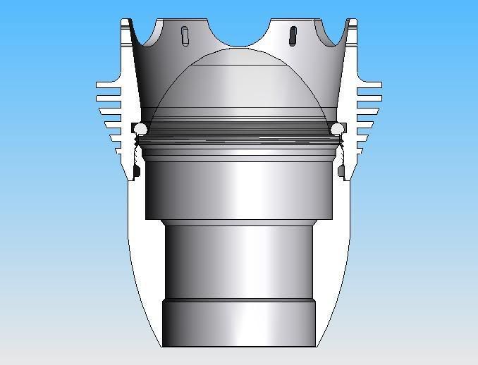

1dash1: I took a closer look at your KD lens compatibility issue and if a thicker o-ring with the right durometer is used it looks promising. As you can see here in the models a thicker seal appears to help significantly. I placed an order today for the the thicker o-rings in a few different durometers so once the first few bezels are made I can do some test fitting.

Lux: Got you locked! Glad you are okay with the pricing. I am actively investigating the possibility of making the MG style bezel compatible with a KD lens just by using a thicker, softer o-ring. As you can see in the models above it looks doable. Thanks for leaning on the side of caution with the MG 01 LAG 010 lens. Since I don't own one I can't be absolutely sure it will fit properly. Can anyone confirm the 010 has the same base dimension as the 123?

tx101: You have been removed from MG 010 lens and I still have you down for (2) M.G.A.C.F.S. bezels in polished 303 S.S.; is this correct? Please keep in mind that I am only making the MG style bezels for this initial run. If you intend to use one of these bezels with a KD lens I cannot guaranty how well it will fit until I have one of the bezels made and I can conduct fit testing. The last models I posted showed that a KD may fit okay with the right o-ring.
