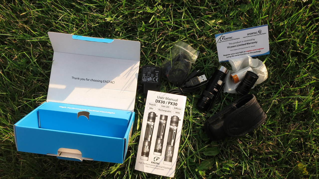

The package contains:
- a flashlight
- instruction manual (it is not worth reading, I have not received the exact instructions for this model), warranty card
- USB cable

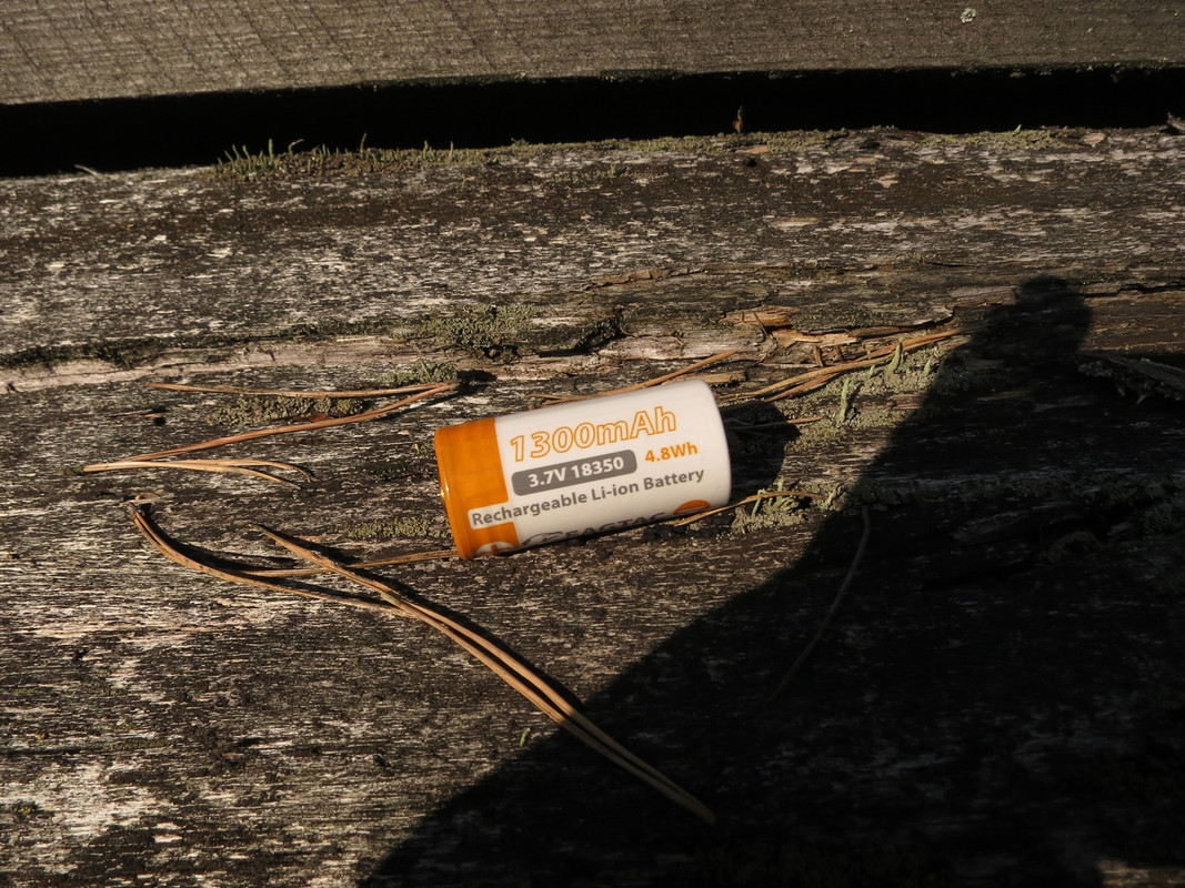

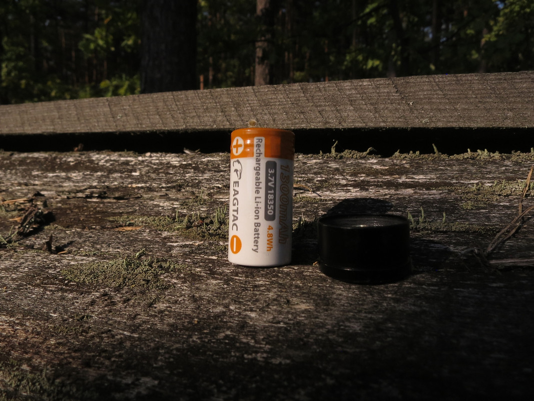

- cell 18350 1300mAh (high capacity)
- cap on cell 18650 (only in PRO version)

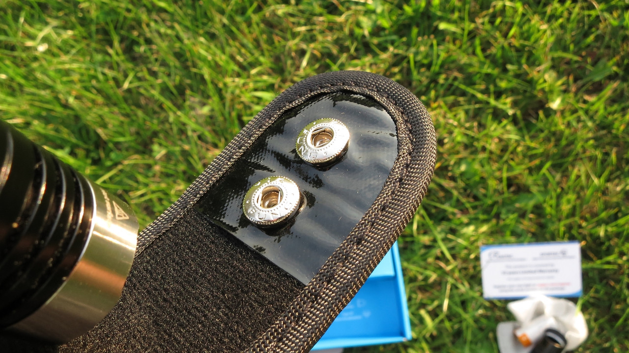

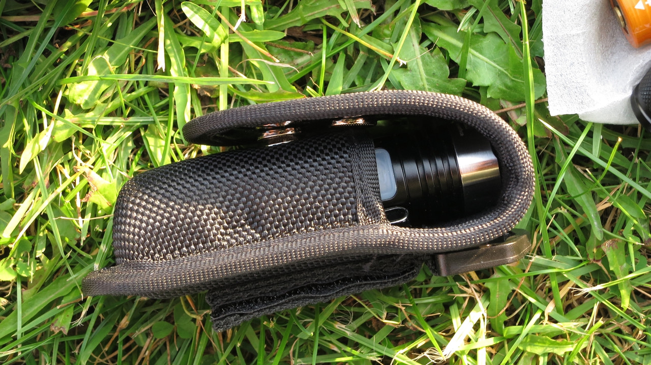

- a well-made hard holster
- leash on the wrist
- spare oring
- 5V / 1A charger

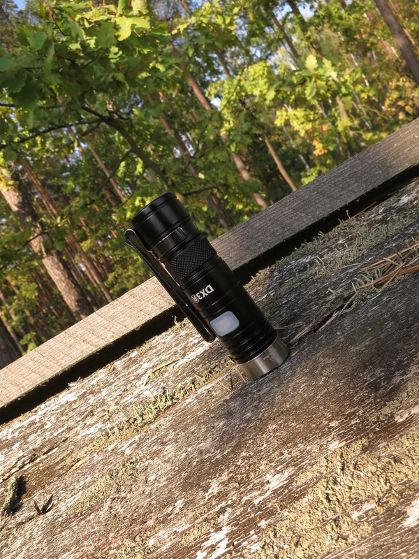

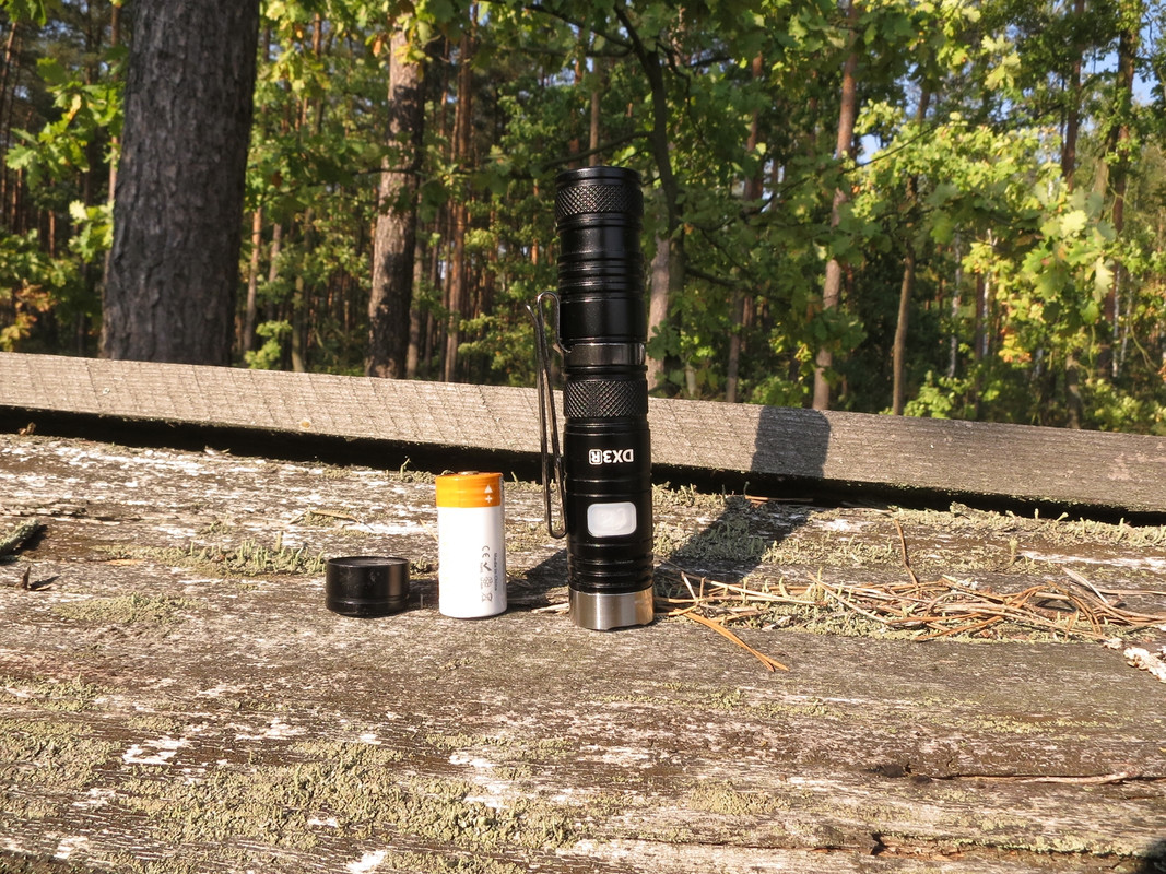

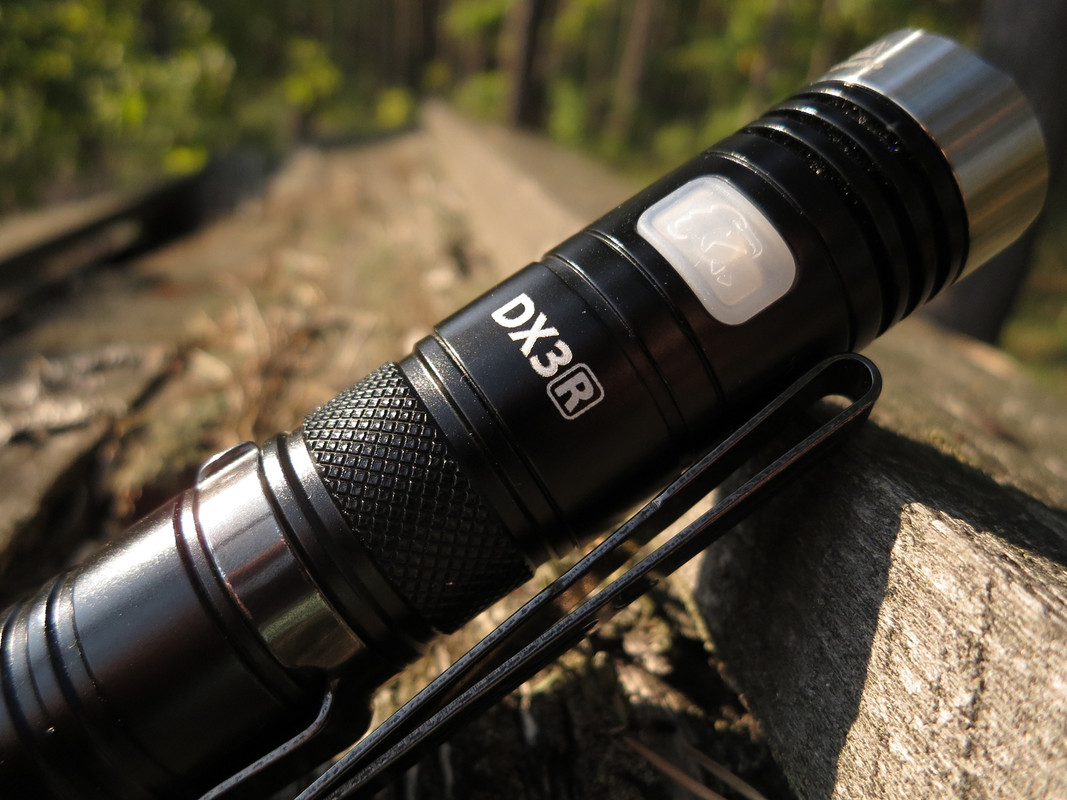

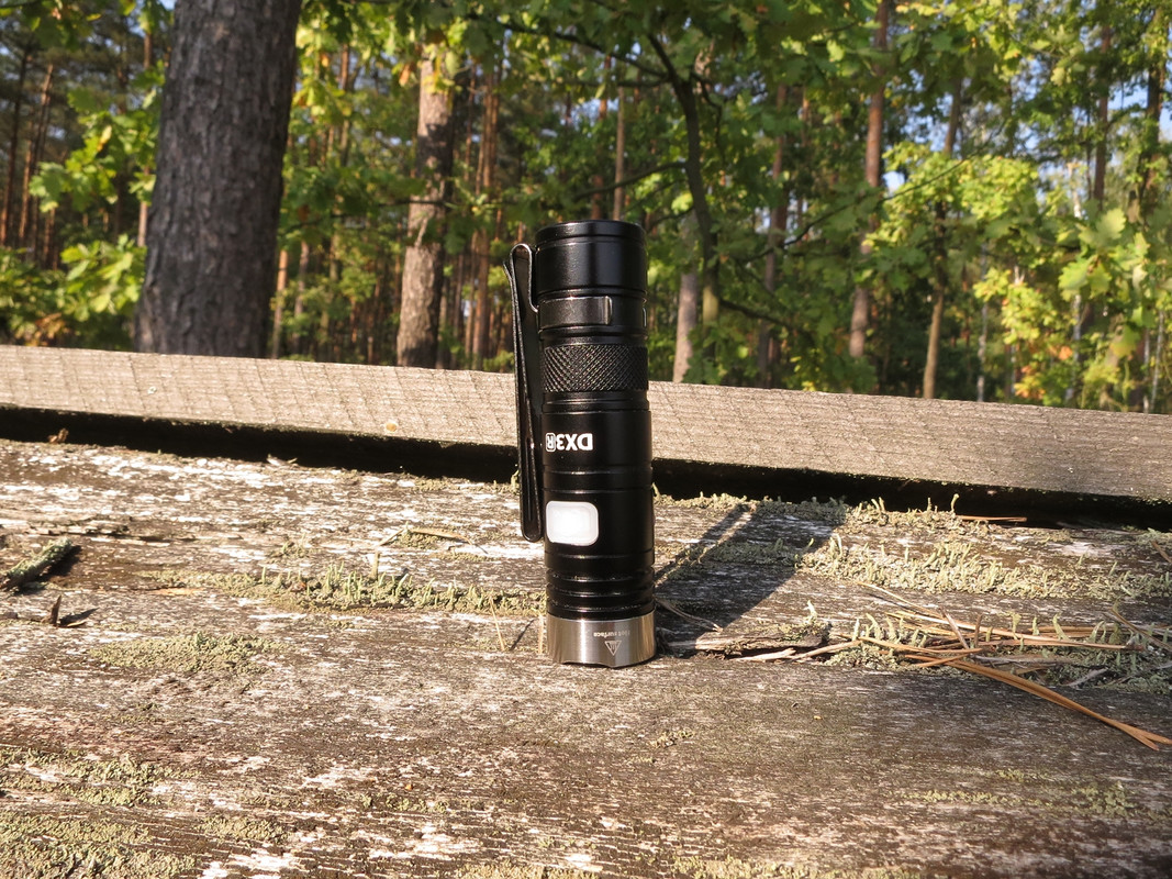

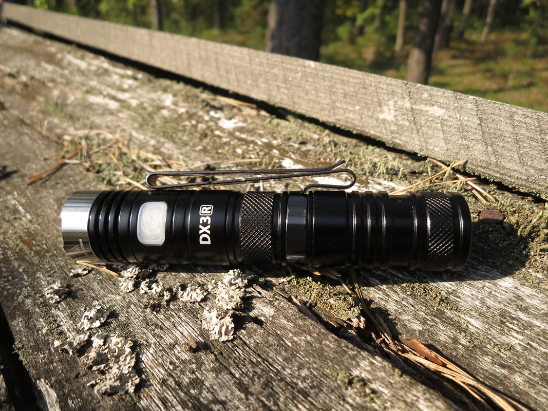

DX3B Mini Pro powered by 18650 cells measures 11.3cm and diameter of about 2.2-2.3cm
The diode in my case to XHP50.2 in the neutral version, it is a pity that the manufacturer used a colder diode than in the example TX3G Pro, which I tested. I have no objections to the cleanliness or quality of the location of the diode in the headlamp.

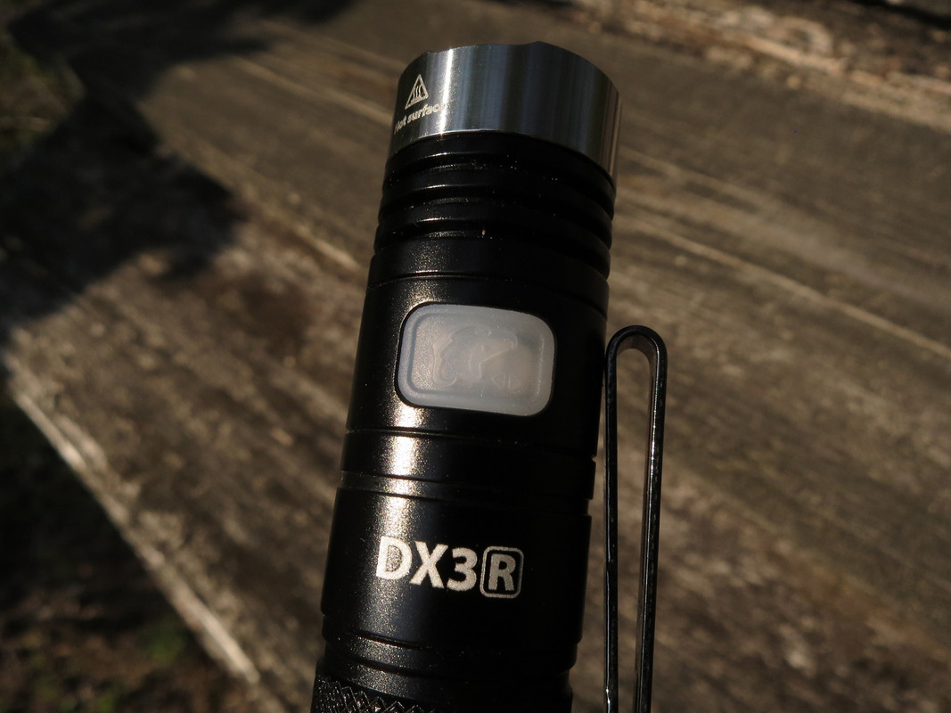

Testing more than a year ago PX30LC2-R (I have it until today) I was worried about the durability of the rubber, which protects the button. A year has passed and nothing bad is happening with the rubber band. Has something changed compared to PX30LC2-R? the accuracy of the button has changed, now the button element is closer to the eraser, which allows a better sense of its operation.
The sound has also changed slightly, the button in EAGTAC is not the quietest, but it does not bother and works as it should.

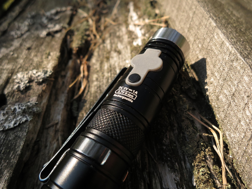

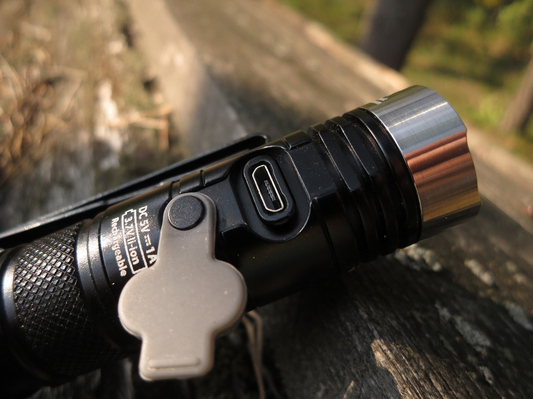

On the "opposite" side, the manufacturer has placed a USB port and information on the maximum charging current. Unfortunately, we will not find USB type C, known from other models, unfortunately, the USB security protector protrudes.
DX3B has passed the water immersion test without any problems, probably it is not a water-resistant USB port without a rubber band, which is a pity, because the whole is very nicely done

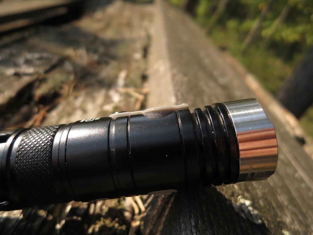

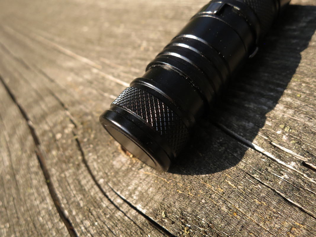

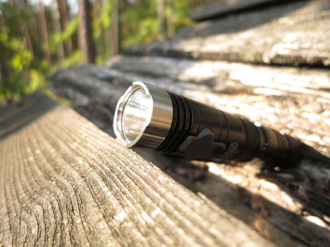

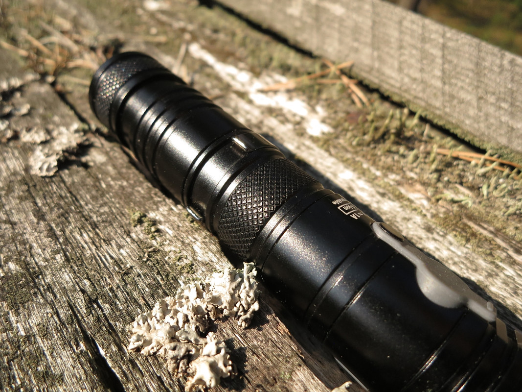

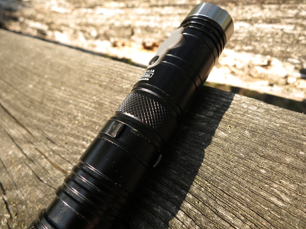

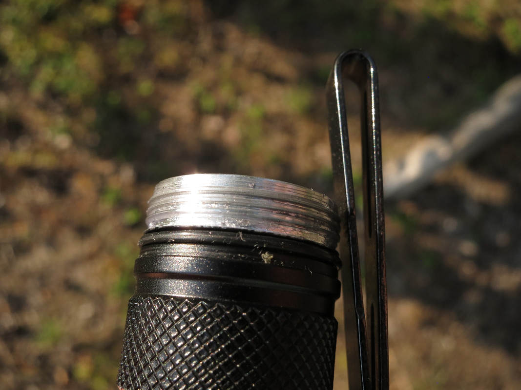

The middle tube is covered with a very small and poorly perceptible knurling, the clip itself is more perceptible, large, soft and comfortable. It is possible to remove the clip, but it involves losing the space to assemble the leash on the wrist ... that's the only thing that stops me ☹
We have the choice of using one of two caps
- on cells 18650
- on the 18350 cells, the cap has a built-in magnet - in the short version it looks even more charmingly 😊

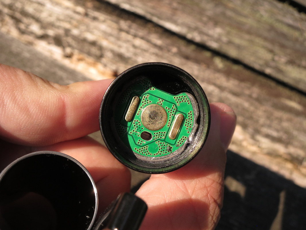

I do not know why EAGTAC does not use gilded springs, maybe it's a special stop?
Threads on both sides duly made and lubricated (thread at the head is not glued)
In my opinion, the DX3B looks bizarrely from the tube on the 18650 cell, it looks much more interesting from the tube at 18350, although in my opinion 18650 is the only sensible supply of EDC flashlights (yes, that's my opinion)

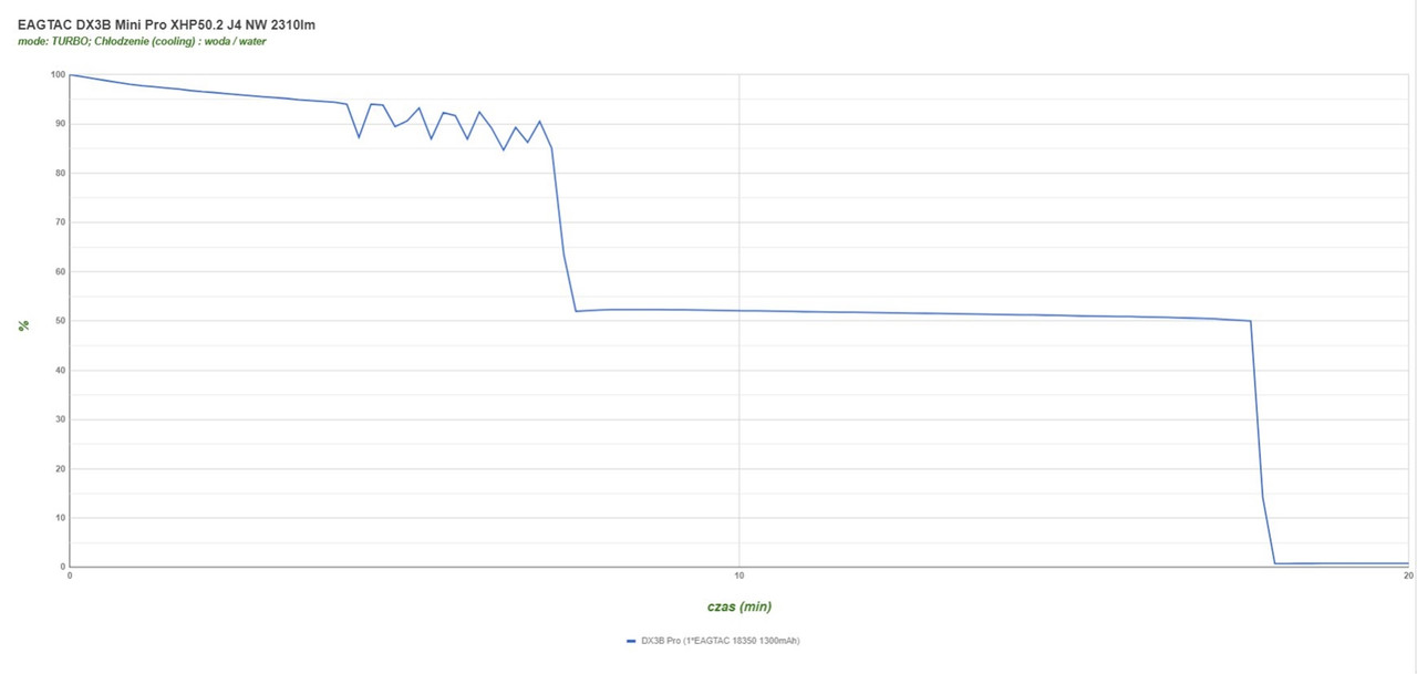

It is worth mentioning the protection against too high temperature, the flashlight without cooling after about 30 seconds will reduce the brightness, but this is not the protection known from flashlights, eg Fenix or Lumintop, Eagtac can warm up to nearly 80 ° C).

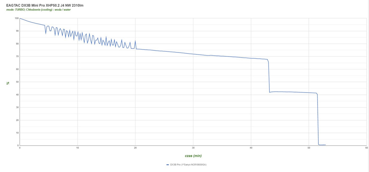

Supplying the flashlight with links 18350 TURBO works for about 8 minutes, then a sharp drop to about 50% and before 20 minutes ends "current".

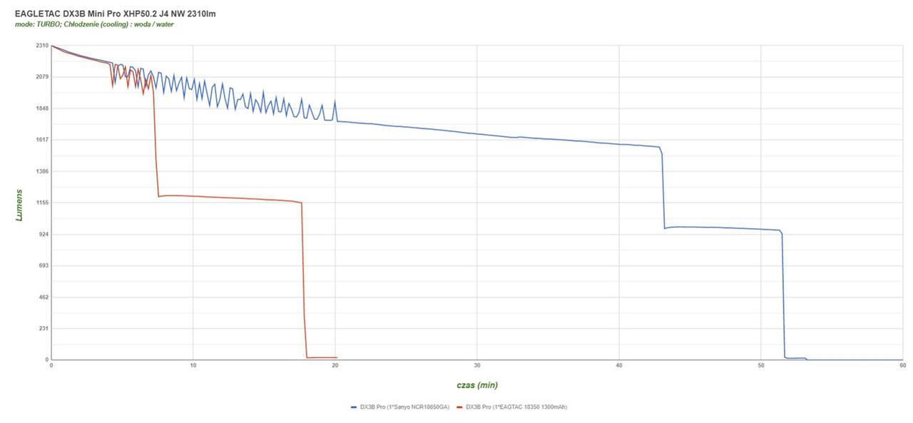

The graph looks much better when we use 18650 cells, the brightness decreases slowly from 100% to 70% for about 40 minutes. For diode XHP50.2, the manufacturer gives 2310lm, so even after dropping to 70% it is over 1500lm.
Only here you can see the huge advantage of 18650 cells over 18350

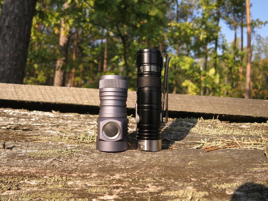

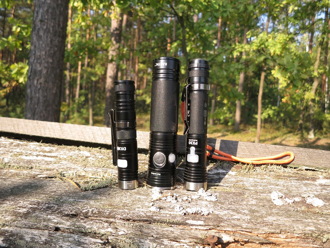

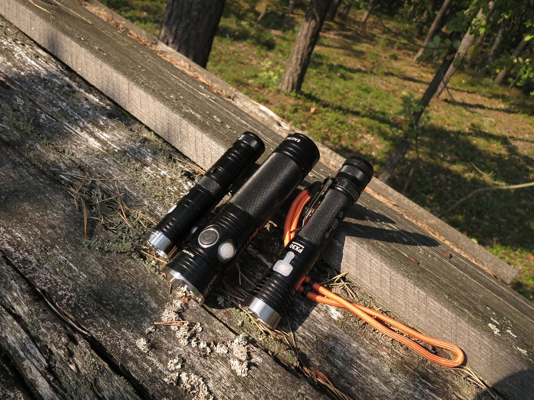

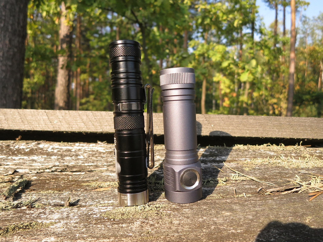

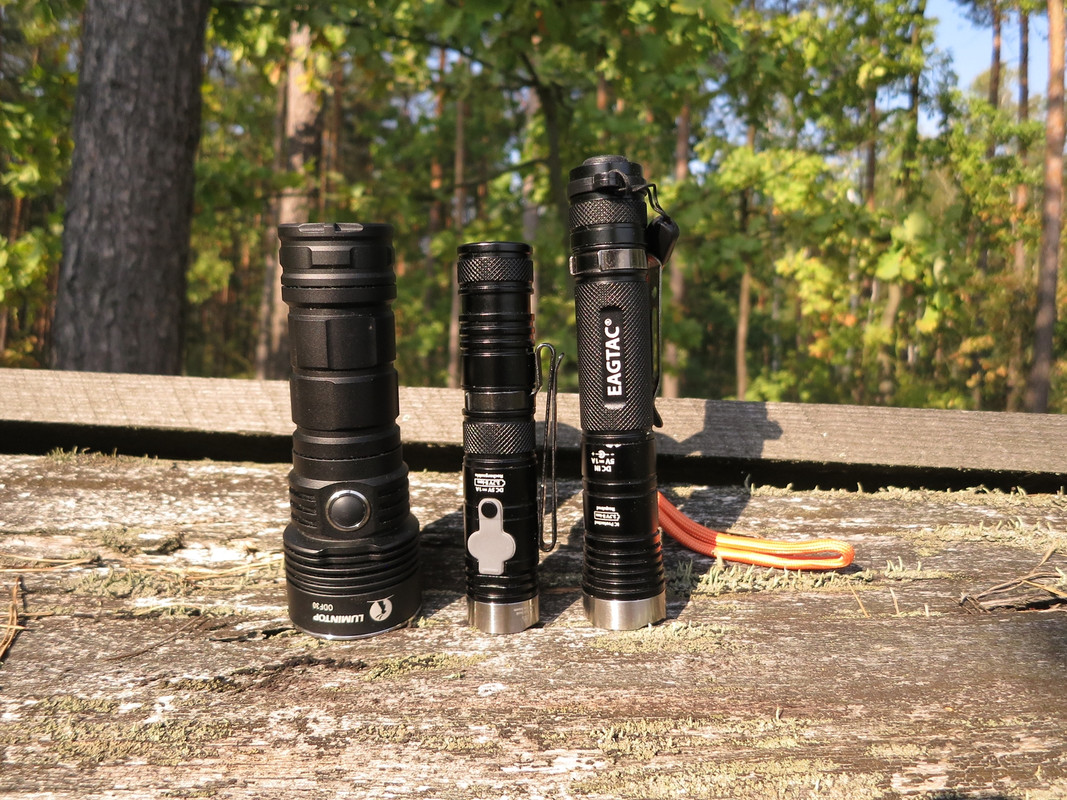

DX3B among great brothers, namely TX3G and PX30LC2-R
And here, behind the TX3G, Lumintop ODF30 jumped
DX3G Pro in Mini version or with a tube on 18350
And some photos from Emisar D4

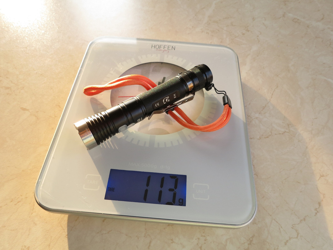

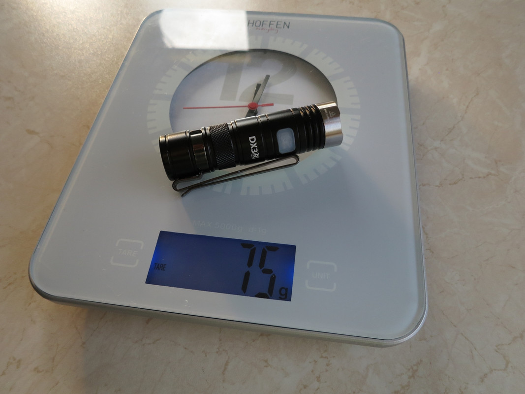

Several pictures from weighing, flashlights in each picture are equipped with links.
Differences between DX3B, PX30LC2-R and Emisar D4 are below 10 grams, a great result

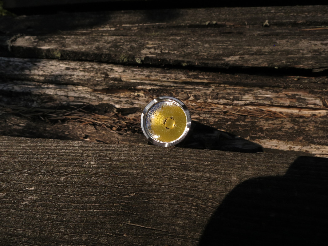

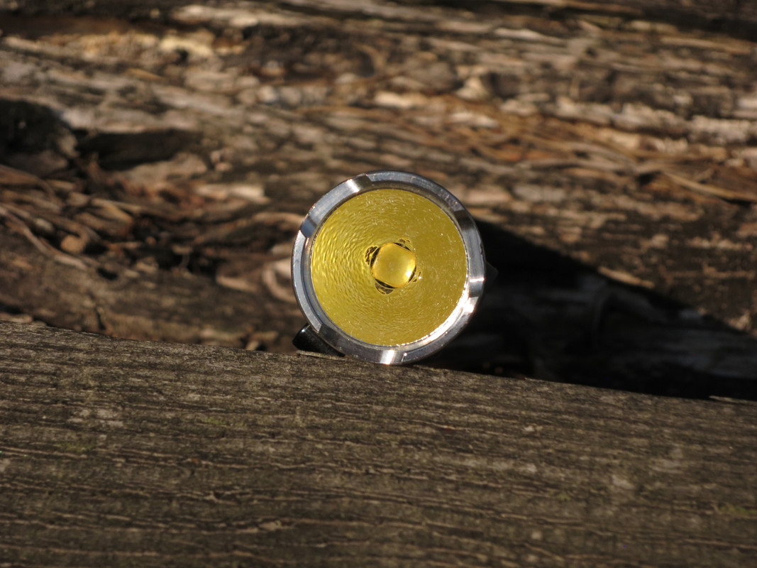

XHP50.2 diode, although it shines nicely, and even very nicely bearing in mind other flashlights with XHPxx.2 diodes, nevertheless, on the white paper you can see a slight green color coating.
A card with a card, it shines on the outside
For comparison, the warmer TX3G with diode XHP70.2 neutral

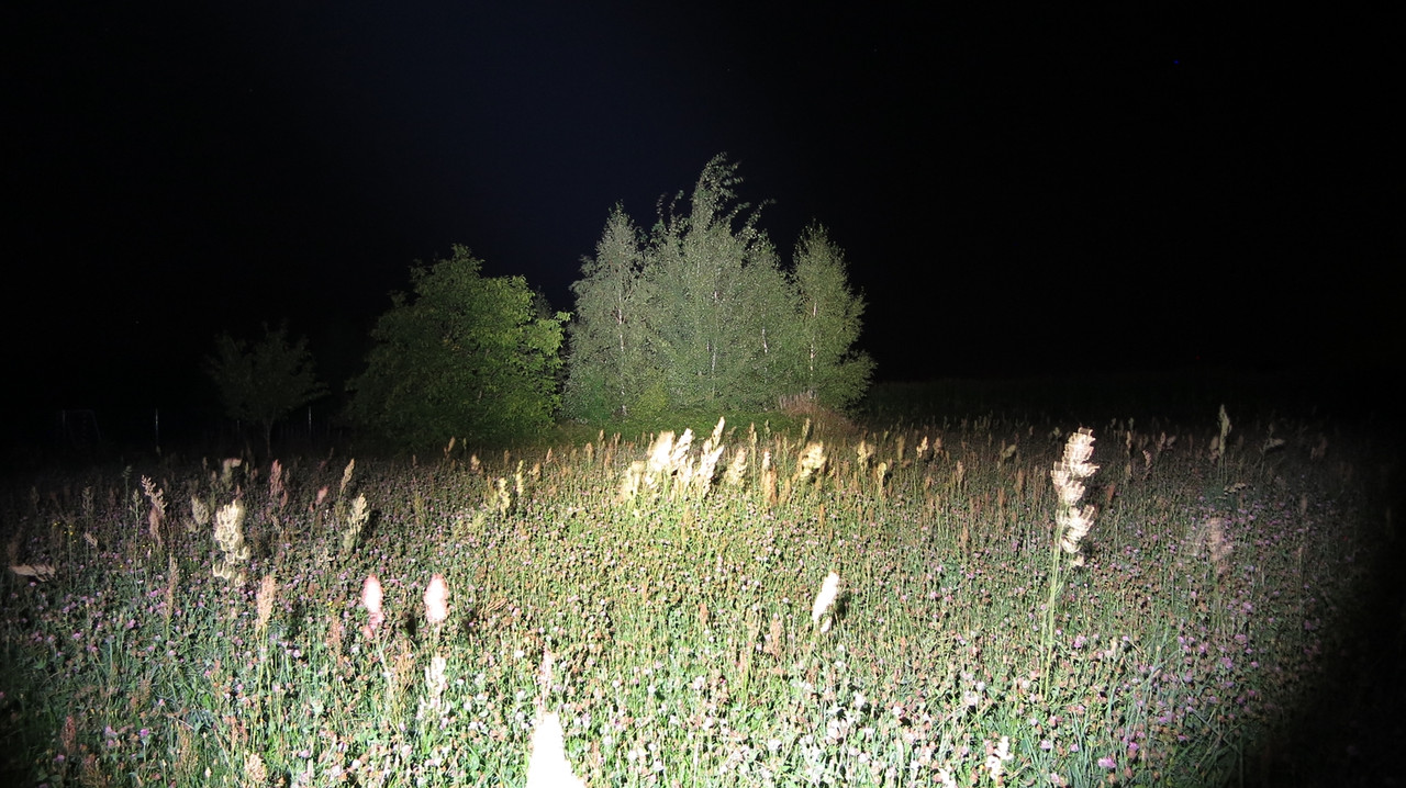

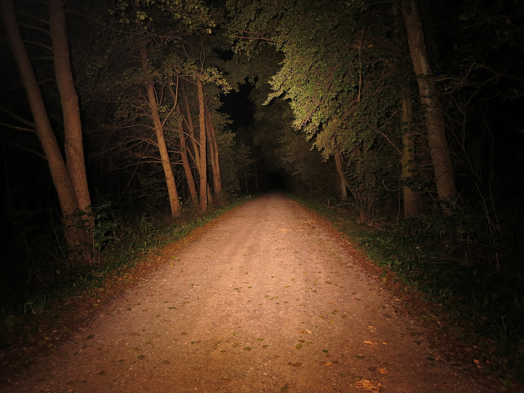

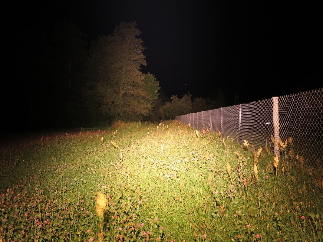

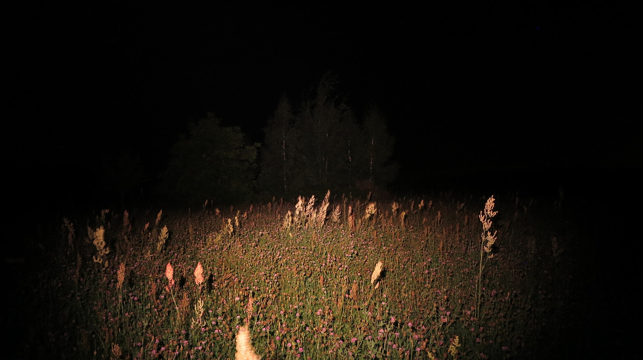

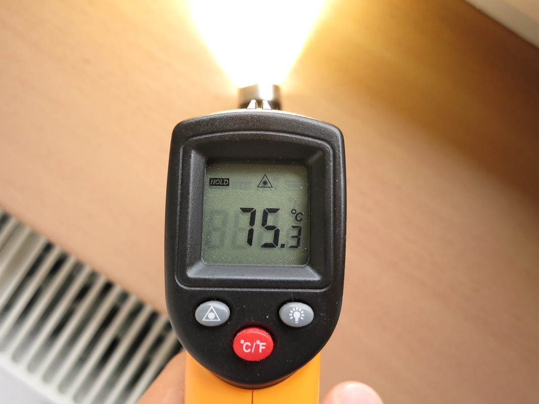

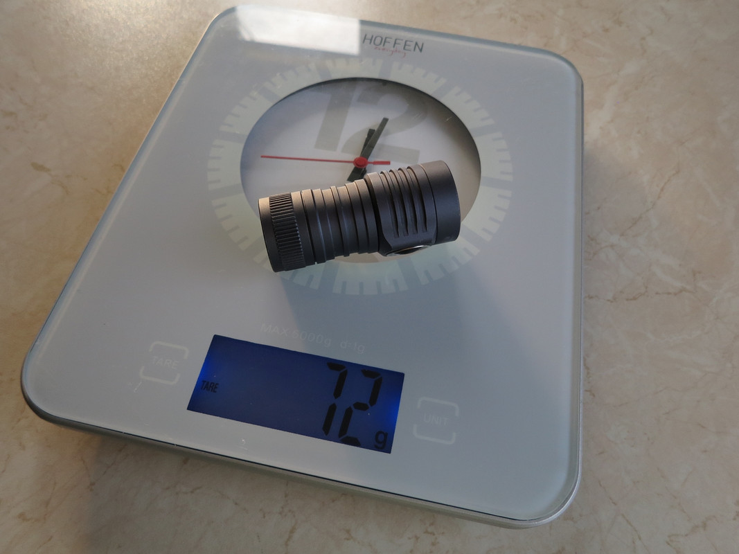

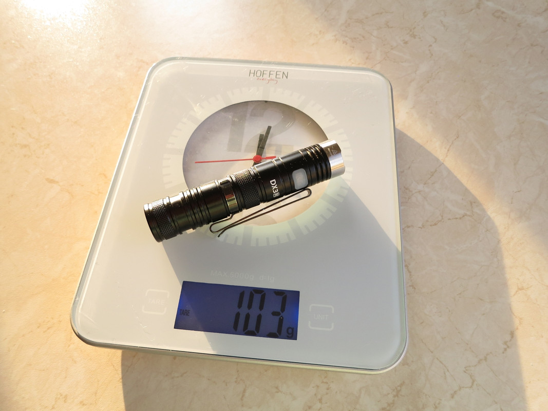

Field shots, camera settings ISO-200, f / 2, 1s, white balance - Fluorescent H
DX3G Mini Pro - TURBO
TX3B Pro - TURBO
Emisar D4 - TURBO
Rofis MR50 - TURBO
DX3B Mini Pro - from low to TURBO
TURBO lit "lower"
TX3B Pro - TURBO, significantly heat up the color
Emisar D4 - medium and TURBO
PX30LC2-R with XP-L Hi neutral - TURBO
Rofis MR50 - TURBO
DX3B Mini Pro - from moon to TURBO
TX3B Pro - TURBO
Emisar D4 - TURBO
Rofis MR50 - TURBO
